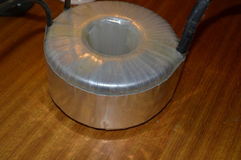

Medical trafos requirements are reliable and safe not good sound. In 2003/4 I used for more than a year two 4.5kg Toroidals made to order transformers to 220V->120V in a CD player, obviously when I removed the trafo and used the CD direct at the wall the SQ improved to my surprise, the trafo leads even were QED Silver Anniv 2,5mm speaker cables.

The transformer I used was only 500 or 600W, when I remove it I started be supplied by the transformer from my condo that was a big 225KVA trafo, so I was no more power limited to a small 500W trafo.
Use an external transformer is limiting the power to your audio equipment.
