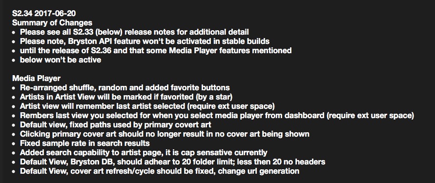

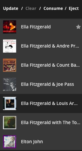

Also, I noticed that after upgrading last night, there is suddenly a 'star' shape where the play, pause, forward symbols are. Do you know what that does?
Click the star on a song playing, and the artist will be 'Starred' in the Artist column in Artist view.

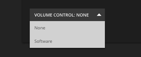

Settings/Audio Devices offers a volume control setting:
Never used that up to now, mine is Off, but wouldn't that be of use in the Gain question?

Regarding the star, I figured why it wasn't working for me. I have the DB disabled for now.
About the volume, I did play around with that 2-3 times and it killed SQ quite fast. I don't know if that's the same way the Replay Gain works?
