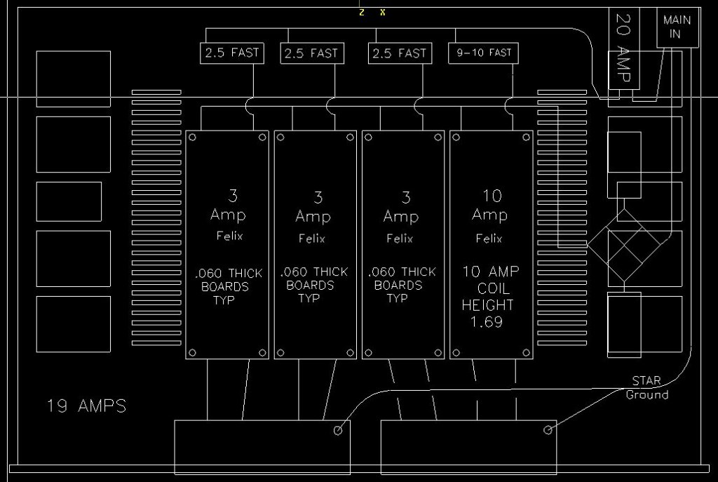

Connect each shield and Safety Ground to the chassis near where the cord enters the chassis. Then use an internal wire to tie the Safety Grounds together.
Actually each Safety Ground wire needs to be bonded to the chassis. bonded = a secure, permanent connection.
WireNut
Re: Felix conditioners and DC blockers.
« Reply #22 on: 1 Jul 2017, 10:31 pm »
Got it.
Thanks Speedskater.
Will do.  :thumb:

Lastest revision.
4 Felix, 19 amps, in an old Adcom 535 chassis.
Saving for the additional parts.
