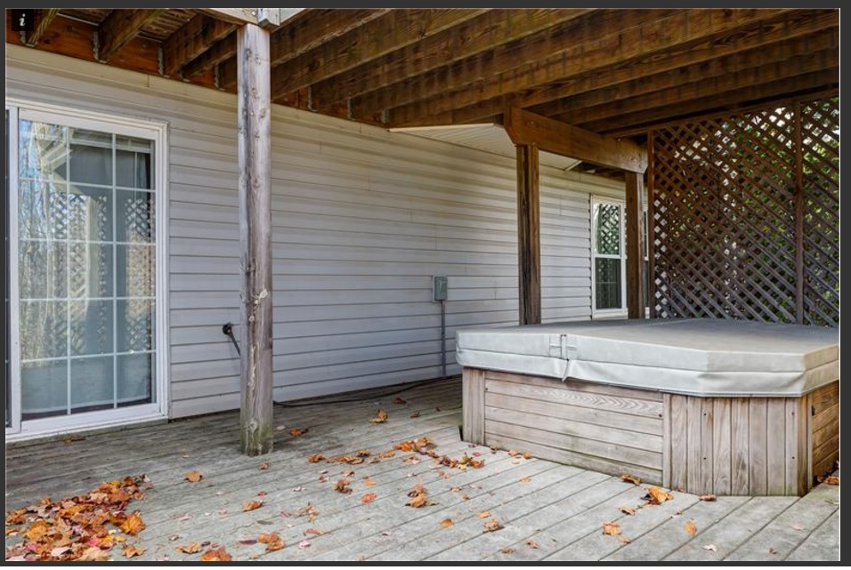

In 1997 I purchased a hot tub. I built a deck on the back of the house that was located to take advantage of an outside door in our master bedroom, used to be the back door of the house when it was built circa 1903.
Ran water and electric to the deck. The hot tub was placed directly on the deck not recessed. Deck was built to support the tub, Joists on 12 inch centers and doubled up below area of the tub.
This worked very well. Deck had  4 ft. privacy fence so we could enjoy it without the neighbors seeing what was going on! All was well until the hot tub heater failed and caught fire.
Damage was limited to the hot tub itself. Turns out the GFCI failed. So make sure that yours is protected properly. Make sure that you have easy access for maintenance of the tub. Pay attention to it all of the time it is operating.. Things happen..
We now enjoy using the deck during the warmer months sans the hot tub. My wife and I enjoy a cup of coffee and reading early mornings. We are located in southern Michigan and have had some great times there.. Have not replaced the hot tub. Per the wife's decision.... I do miss it.. With all of the injuries over the years it was helpful. Maybe I need one in my listening room! How well do tubes play with high humidity?
