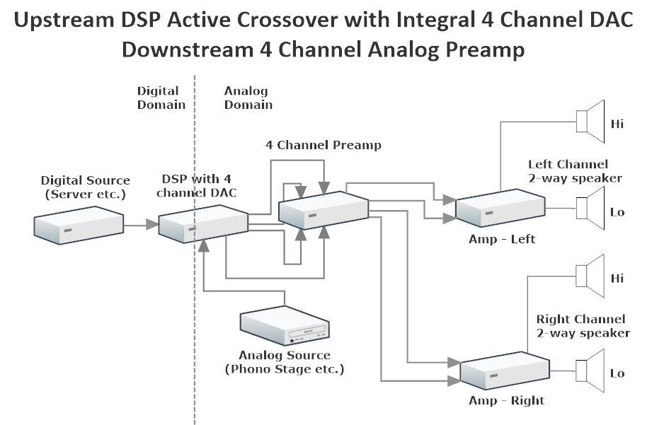

Being a big fan of active crossovers using DSP (digital signal processing) I'm seriously considering offering a 4-channel derivative of our LDR preamps for active DSP applications involving 2 way speakers. Could be expanded to accommodate 3 or even 4 ways as well.
Very interested in getting comments on this.
Also, here's a recent article we posted on the subject of Active DSP Crossovers. http://www.tortugaaudio.com/articles/case-active-dsp-crossovers/

Hi Morten, interesting idea  :thumb: In your diagram though, the analog source needs to be connected further upstream (via an ADC).
tortugaranger
  • Posts: 1780
    • Tortuga Audio
Re: 4 Channel LDR Preamp for Active DSP Crossover (Bi-amping)
« Reply #2 on: 21 May 2017, 06:29 pm »
Good catch John. Have corrected and updated.  :duh:
