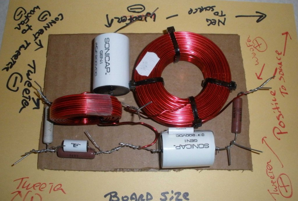

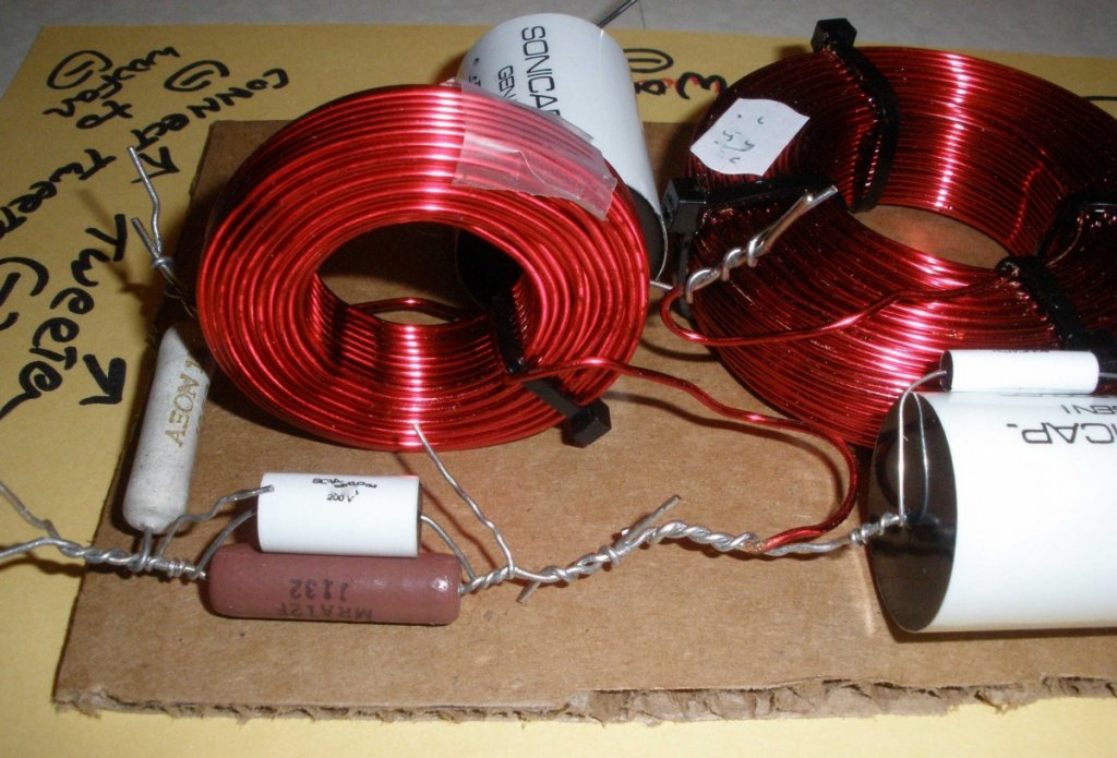

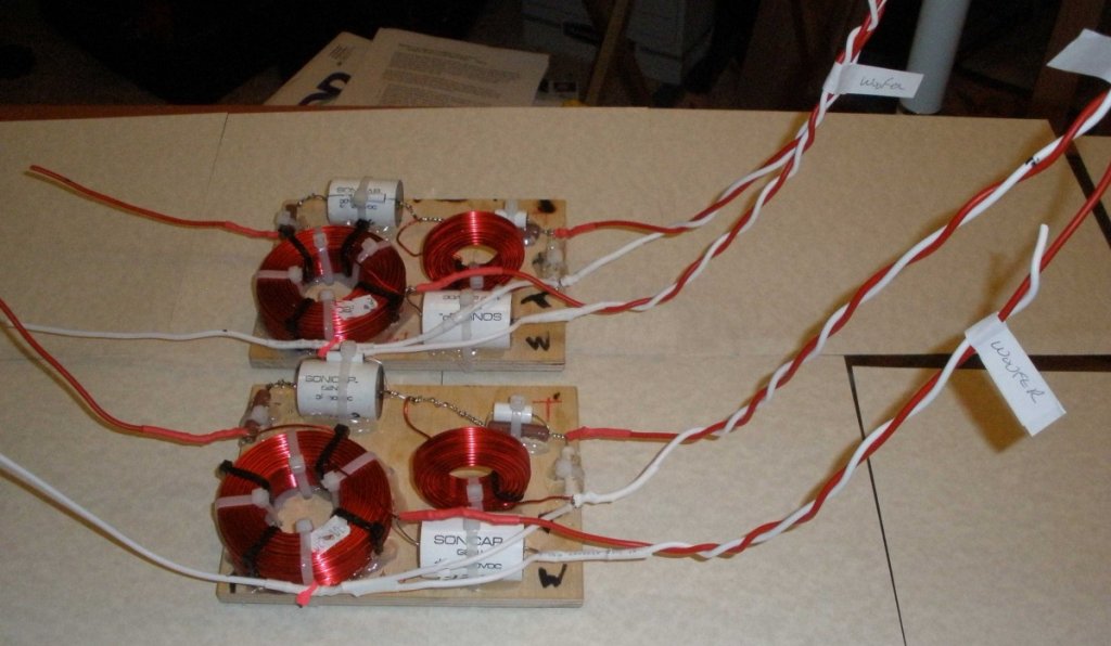

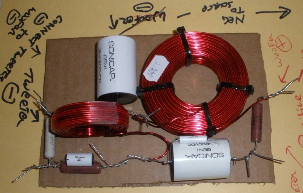

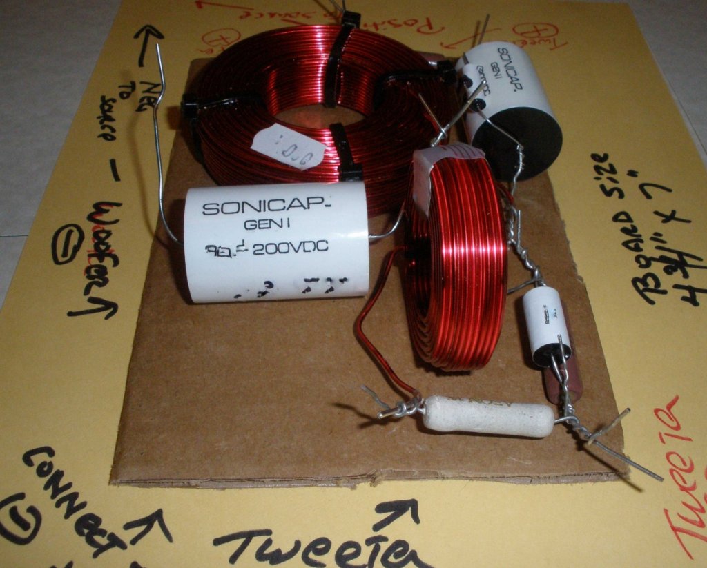

Peter your work is amazing and inspirational. I am wondering if I have missed it but I am looking for some images of the crossover layout and wiring? I have the kit and the schematic, but for this noob, that is not very helpful. I watched Danny's video on crossover builds, particularly the one where he built the Klipsch RP600 M ones from scratch.
But the X-LS Encore schematic is very different. Not only more parts but very different circuits, I think. I got no clue on the wiring for it. My kit is pretty lean on instructions. Is there a resource or thread I have not seen yet that is more tailored to the x-ls Encore crossover assembly and wiring? and While I am begging for your experienced guidance, is there a template to cut the no rez for the box?
Scott
I'm not Peter but here are some pics of how I did mine:
Mike

And there you have it. Far more than I could have provided...thanks Mike.
I've thought about a template for NoRez, it's on my list, but well, it's on my list. FWIW, it doesn't have to be pretty. You do want to press hard when installing for PSA to get a good bond.
