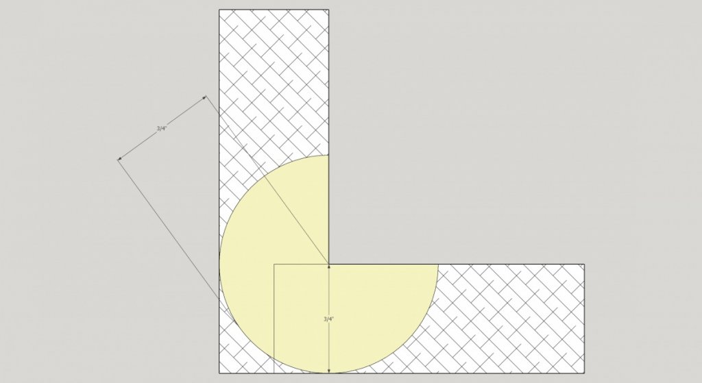

A question was asked on YouTube about cabinet edge radius. Here's a graphic cross section of corner to illustrate how one could cut as large as 3/4" radius and still have full 3/4" thickness at corner thus maintaining cabinet wall thickness and integrity. A minimum of 3/8" is ideal.  For reference the "Hot Rods" in this thread are 3/8", the "Magmas"  1/2". A 3/4" radius cutter is big honkin' thing. Probably best used in router table.

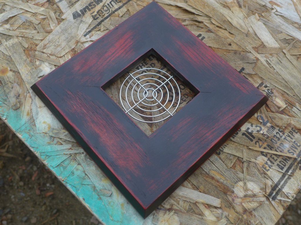

Moving on I'll do an out-of-the-ordinary finishing video. Something like the sample in photo. Ignoring what it is, imagine that what's red in the photo could be some other color. What does you mind's eye see?
Speak up...really! I  can't promise anything,  but would love to entertain ideas.
S Clark

Indigo as the undertone could be striking.
