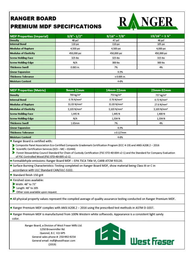

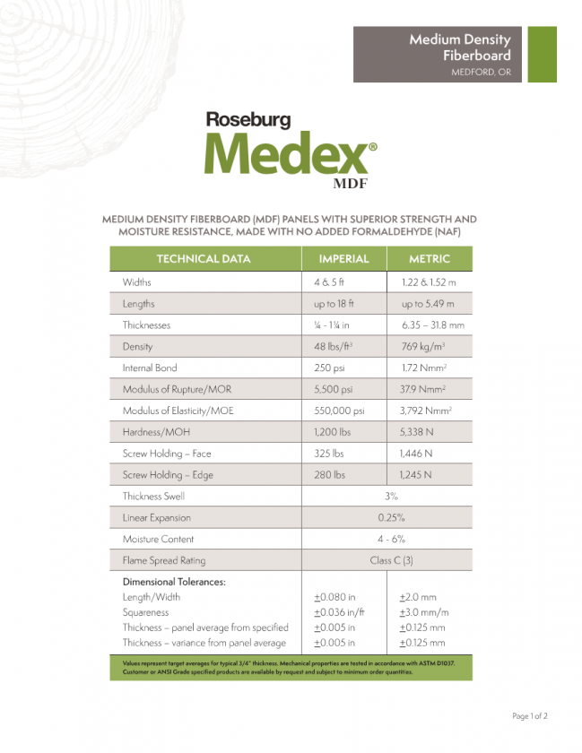

Actually,  if I'm looking at the data sheets correctly,   the Ranger Board is never denser than  the Medex... they are very similar.  I say "neverdenser"  because   the data sheet (if I'm looking  at the correct one)  shows that as thickenss increased, the  Ranger Boards density decreases.. not really sure why that  would be the case but...
For example,   9mm Ranger Baord seems to have a density of 769kg/cubic meter while  while 23mm Ranger Board seems to have a density of 737kg/cubic meter
https://www.westfraser.com/sites/default/files/products/MDF/Ranger%20Premium%20Specs%202019.pdf
Medex   only shows   a single desity which seems to make more sense if press preasure   and material quantity  /cubic meter is consistant.  It shos   the same  769kg/cubic meter as the Ranger Boardhttps://www.roseburg.com/UserFiles/Library/Medex_TDS_052019.pdf
I personally  like the   mosisture  resistance  and stability of the  Medex not to mention it doesn't seem to chip or dent/blemish  nearly as easily as the MDF.

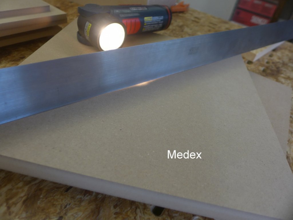

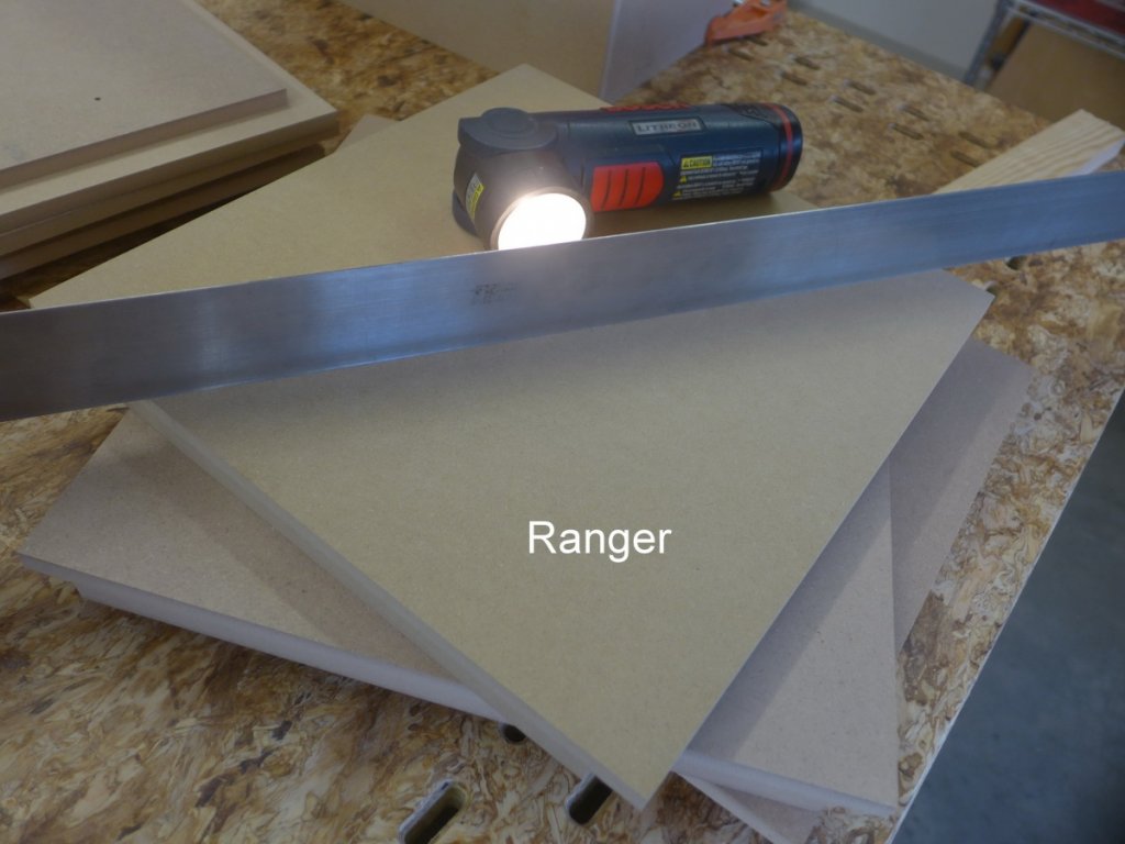

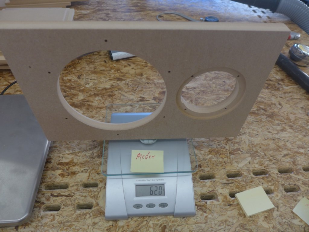

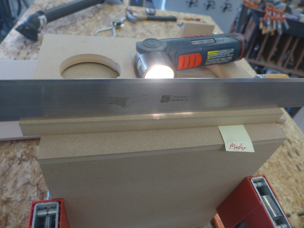

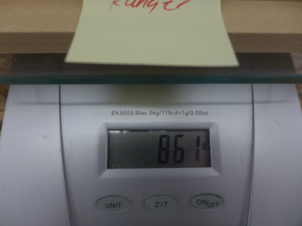

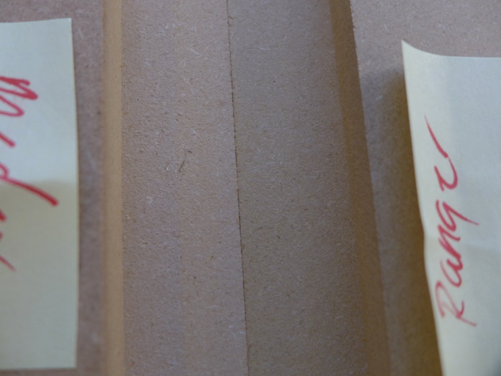

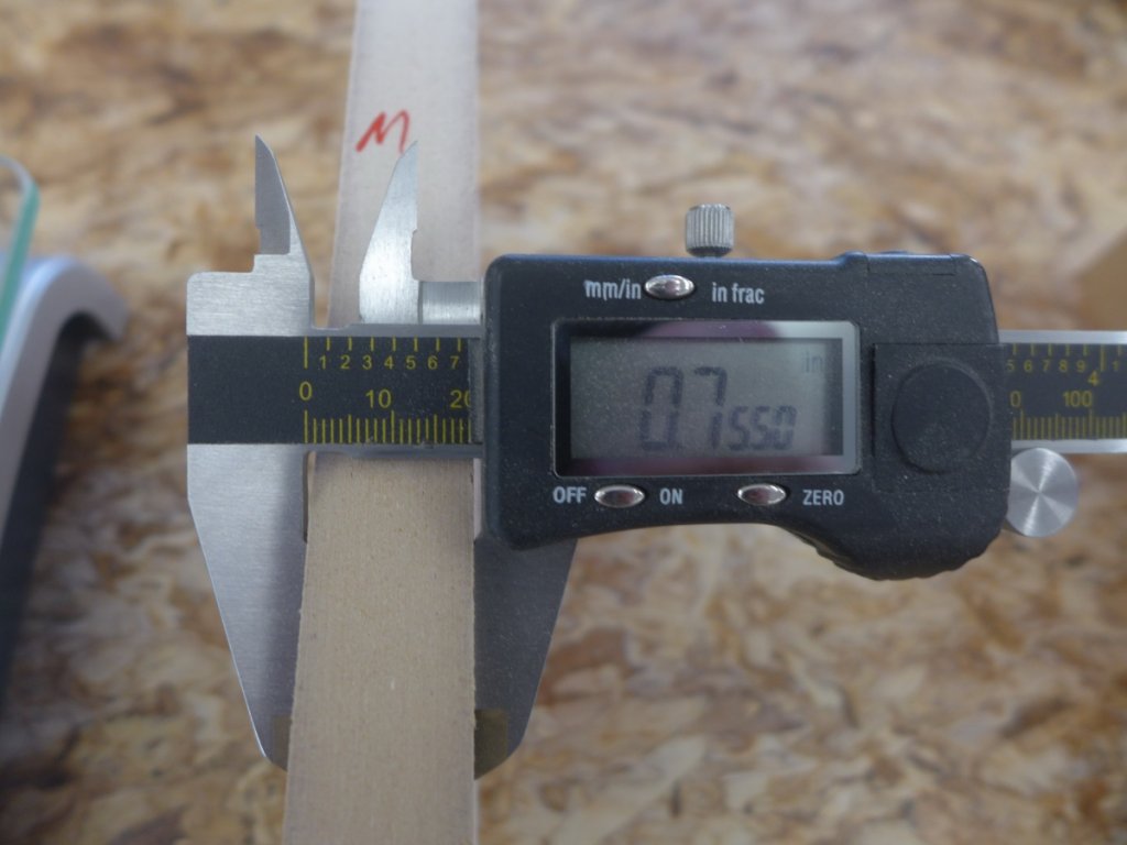

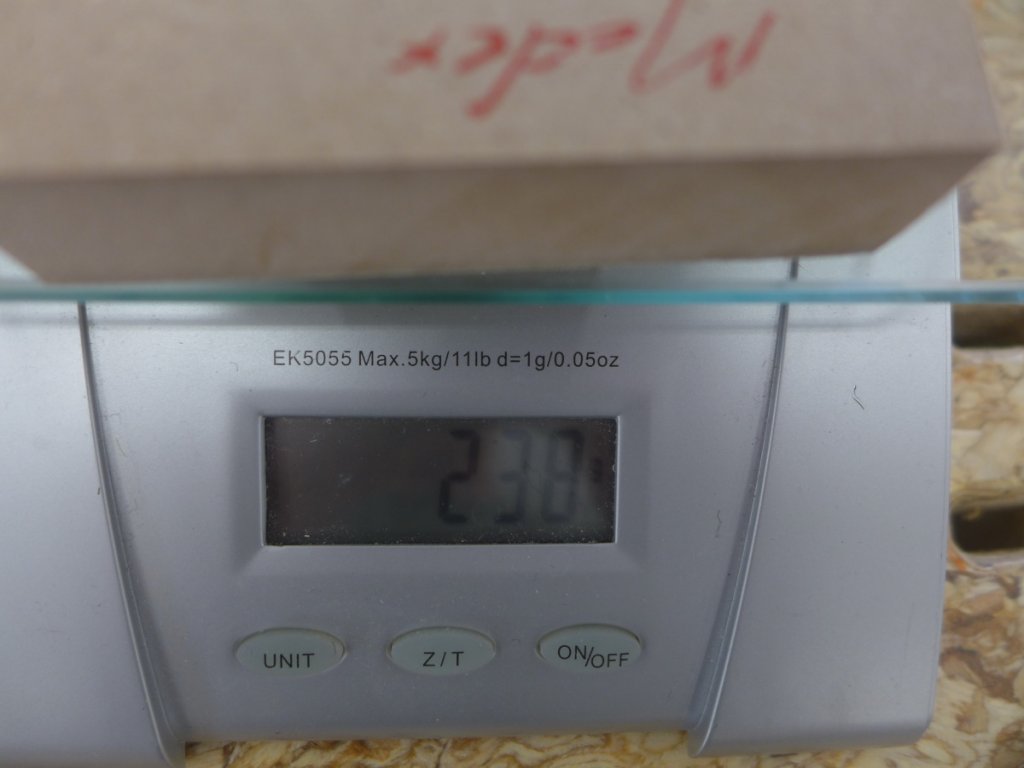

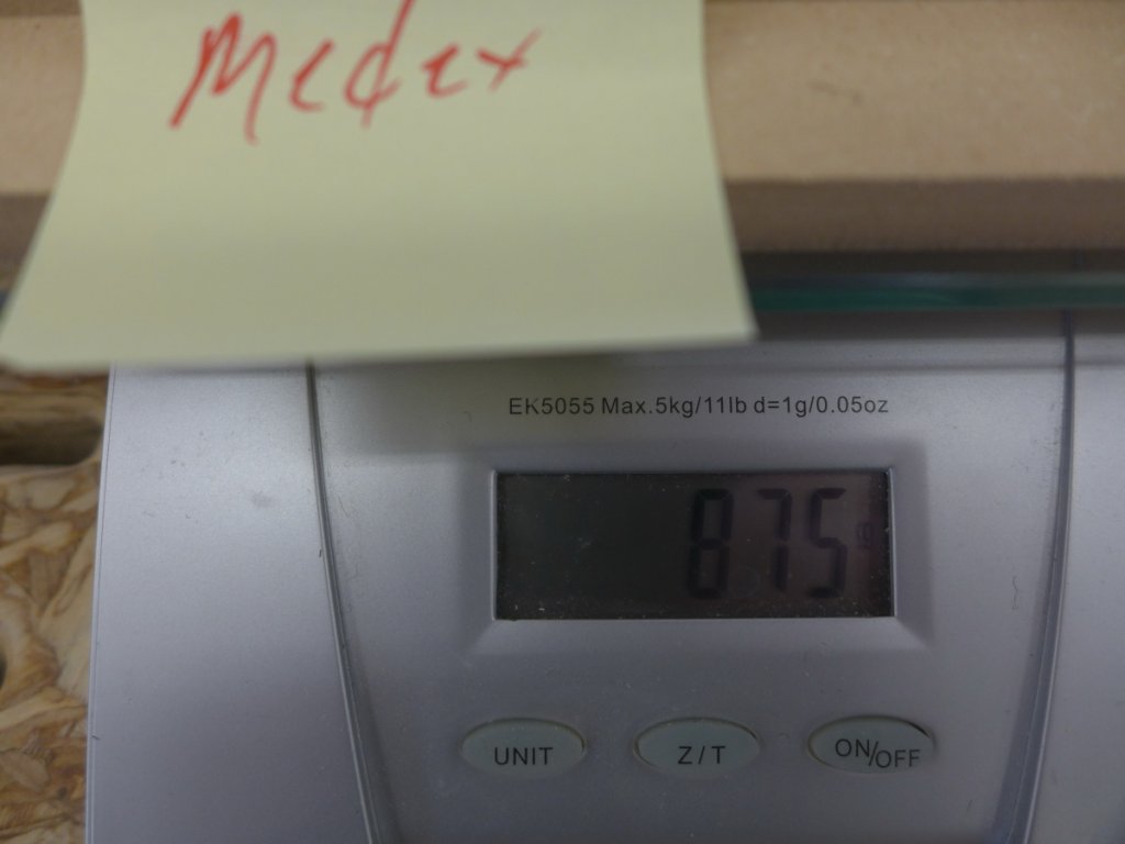

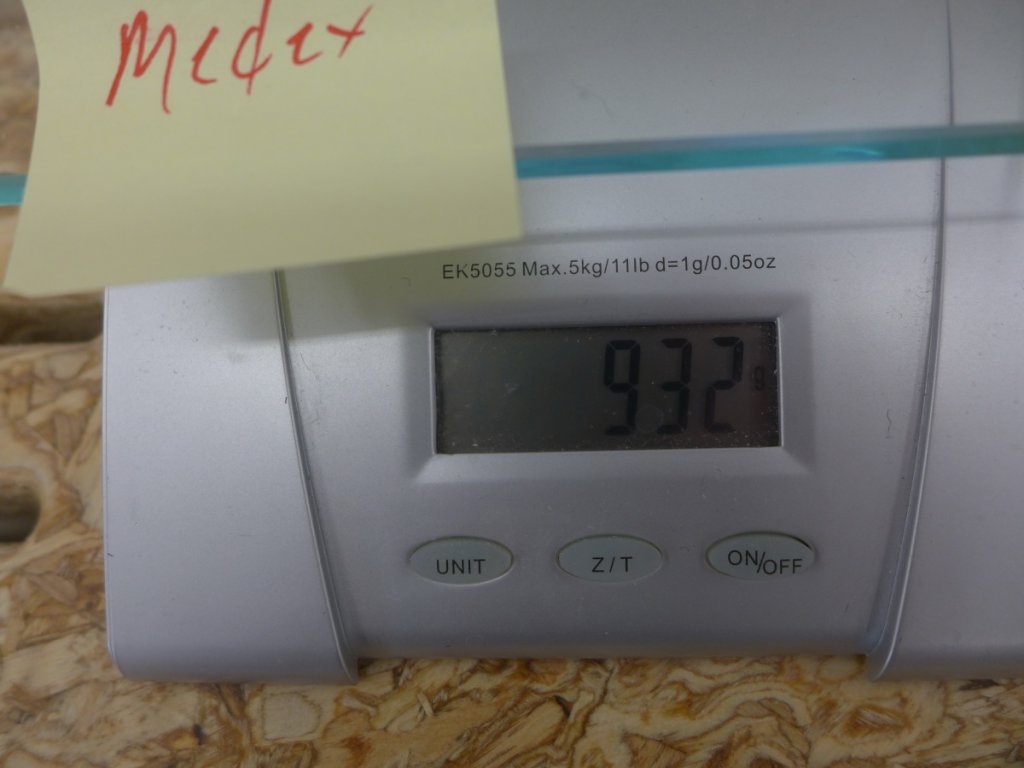

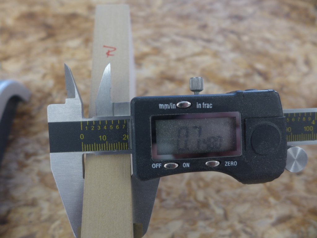

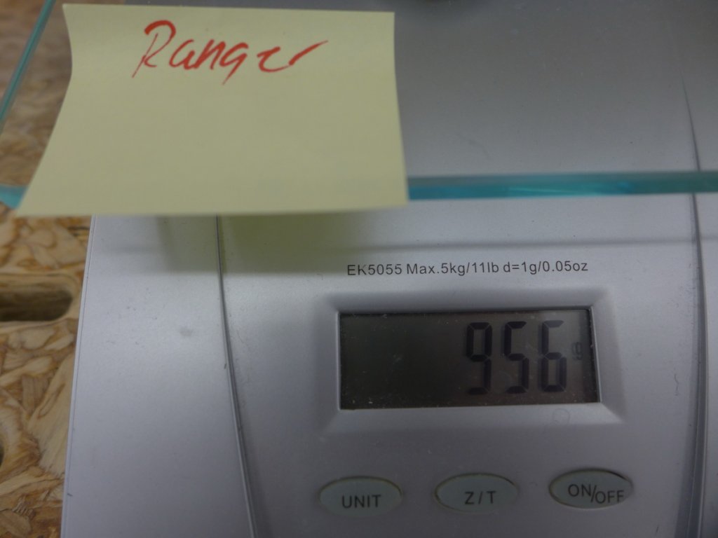

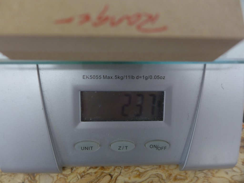

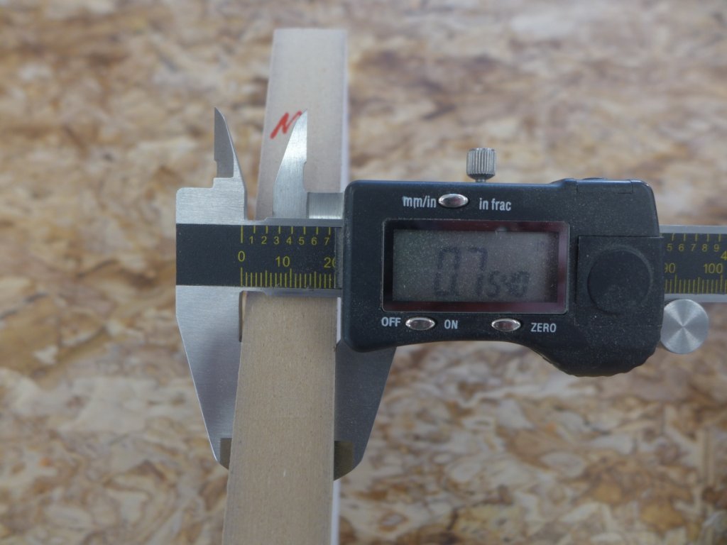

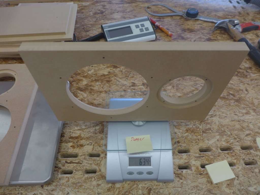

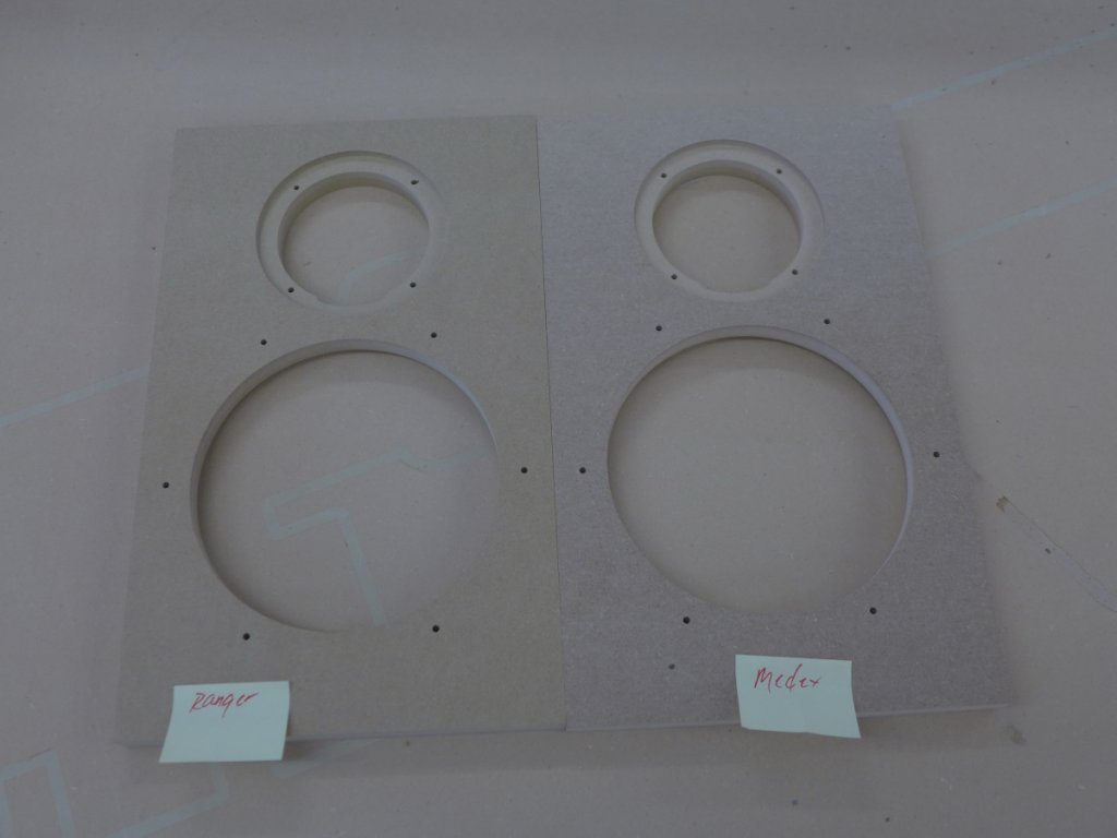

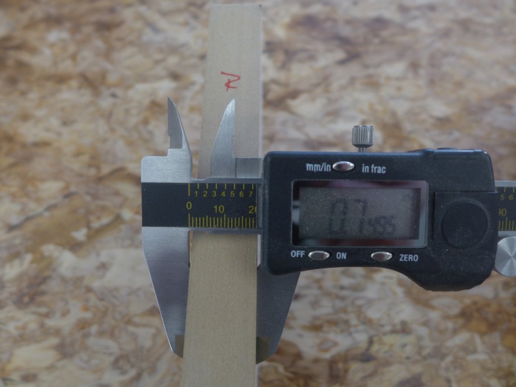

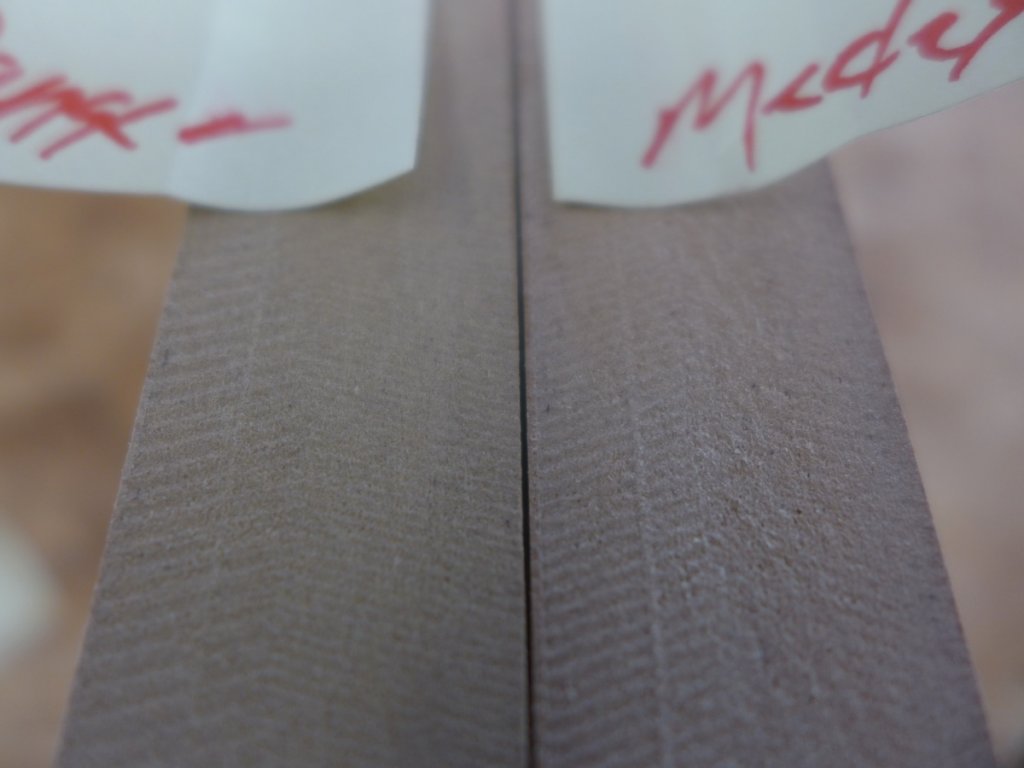

Diving into Minutia, an MDF treatise (of sorts).  Super-Nerd card required.
The following is my pseudo-scientific research into two premium MDF products. Ranger Board and Medex. My methodology is probably questionable and controls somewhat variable. Me and MDF and the tools at my disposal.
Before I start; Yes, I have a life. Yes, it may be hair-splitting. I’m curious to a fault and I indulge it…sue me.
 Observations

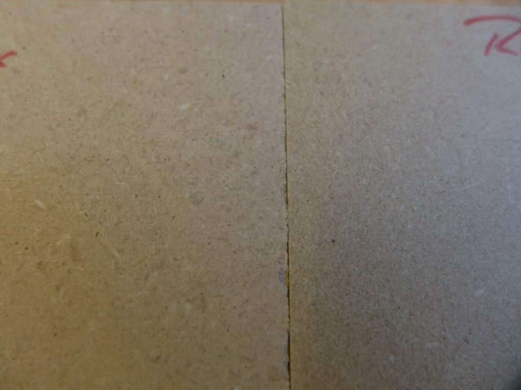

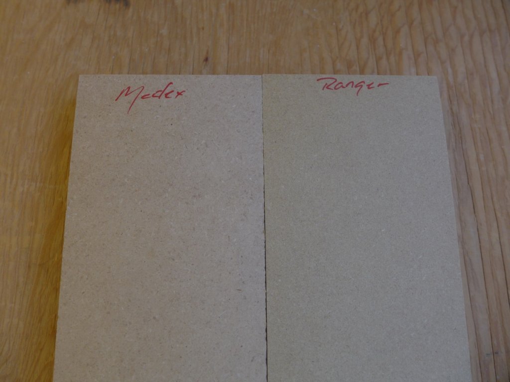

Appearance:
Both look like MDF. I didn’t taste them. The Medex looks slightly more granular, but I might attribute that to differing color of particles. Whereas the Ranger Board looks finer and more homogenous in color. If forced to choose which looked more attractive, I’d have to give the nod to Medex.  Its warm brownish tone ultimately more appealing than the yellowish pallor of Ranger Board. The Medex has a more prominent “grain” on surface. I assume from sanding at factory.
Cutting:
Both can be cut with conventional woodworking power tools. I didn’t try an adze or handsaw. Machining the Medex on CNC router produced larger, more defined chips with less apparent dust. Ranger Board was less chips and more dust. This would lead me to conclude that the Medex is more “plastic” by some margin. I attribute this to either the glue used, the actual wood in its make up or some combination of those. Ranger Board makes some claim about particular wood(s) involved in manufacturing, but I can’t be sure of the relevance to the real world, save the appearance.

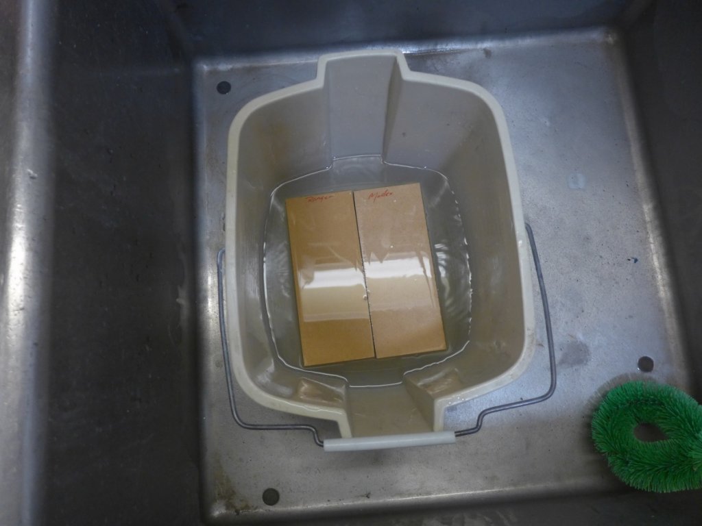

Moisture resistance:
This required that I break out the “big gun” tools. A three gallon bucket and an inexpensive Chinese micrometer. I dunked the samples in tap water for 30 seconds, measuring thickness both before and after. I did let them dry before re-measuring while I mowed the lawn. No appreciable difference between the two. The differences in measurements could easily be attributed to ho-hum tools or methodology. The surfaces of both were slightly rougher to the touch after the dunking and drying.

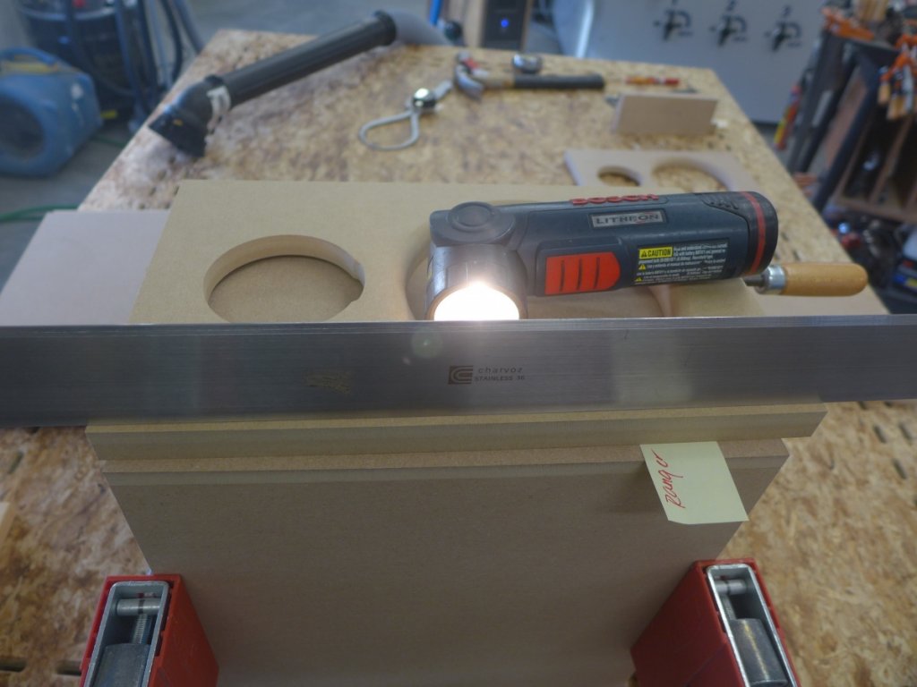

Stability after machining:
I qualify “after machining” because both were (pretty darn) flat to begin with and held flat via some serious vacuum during machining. Thus I attribute the before to after cutting variance to some sort of internal stress relief. Perhaps supernatural in nature. While the Ranger Board remained mostly flat, the Medex showed some bowing on the more aggressively machined parts. Probably no concern in the speaker building realm as it could easily be removed when clamping assemblies.
Where does this leave us (me)?
Based on weight and dimension measurements and keen observation through my magnifying safety glasses, I would conclude that either is superior to mill run MDF in terms of speaker building. That density being the key ingredient to a few things: Holding a crisp edge when machining, resistance to impact damage and, of course, lack of sonic contribution. No clear winner here from my point of view in spite of manufacturers’ claims. They aim at slightly different markets with their hyperbole. Ranger Board guns for the cabinet door world, and Medex touts its moisture resistance. For intents and purposes in the speaker building world I’m not sure either has any real value.  Their specification sheets seem to show some numbers that would give the nod to Medex.  More is better, right? I just can’t say with any certainty that modulus of elasticity or internal bond strength is relevant in the speaker building arena.
For what it’s worth, I would and will use either with confidence.

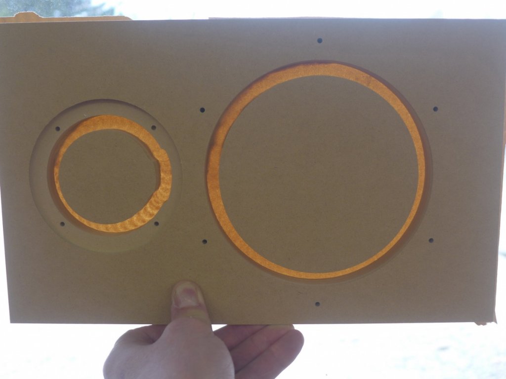

I may be easily entertained, but pulling parts off CNC today I happened to be standing next to window. I was kinda taken by how this looks so I held it up to glass and shot photo. That's .005 thick MDF in the driver cutouts. Gets me to thinkin about making some lamp thing...
