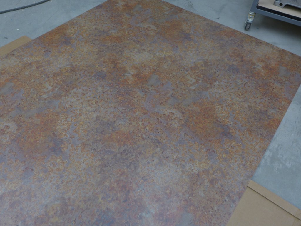

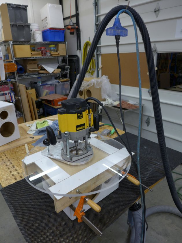

Been some time since I posted in this thread, but the saga continues.
I made a thing
To do a thing
And use this

« Reply #246 on: 10 Apr 2025, 03:52 am »
Looks like a piece of steel, but I suspect it's some sort of "Formica"?
Looks good on the speaker.
Ding, ding ding! Wilsonart "Oxide"
 I always liked the look of the earlier inset panels I did, but think the process used to get there excluded many hobbyists. I'm developing a simplified version. Still requires some woodworking chops, but not the metal patination and CNC router. Also, can be done after assembly of speaker cabinet.

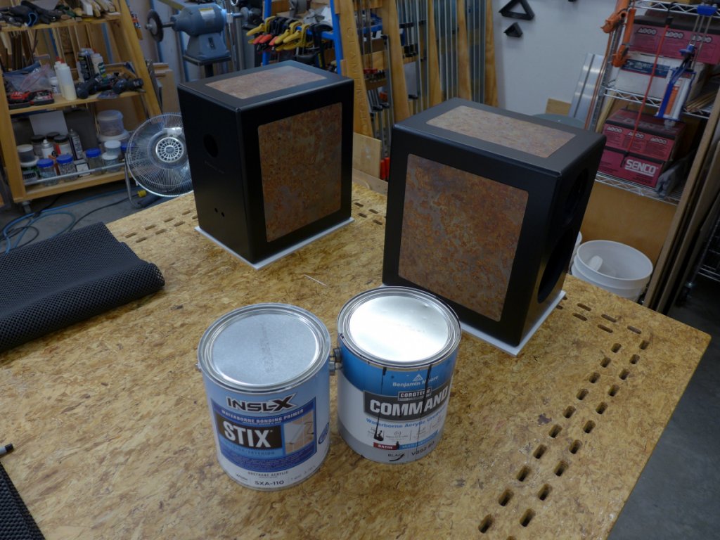

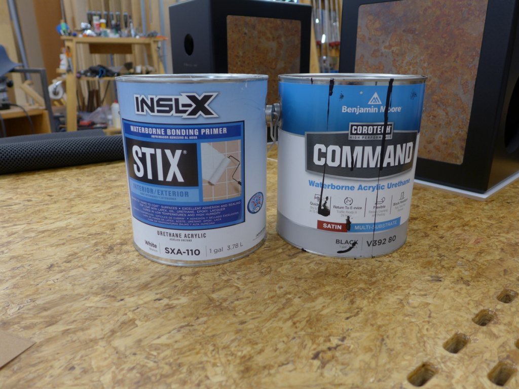

« Reply #248 on: 25 Apr 2025, 01:07 am »
And here we have finished product. My notion about getting a reasonable finish with a weenie roller proved not-so-good. Overhang in tweeter rabbet and just not flowing out like I wanted. I switched to DeVilbiss Starting Line HVLP gravity feed (pretty inexpensive) after first rolled finish coat and sprayed two final coats.
  Now, y'all know me and I really like solvent base stuff, nasty fumes and all, but I have to say this stuff impressed me. STIX I knew about, but Command is new to me and I think a fairly new product in BM line. Thinned it 5% and used a 1.8 tip and it layed down really well, considering what I was covering. BM says it cures in 24 hours compared to Advance which takes 30 days to fully cure. This stuff is tough for a water-based paint. Next time I'll spray start to finish.

Peter, when you were thinning the finish coat, did you use Floetrol or water? Looks good!
Peter J
  • Posts: 1966
  • Hmmmm
Re: ***X-LS Extravaganza***
« Reply #251 on: 25 Apr 2025, 03:37 pm »
Tap water. I haven't used Floetrol in some years. I have to assume that for what it costs, the chemists have included all it needs! It does flow out nicely.
I forgot to mention, both products can be sanded after a short dry time and they both powder which is my kinda my benchmark.
