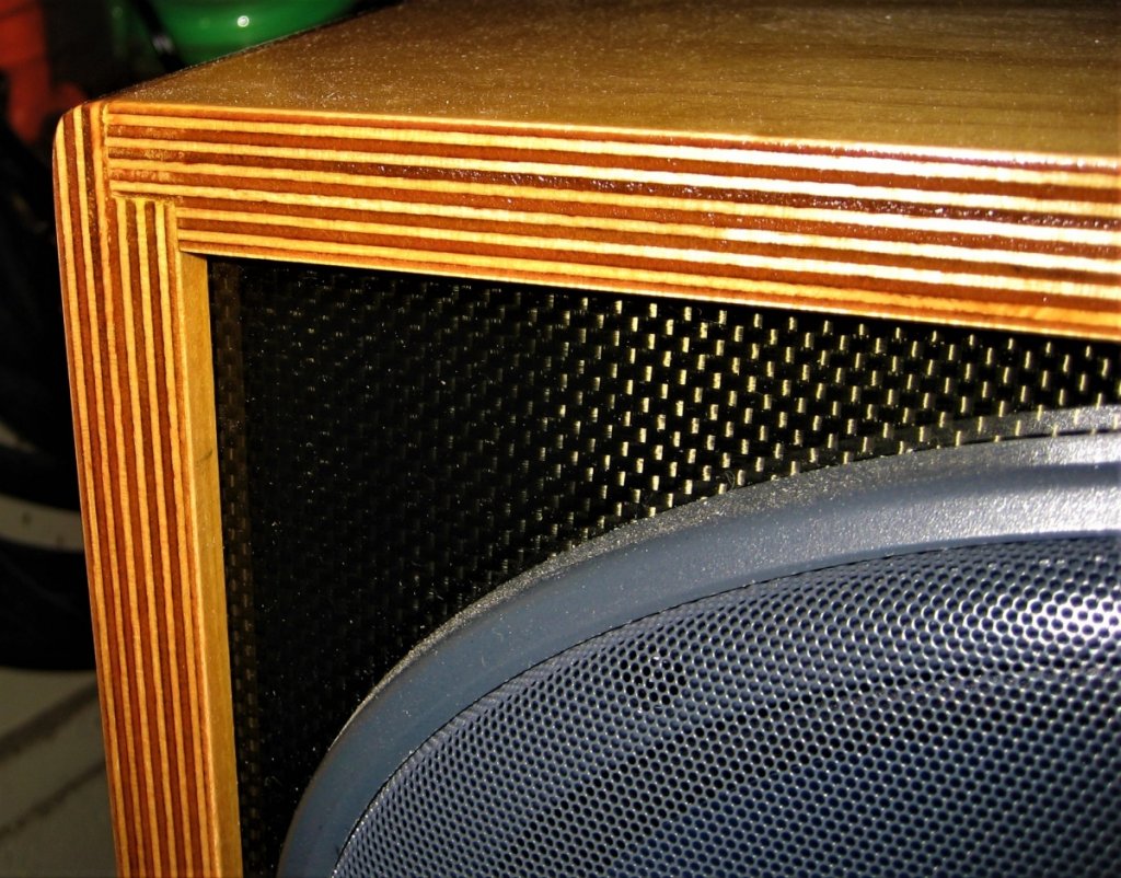

Nice work Peter, as always.. I like the look of exposed plys on BB or ApplePly. I used the method on my garage boom box:

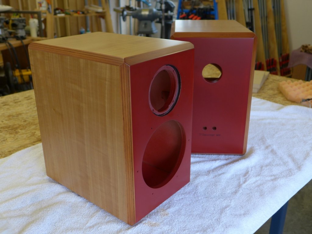

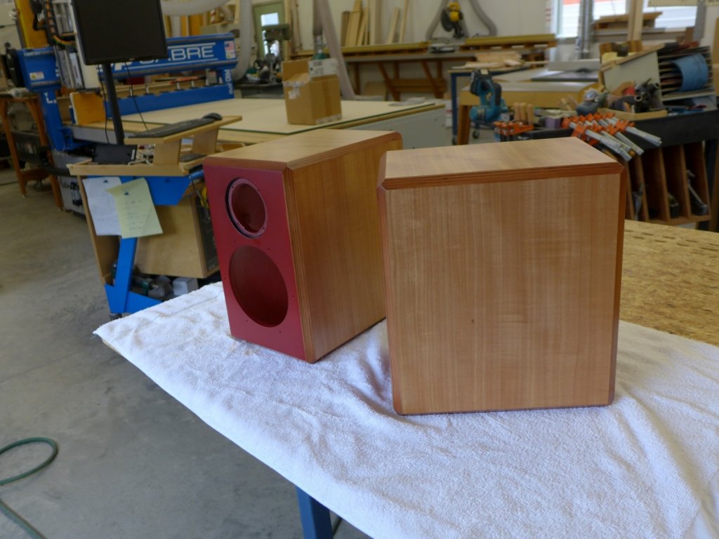

Getting further down my long road, I've been messing around with finishing possibilities on the Baltic Birch cabinets. These have Satinwood veneer and an experiment with coloring. Learned a few things, but that's kinda why I do it anyway.

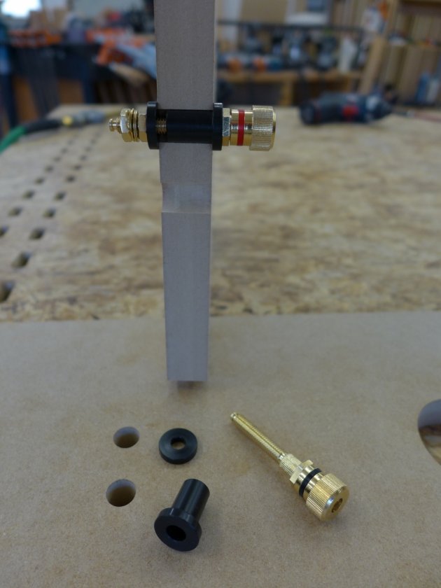

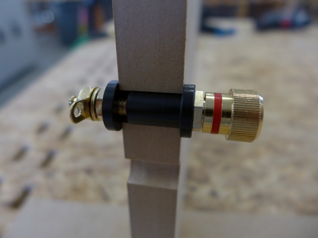

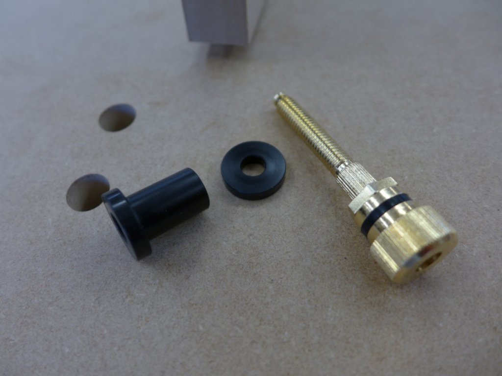

I've always thought binding post cups were a compromise. Take a solid cabinet, cut a big hole in it and fill that hole with flimsy, probably resonant, plastic. Here's a solution I've devised to do away with the big hole and fit a decent binding post in the same hole a Tube Connector. These are Delrin bushings, a tough non-conductive polymer. I proud to say they're made in the USA, too. Delrin is actually a brand name, the generic name is Acetal.
Since the beginning, I've offered a choice of backs on X-LS, which means I stock twice as many backs so I can accommodate people's desires. The majority of flat packs I sell have tube connectors so this would give folks a choice and I don't have to cut and stock two different backs. I can see other possibilities for their use, but before I place a big order, I'd be curious to get feedback from the good folks here. They'd sell for $36 and are cut to specifically fit this binding post although they might fit others designed for 1/4" mounting hole.
 https://www.parts-express.com/Dayton-Audio-BPA-38G-HD-Binding-Post-Pair-Gold-091-1245

Peter,
Love the veneer work but I have to admit, the coloring may be just a bit outside my comfort zone. I do like your solution for the binding posts. My question is, from Danny's view, is the gold plate enough? Is there ferromagnetic materials underneath the gold plate?  Would the gold plate sufficiently overcome the problems with steel in the path?

Is that $36 for 2 pairs?  Seems like a good idea but not as cost saving as one might hope.

Peter,
Scott
The posts and tabs are gold plated brass, the washers and nuts gold plated steel. Presumably, if someone objects to this, they would opt for tube connectors anyway. Bear in mind, the standard binding post Danny offers is unplated brass and steel, so the Dayton would be a significant step up in quality.
$36 for 4 bushings and 4 washers. Enough for two speakers or four binding posts. I could probably get them made outside US and use lesser plastic, but it's not my preference. Also, I'd have to purchase thousands compared to hundreds.

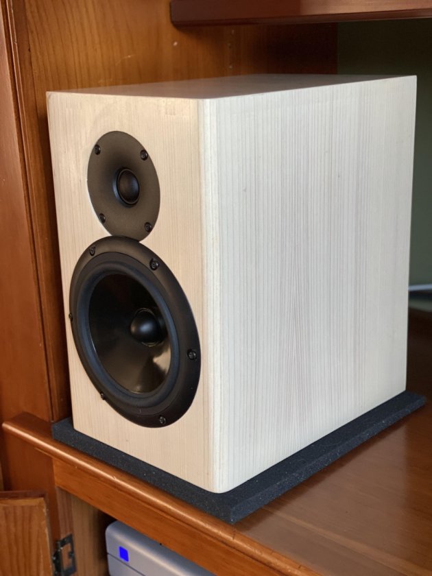

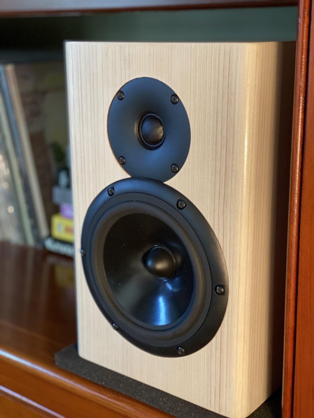

Rob sent me photos of his build using my flat pack. Veneer is Cypress, whitewashed, Arm-R-Seal, then polished. A gift for his brother-in-law. Pretty cool, huh?
NIGHTFALL1970
Re: ***X-LS Extravaganza***
« Reply #211 on: 6 Jul 2021, 03:13 pm »
What is the “pad” that they are sitting on?
hawkeyejw
« Reply #212 on: 6 Jul 2021, 04:33 pm »
Those remind me of one of the original X-series finishes from AV-123. They look nice.

« Reply #213 on: 7 Jul 2021, 03:20 am »
Absolutely stunning Encores. Lucky brother in law. Sound and looks both stunning. :)

« Reply #214 on: 22 Jul 2021, 10:13 pm »
Peter, thanks for posting these picks.  This build was the first time I've used your flat pack for the X-LS Encore's.  The quality of the MDF and the fit of the cabinet were perfect.  Thanks for giving me a great "foundation" to build these on.

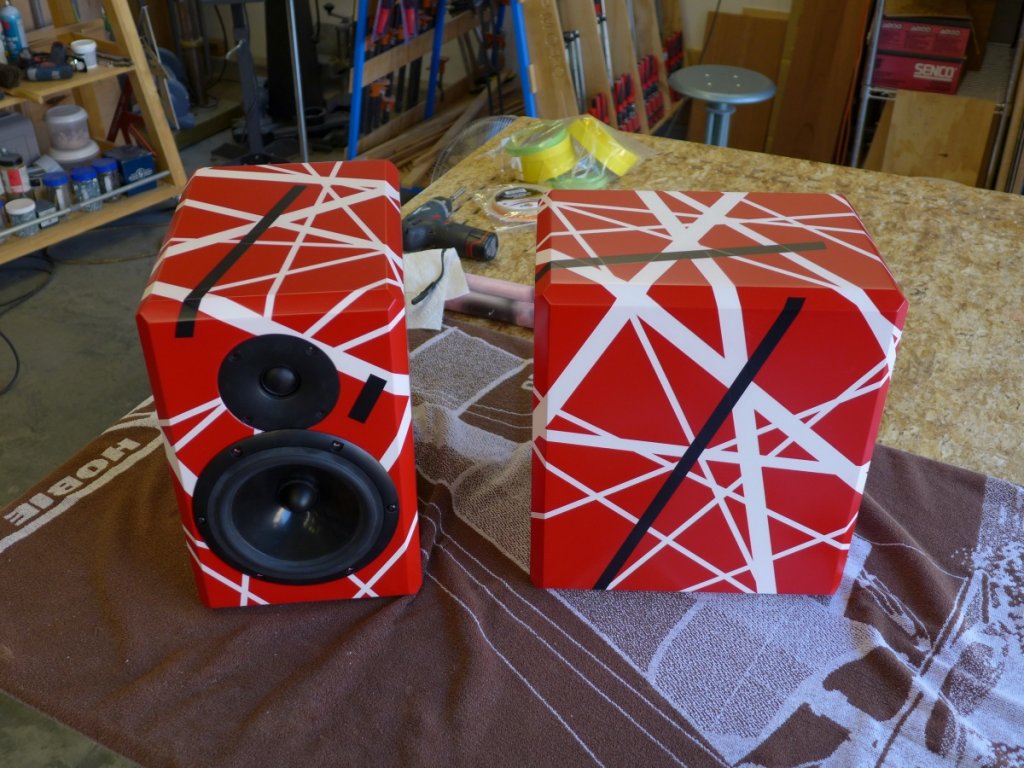

« Reply #216 on: 7 Aug 2021, 07:34 pm »
What do y'all think I should do with this funky veneer?
EdwardT
  • Posts: 133
« Reply #217 on: 8 Aug 2021, 11:40 am »
Hey, really nice Eruption Encores there! That's some wild veneer that looks like a little will go a long way or suited for use in an industrial themed cab, maybe as borders for a copper inlay panel.

Thanks for the memories and music, Eddie. My nod to your legacy.
A+ work as always Peter
mzbrahce
  • Posts: 81
« Reply #219 on: 8 Aug 2021, 03:54 pm »
Use that veneer for speaker sides, with rest of speaker, baffle, back, top and bottom all black...or the cream color or green from the veneer.
