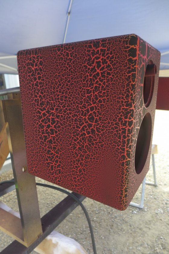

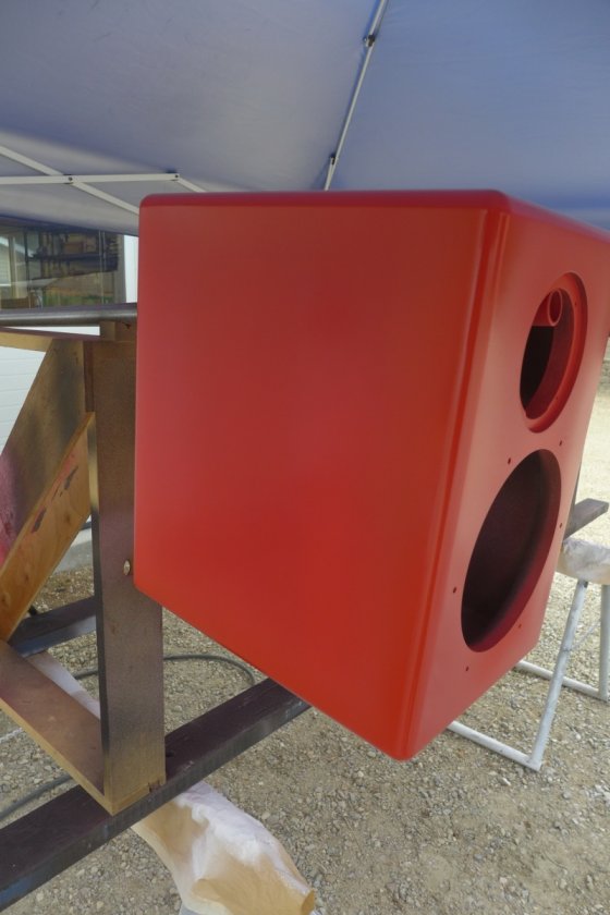

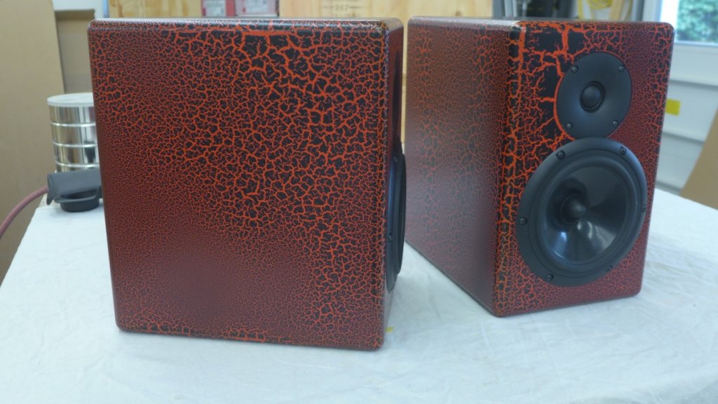

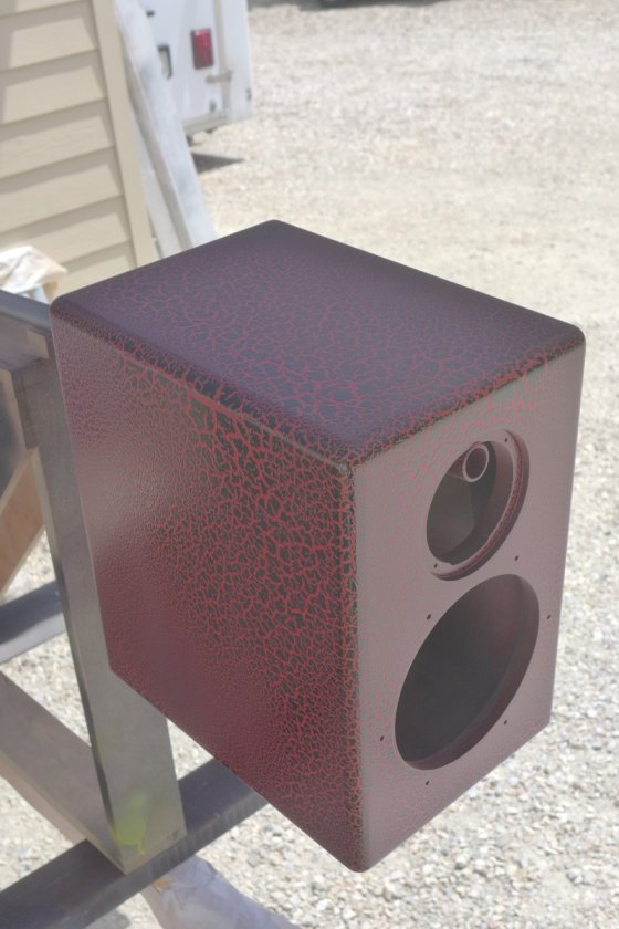

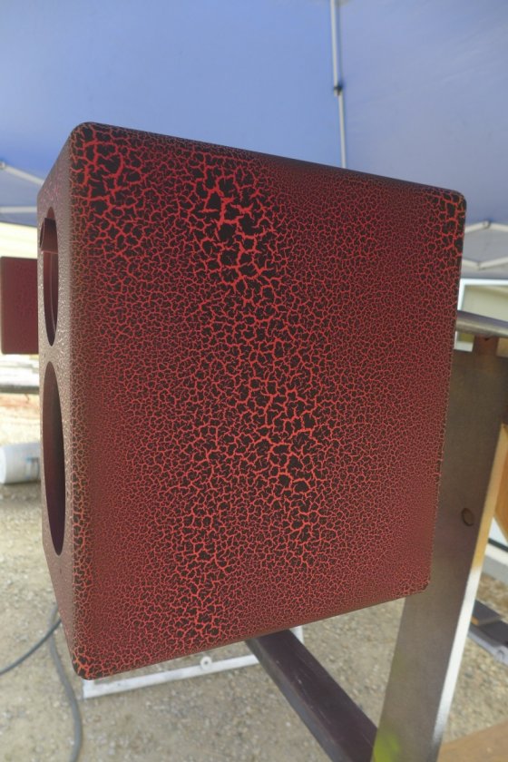

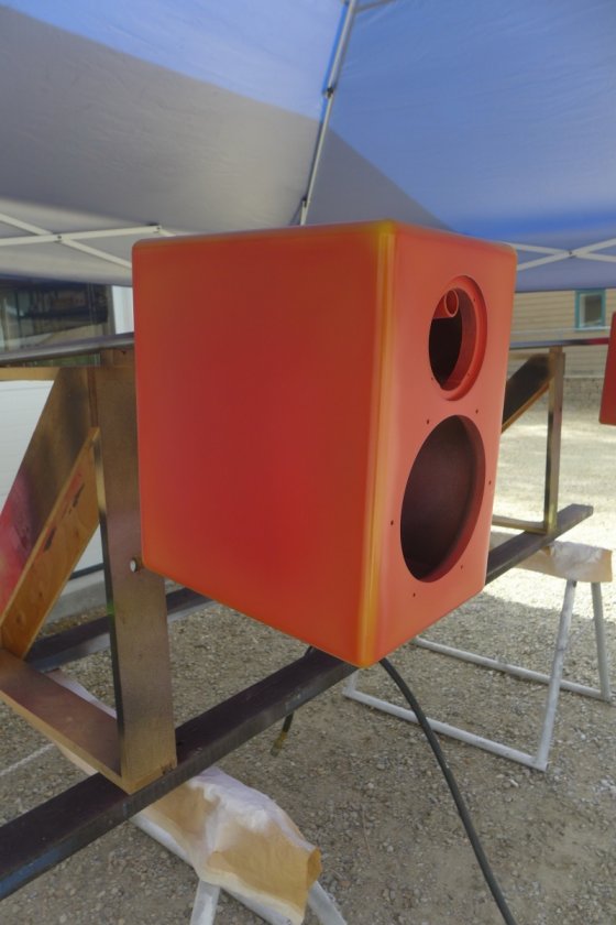

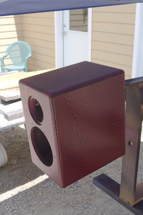

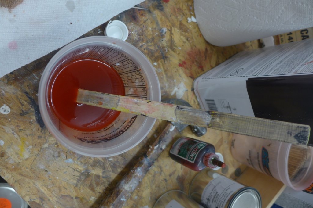

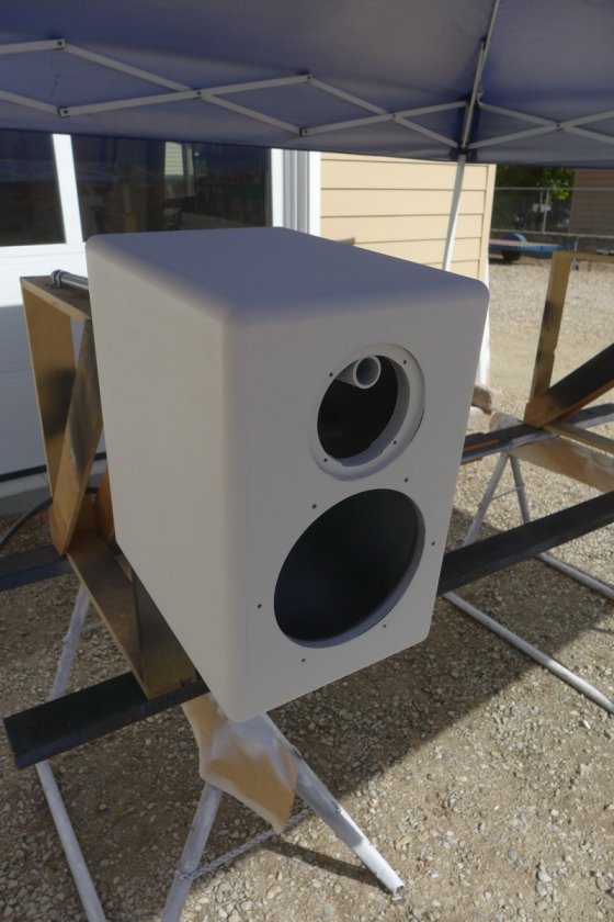

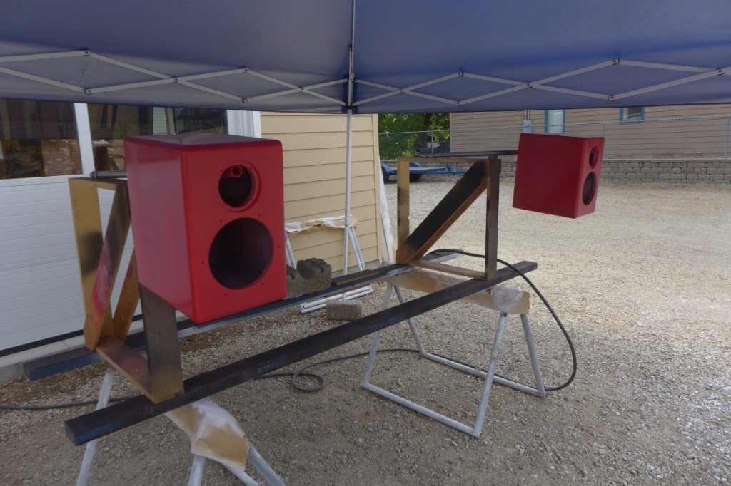

Round three.
My vision was to have these look like photos I've seen of lava flows where it's black on the surface and the molten lava is visible through cracks. While not quite what my mind's eye saw, they still look pretty striking. These are all somewhat experimental anyway...
What shall we call these? Magmas? Cracked Up? Bad Trip? Y'all tell me...
Primed white so red would be bright as possible
Then red...RF RED, you figure it out :wink:
Hard to see here, but I mixed some yellow pigment into red lacquer to move color more towards orange and shot the corners only fading into red field
Then yellow and a touch of orange pigment in clear shot right at corner

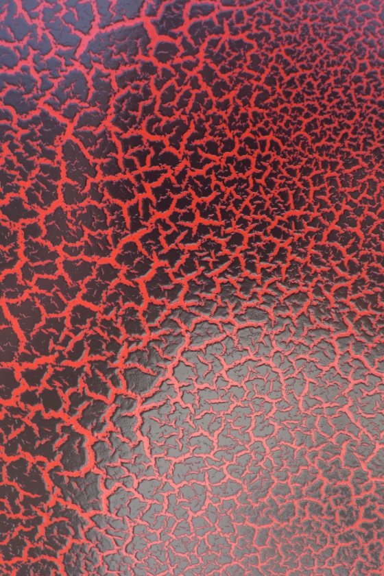

Black primer in Crackle Lacquer. First time I've used this stuff other than samples leading up to it. It's a little bizarre to watch thing unfold and the results are difficult to control
The yellow didn't turn out quite like I wanted, looked more like a dying dandelion than lava.  So I decided to tint clear lacquer to shift it toward red/orange to see if I could change it a little. Two coats of tinted made it mo betta. I'll let this dry for a day or so and give it a coat or two of clear. Close up better shows what they look like, wrong time of day to photograph and getting reflection that kinda washes things out.

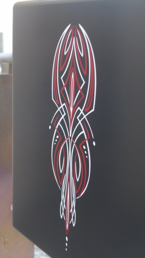

And yet more fuel for the (slow burning) fire!

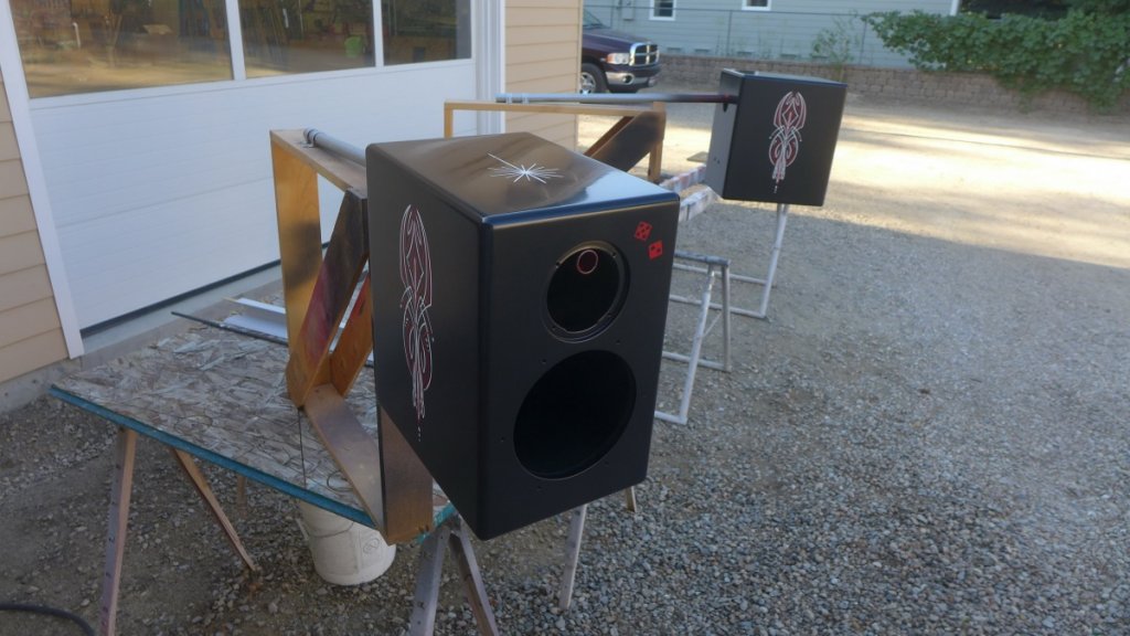

 I never posted photos of completed speakers given to grandson.
And after staring at them and wondering about if for a long time, I figured I had nothing to loose by spraying over the decals on these. As is often the case with me, curiosity drove the train and I sprayed three additional coats of conversion varnish on them. Nibbed the decal between coats and am really pleased about results. I like these so much, I'm keeping them. Who knows, maybe I'll even build them out!

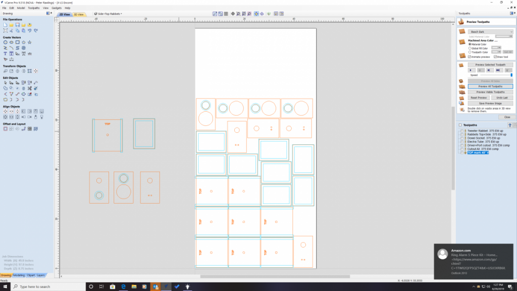

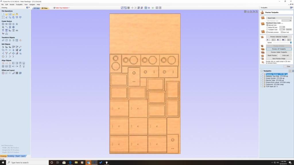

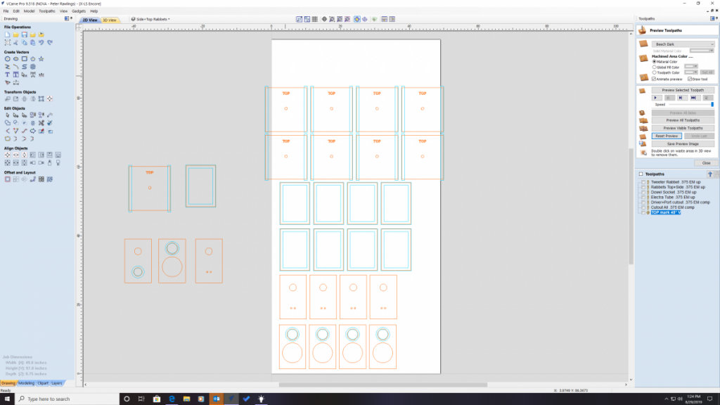

Yet another X-LS chapter. This one about cutting out cabs on CNC router. Much talk on the forum about CNC these days, but I thought y'all might be interested in more detail on the process. Also, this old dog is getting his feet wet on YouTube video...wonders never cease!
Screenshot of cab parts drawn in V Carve Pro. White rectangle represents Sheet of MDF
And another after "nesting". Nesting is about optimizing material use and minimizing machine movement.
This is a simulation after tool paths have be calculated. Tool paths or vectors are essentially the instructions the machine follows to accomplish desired tasks. Machine is nothing without software to direct it. A kinda new concept for an old analog guy.
And finally my first use of a camera to record video other than by accident. Also my first YouTube video and speaker cabinet cutting on CNC. I muddled through, but am convinced there must be something better than HD Movie Maker PRO for processing video. It's partly me, I'm sure, but it sure seemed glitchy, and frustrating as a result. Critiques and recommendations appreciated. At this stage, I'm not looking for an all out assault, but rather a competent, easy to implement solution.
