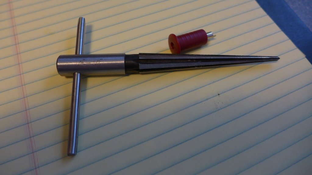

New question: The new batch of tube connectors either are larger than the old ones or the holes in my cabinet backs are too small. Any idea what size? I have only a 3/8 inch bit which is smaller than the existing hole, and a 1/2 inch spade bit which looks too big. I have to go buy a bit to expand the hole so wonder which is best. 7/16? Thanks for help.
Crap! I don't have a new one here to measure, the old ones fit perfectly. I did mic an old one and the largest diameter (rib) is .436-.438. Does someone have a micrometer they can measure a new one with?
I have used a 1/2" reamer to remove few thousands when I've had finish build up in the hole. I think that'd be your best bet. The 1/2 spade will surely bring you grief.

Hey Peter, no worries, I got a 7/16 bit. It took off some material and now they fit perfectly & snugly. Just an FYI to you and others on this batch that they will not fit in the existing holes without at least some shaving, but 7/16 does it perfect.

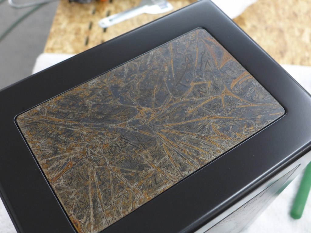

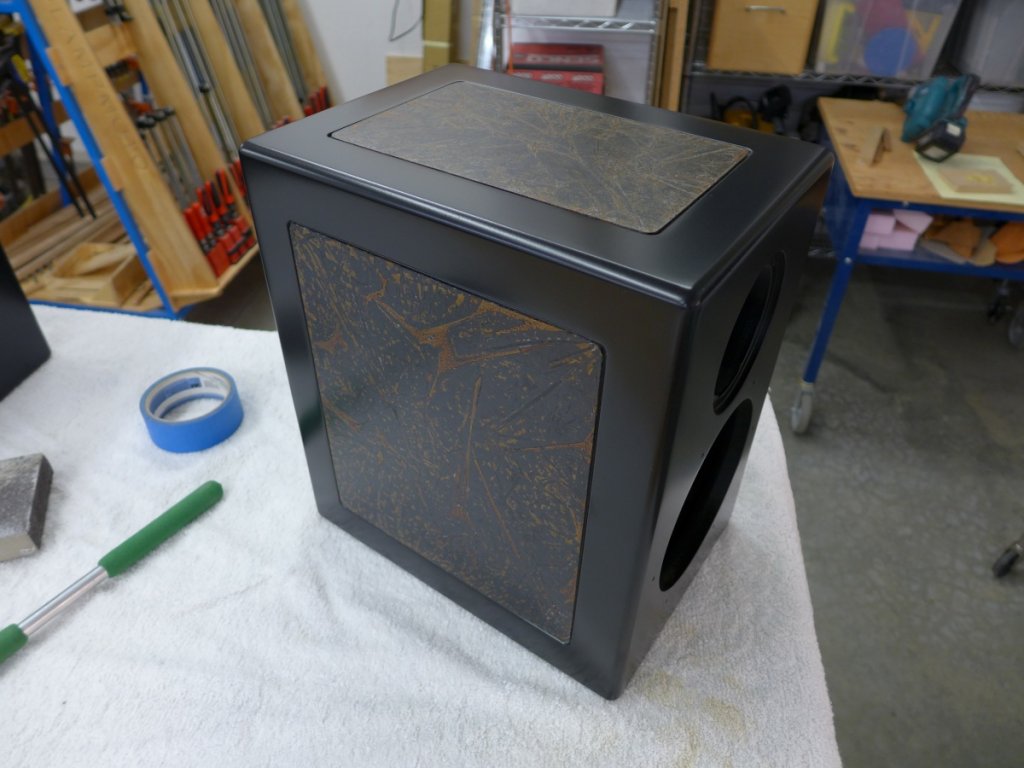

I've been learning a new patina technique which I'll be showing in an upcoming video. 16 ga steel inset in sides and top.
Here's a preview.
Im digging that idea!
Tho i do wonder how the mass of the steel glued to MDF affects the cabinet resonance. 🤔
Peter J
  • Posts: 1966
  • Hmmmm
Re: ***X-LS Extravaganza***
« Reply #167 on: 12 Aug 2020, 03:31 am »
I wondered that too. It's a full spread of notched silicone to adhere panels.  I can tell you it  takes all the *tink* out of them and adds a little over 2 lbs. of mass to cabinet.
That pretty interesting, i imagine that no-rez would only further dampen the overall response , since the steel/MDF combo act as both mass loading and with the silicon adhesive, constrained layer damping (CLD), then once you add the no-rez you get a dense butyl-like layer on the inside to help absorb even more resonance...
(I made a thread about mass loading and CLD on the Lab circle) but haven't checked on it since then 2-3 months later, so i should probably go back to it to see what was said..  :lol:

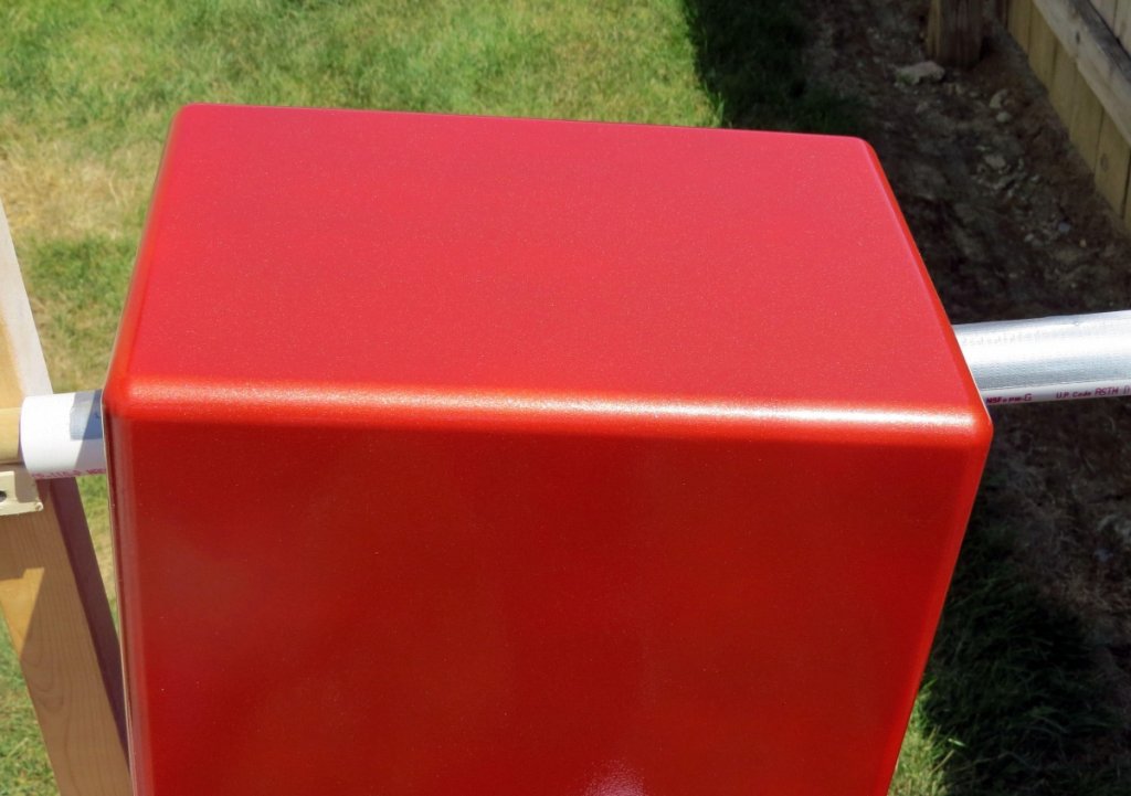

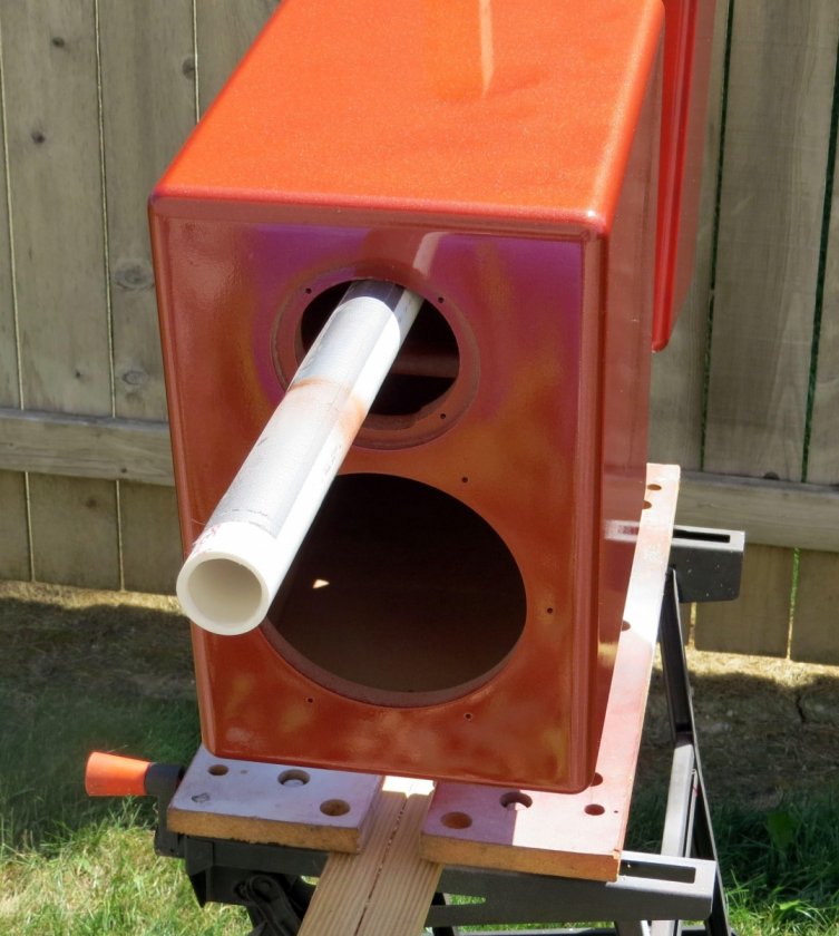

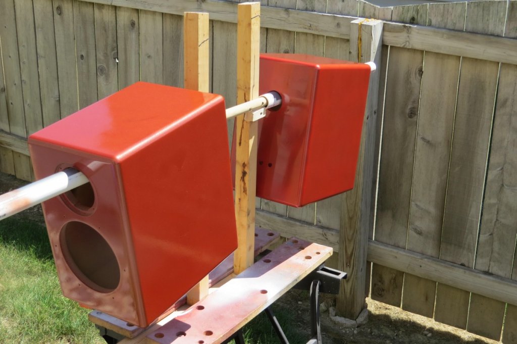

I recently got a helper
And who can guess what I'm doing here?
