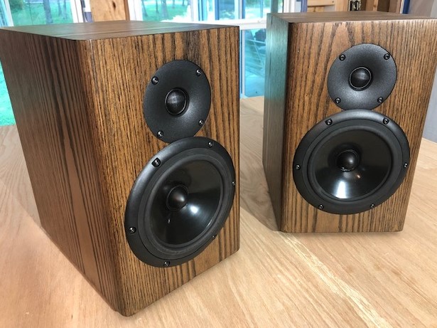

« Reply #142 on: 3 Jun 2020, 12:26 am »
Just finished my first speaker build.  I’m hooked.  Already thinking about what to build next.  For my first build I chose the X-LS Encore.  Peter’s flat pack and you tube videos were a huge benefit for me.  Thanks to Peter, Danny, and the others here on the forum for the guidance and inspiration.

« Reply #143 on: 3 Jun 2020, 01:51 am »
You knocked it out of the park, Thor. Those look great.

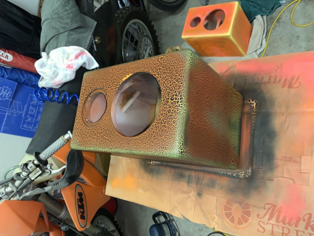

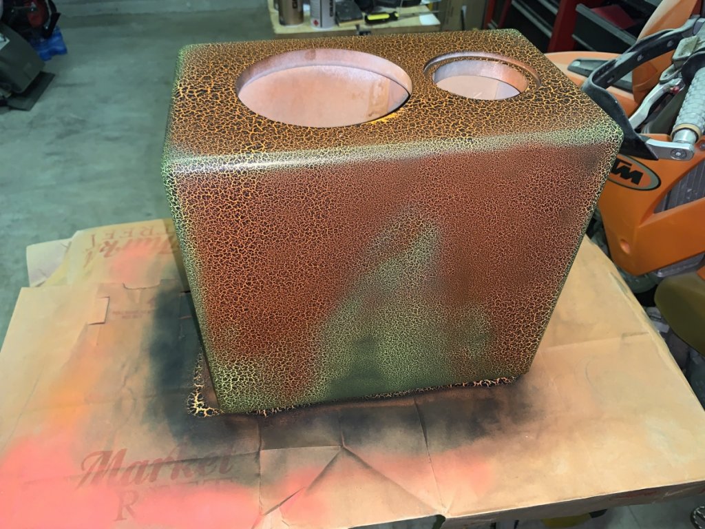

« Reply #144 on: 3 Jun 2020, 03:21 am »
I just want to document my fail in my first attempt at the "Gamers Neon Crackle finish"  My son is a 17-year-old gamer and wanted to create something fitting but it was a complete disaster! :lol:
There is learning curve to build and finish DIY speakers!  Some attempts don't work out and need to be sanded off.   :duh:
But now we are all happy with the red and black crackle finish of the second attempt.

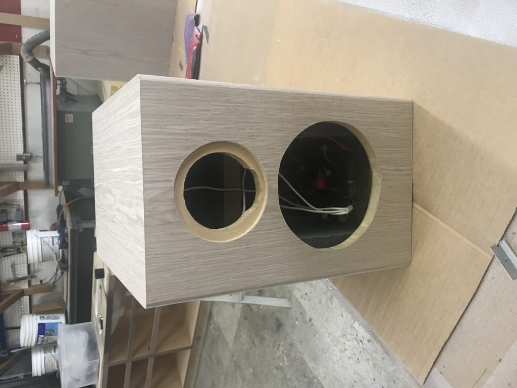

mmurt
Re: ***X-LS Extravaganza***
« Reply #152 on: 22 Jun 2020, 09:06 pm »

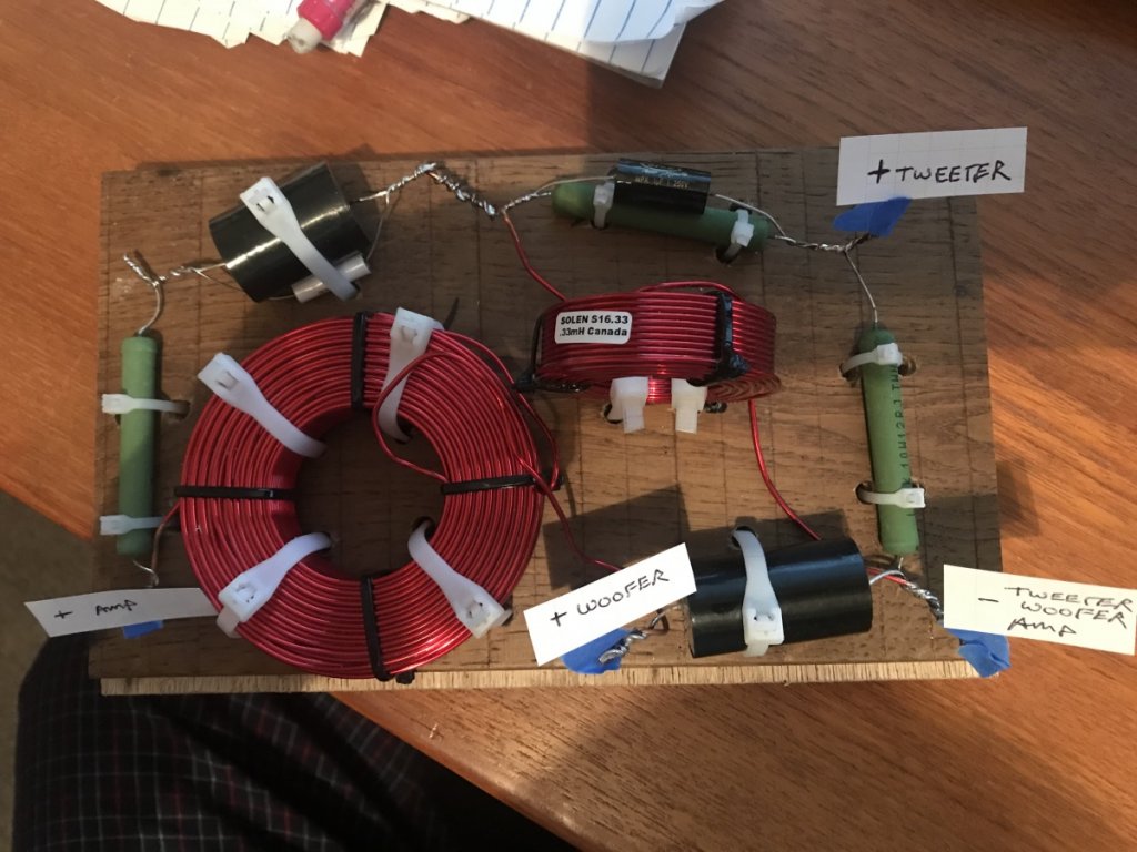

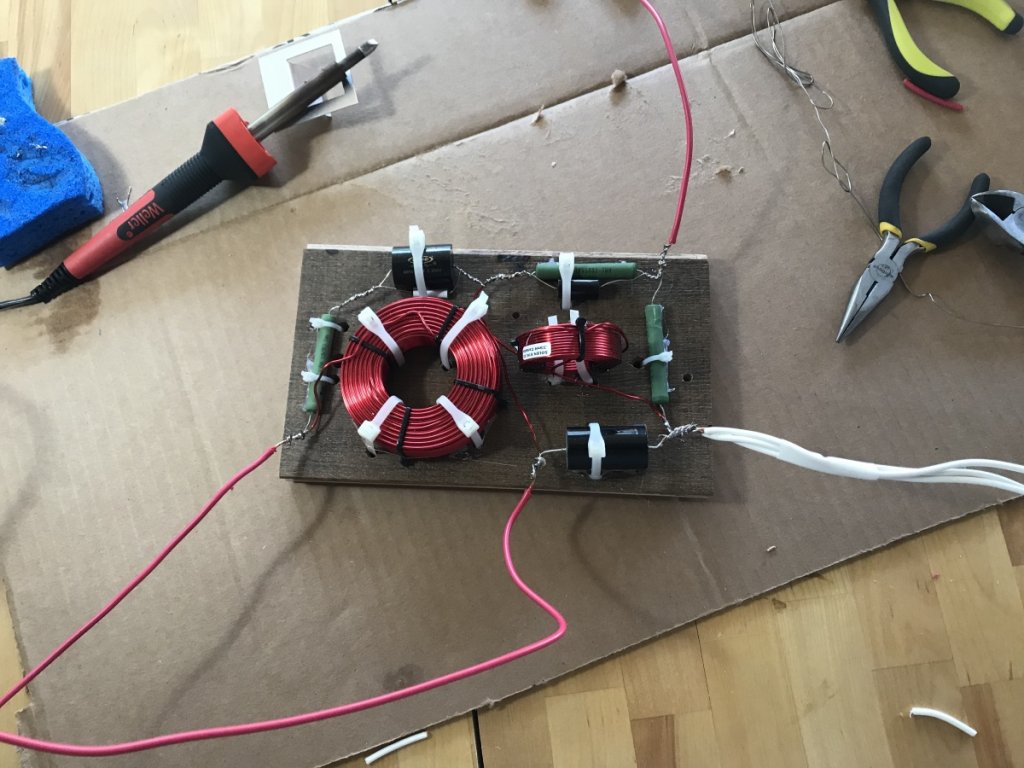

About to wrap these up and want to triple check my crossovers before I solder to my drivers and tube connectors.  Does this all look correct?  Thanks
Danny Richie
« Reply #153 on: 25 Jun 2020, 01:59 am »
Looks good.

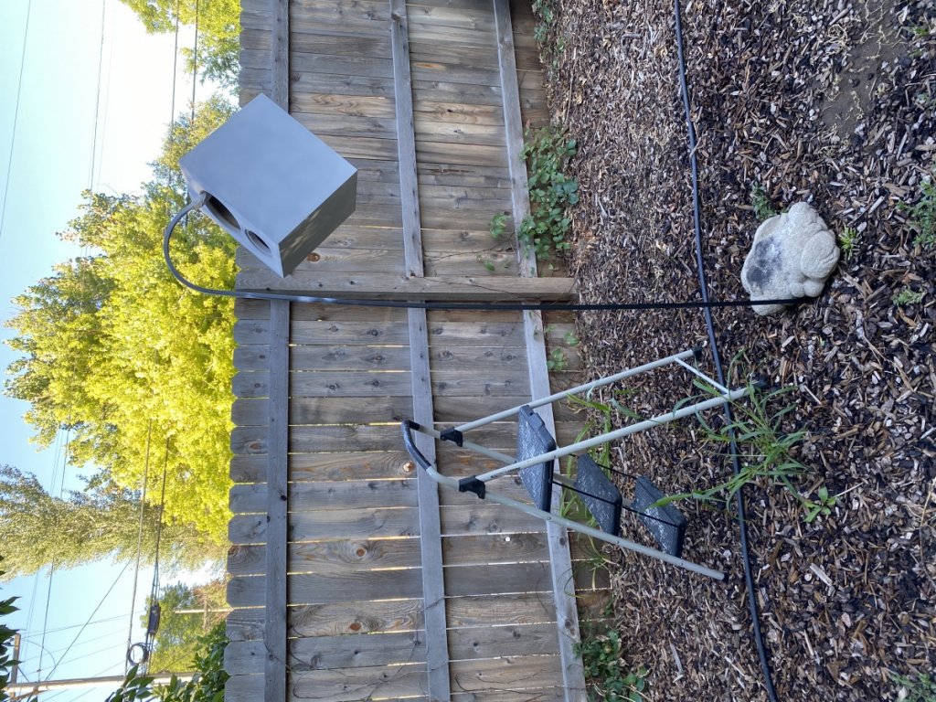

MokhaMark
  • Posts: 9
« Reply #156 on: 29 Jul 2020, 03:35 pm »

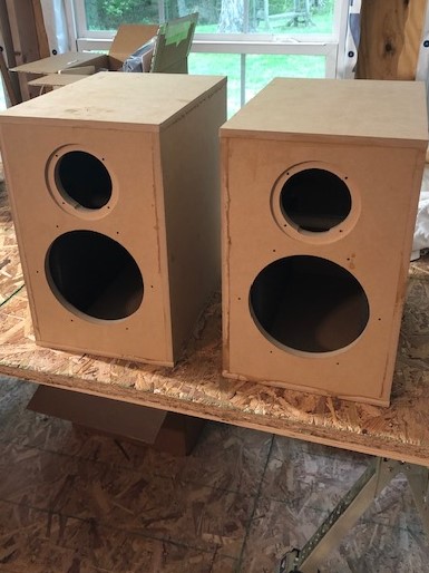

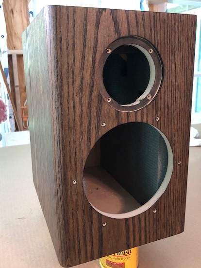

Hi All,
I am working on my first build, thanks for all the help I found on this forum. I wanted to share a picture of a spray painting hack I just had kicking around that saved me having to build something. An iron hanging plant holder that spikes into the ground. I have a rock on top as an added precaution that it does not tip over but in fact the spikes are long enough to hold the weight of the speaker. Works great and I can hit the entire box without having to set it on anything. Here's a picture of the priming phase.
Happy building and listening.
(cannot figure out how to rotate the picture, sorry.....)

Thanks for posting, y'all!
I reoriented photos because...well, just because.
