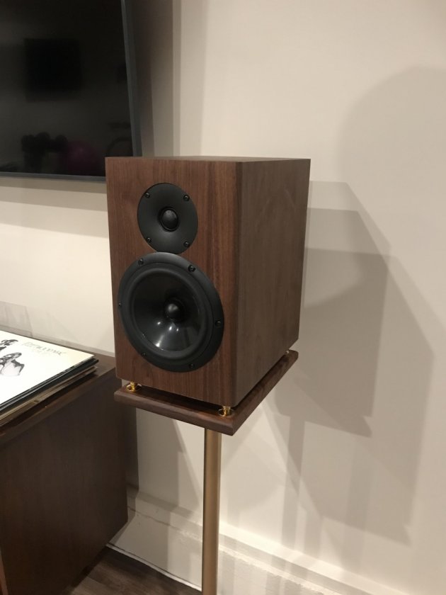

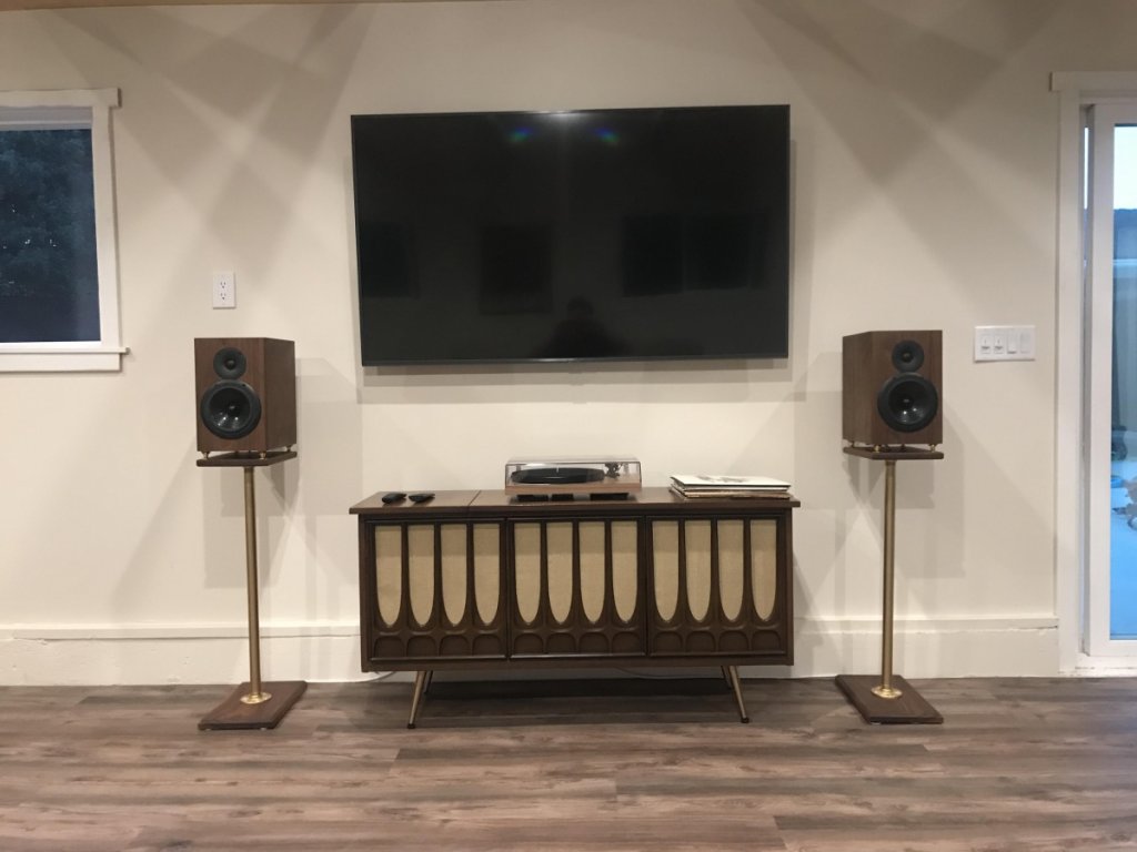

I love it when folks send or post their "completed" photos. These from Casey, in oiled walnut. They look groovy with that console...
AlexH
Re: ***X-LS Extravaganza***
« Reply #132 on: 20 May 2020, 04:00 pm »
Those look great!!
Hobbsmeerkat
  • Posts: 2741
« Reply #133 on: 20 May 2020, 04:26 pm »
Those look awesome, love the walnut too! Its definitely the look I'm going for when it comes time to build my Studios.
Danny Richie
« Reply #134 on: 21 May 2020, 12:39 pm »
Man, those do look really good.

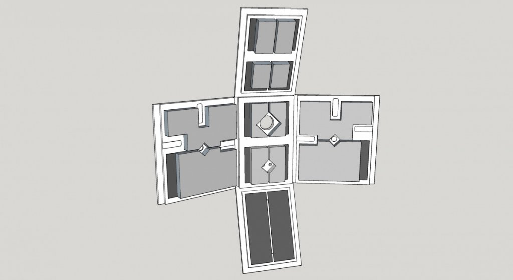

I've had many queries about NoRez installation. Surprising to me, several have suggested, and some have installed, before cabinet assembly. Interestingly, when I showed this illustration to my wife to gauge if it actually accomplished what I was intending, she suggested just that...installing before assembly. I'll leave that to builder to decide, I guess.
Anyway, my intention is to make a video about NoRez installation in general using X-LS mules I have. Here's my question to y'all. If you were to look at this illustration and an associated dimensional drawings, would it make sense to you? I really want to clear things up on what appears to be murky to some.
Feedback solicited...that's where y'all come in.
Gearguy
  • Posts: 17
« Reply #136 on: 31 May 2020, 09:25 pm »
Peter, I pre-installed the NoRez in the pair I built from your flat pack. Seemed like the easier way to me. Your illustration would be very helpful to those who would like to pre-install it.

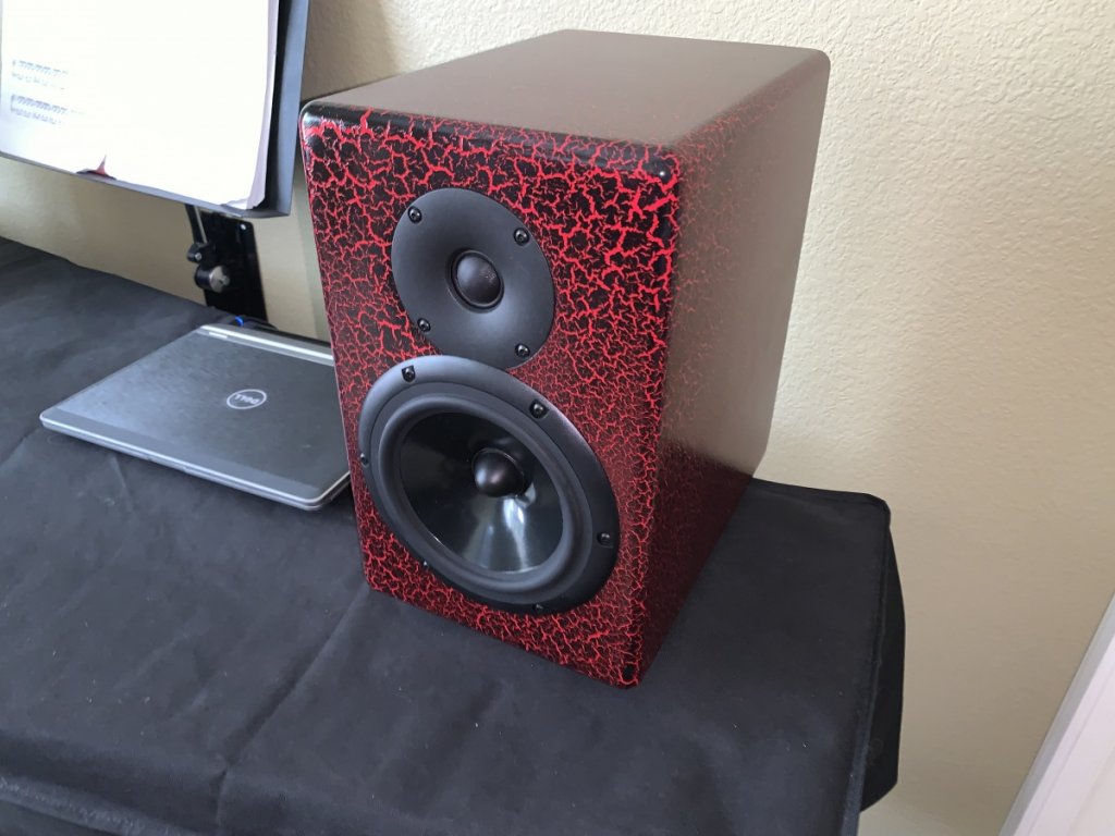

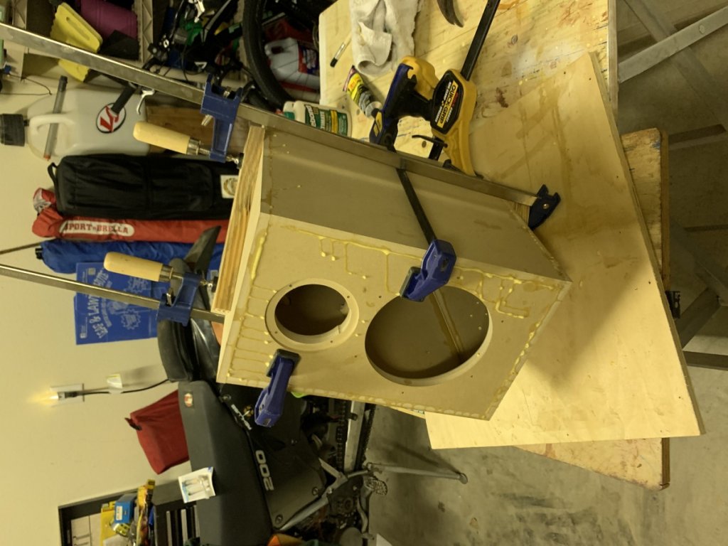

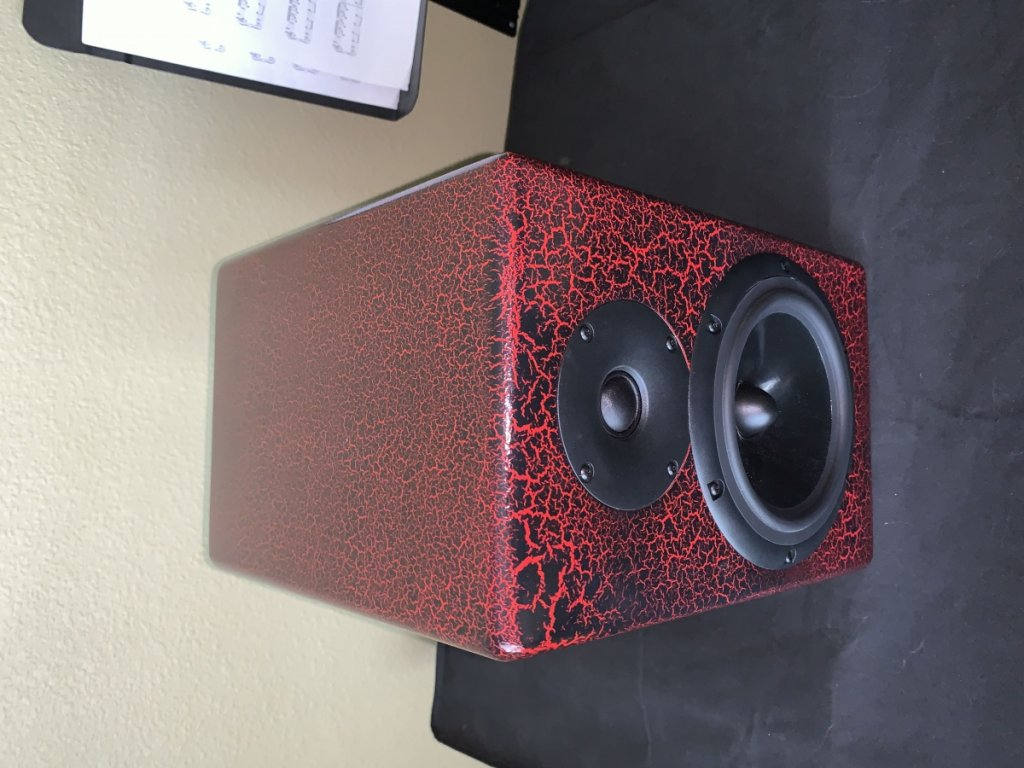

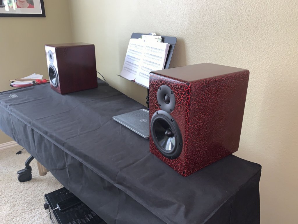

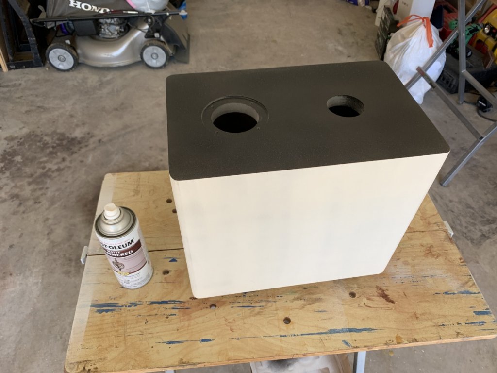

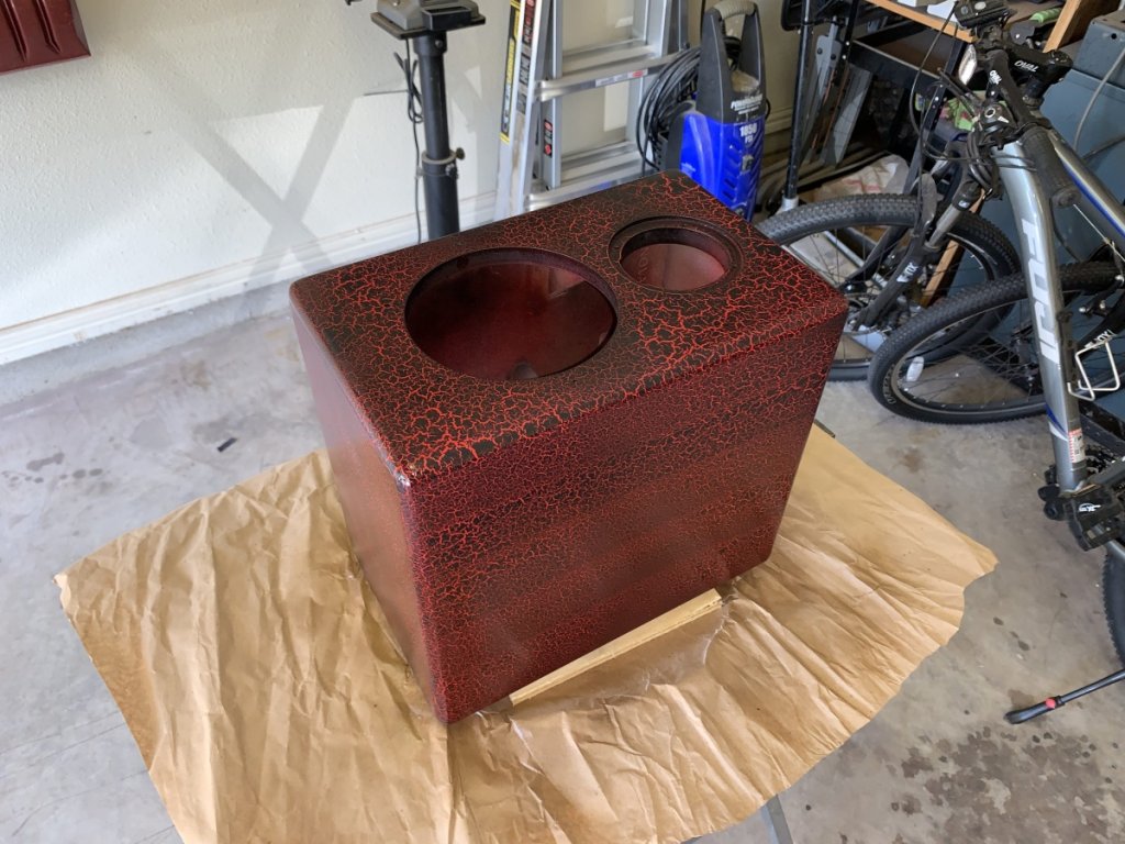

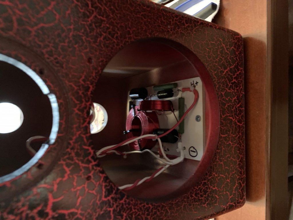

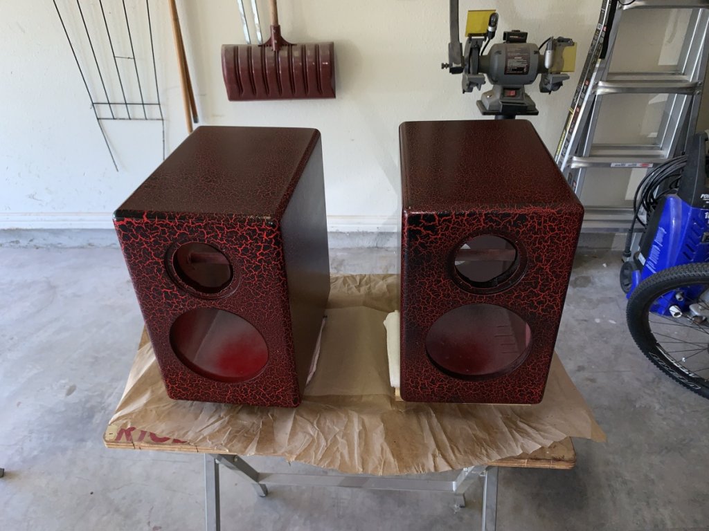

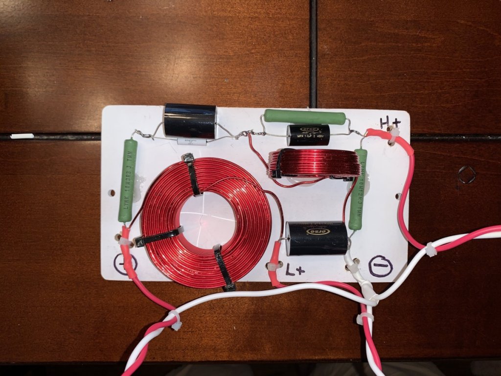

Here are some project pics of the X-LS Encore project I started this month to give to my son for his high school graduation.   Thanks to Danny and Peter for supplying the speaker kit and the Flat-pack!
Glued and clamped
Primed
Painted backs with a dark gray hammered effect spray paint
Crackled effect inspired by Peter's build for his grandson.  I used Montana Black Crackle spray over red Rust-Oleum enamel.
Finished with Krylon Clear Gloss Lacquer spray
Danny's basic X-LS cross-over

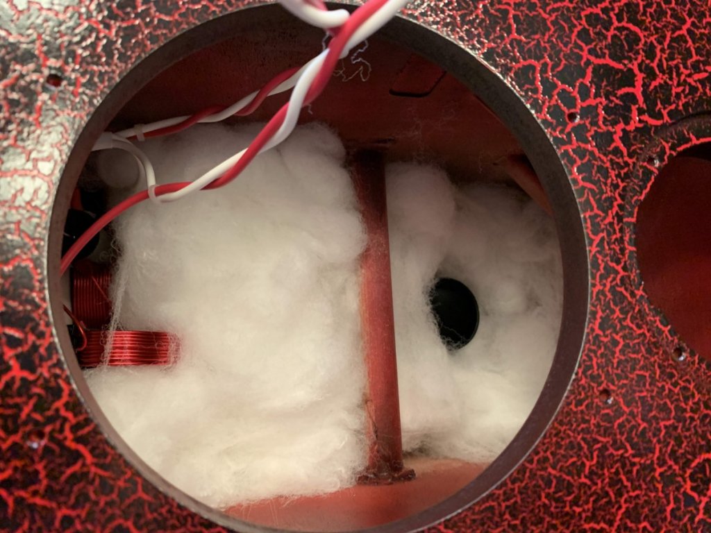

Cross-over inserted in the box
Sorry, Danny, I used polyfill for this build
Finished speaker one
Finished speaker two
Back of speaker
Overall I'm very pleased with the finished results and so is my son!  We just got them hooked up to a Denon AVR today and both love the sound so far.  Since this was my first real serious DIY speaker project there were some learning experiences but nothing too bad and happy with going the DIY route.  Both speakers look and sound fantastic!!

Feedback solicited
Makes good sense Peter. And a comment regarding the front baffle would avoid follow-up questions.
