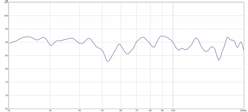

danvprod
Here is the way that 20-200 Hz looks these days. I added 5 x GIK 244s (2 between speakers in front, 2 @ 1st reflection points and 1 directly behind my listening chair). Lots of careful work tweaking the XOs of the Super V amps to get here.
This is the responses has no smoothing. I do want to still add some additional servo subs to the room to help even more and augment some of the midbass response (which is still problematic from 150 Hz - 300 Hz where the transition happens to the Super V's coaxial drivers.
