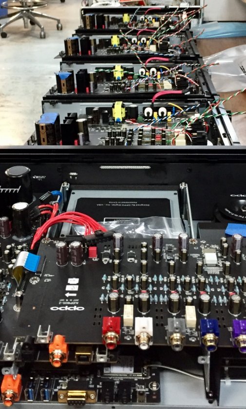

Just got back from Chicago and the Oppo UDP-205 is on my table.  I will be opening it up and sharing my initial impressions as well as mod plans for it today!

OK, cover off and the following is what I can tell you...
  • The 2CH DAC and audio circuitry IS identical to the Oppo Sonica DAC.
  • The digital connectivity and flexible functionality is identical to the Oppo Sonica DAC.
  • The internal switched mode power supply ONLY powers the video circuits.
  • All Audio analog and digital power is from the stock linear supply.
  • Ventilation in the new cover and overall enclosure is greatly improved.  I suspect this is because the 4K video runs HOT!!!
  • The Audio Magic will be an option for the UDP-205.
  • I am not sure yet about the Bybee rail.  I still need to work out exactly which regulator is supplying Vref to the DAC, like the 105. The regs are surface mount.
So, the mod that we have developed for the Sonica DAC and proven to be EXCEPTIONAL from our showing at Axpona Chicago this last weekend, WILL be directly transferable to the UDP-205.  The PCB will have to be customized to fit the 205, but the circuitry, external supply and implementation will be the same.
Summary of mods offering, schedule and options:
  • Tube mod for UDP-205 will be the same circuit as for the Oppo Sonica DAC. Lundahl transformer input and output coupled, fully balanced, with RCA and XLR fully balanced outs.
  • PS 9.0 (V10) external supply included in the mod.  This is different than the PS 9.0 (V9.9) that was used for the Oppo 105.  Different voltage and only tube rectified, not tube regulated. NOTE: OLDER PS 9.0 supplies (V9.0 and V9.9 versions) WILL NOT work with this mod.
  • Truth umbilical will be included (all copper conductors, no silver).  Any existing truth mod umbilical will work with this new mod.
  • IEC will be upgraded to Furutech.
  • Mod will include damping mods to enclosure and drive.
  • Base tube mod, including external PS 9.0 (V10) and Truth Umbilical = $2500.
  • Audio Magic Pulse Gen option is available: Price = $400 (add option).
Timeline for UDP-205 Mods:
  • 2-3 weeks before first mods ship.  PCB outline needs to be revised and new PCBs ordered.
  • 7-10 day turnaround for all mod customers from scheduled start date to ship date.
  • Orders will be taken and scheduled on a first-come, first-serve basis. We currently have 7 customers who have already scheduled the mod. We have another 35 people who have been given this same information by email.
  • Early customers to schedule in the next week will receive special pricing.

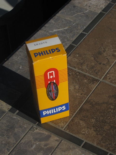

Many people really like the 5R4GYS rectifer tube.  It would require the larger diameter hole in the lid.  You can also use 5U4G and 5U4GB tubes.  The 5AR4 and all GZ34 tubes will not require a hole in the PS cover. No charge either way.

After speaking to Kristin and hearing her enthusiasm, I started doing some research and it seems that the 5R4GYS is considered to work very well with the ModWright PS. For right now, I am leaning that way (but boy are those things getting pricey).

It is true that they are getting expensive, but they are VERY good!

OK. I drank the Kool-Aid.
It turns out that Upscale Audio is just off one of the Freeways I take on at least a monthly basis. After trading a couple of emails with Jared, I decided to just stop by on my next trip through and pick one up. (I get paranoid about the shipping. After talking with Jared about how they ship, I won't be for any future orders) .
Went with the Cryo-ed option.
Getting anxious (again).
Patience...... :green:

Right on!  Great rectifier!

Busy working here....Modified Sonica DACs rolling out the door and UDP-205 final mod PCBs arriving early next week!

UDP 205 players stacked to the ceiling, beside another stack of Oppo Sonica DACs!
Both are SHIPPING NOW!!!
Please call if you are interested in scheduling a start date. We are soon booking into early July.
