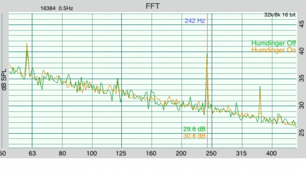

I got the HumDinger in place and made some measurements. These are close-microphone measurements right on the Toroid, which the noise I can hear if I stick me ear up to it. Green trace is no HumDinger. Orange is with it in place. The three spikes I see in the trace, which are the audible components I hear are unaffected by having the HumDinger in the circuit path. (This is with following the instructions, with the two plate amps plugged into the HumDinger outlets AFTER the power conditioner.  That would indicate to me that it isn't DC in my AC line but rather something else.

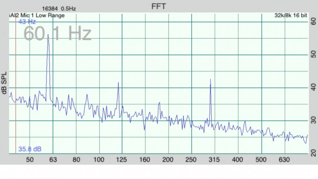

Also here is a close mic of the acoustic hum/buzz that is coming out of the Super V subs.

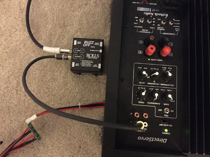

Then I tried the Rolls BuzzOff ahead of the A370 input and...the Hum is drastically reduced and no longer can be heard unless you stick your ear right up to the woofer.
The audible 60 Hz hum (from my listening chair) and the annoying harmonic buzzing are gone from the left speaker now that the BuzzOff is in the signal chain. I just ordered another one to put right by the right amp.
Either way. $80 for a pair of these and an extra pair of interconnects to solve this problem. I'll have to do a measurement later just to verify the reduction, but the ears don't lie.

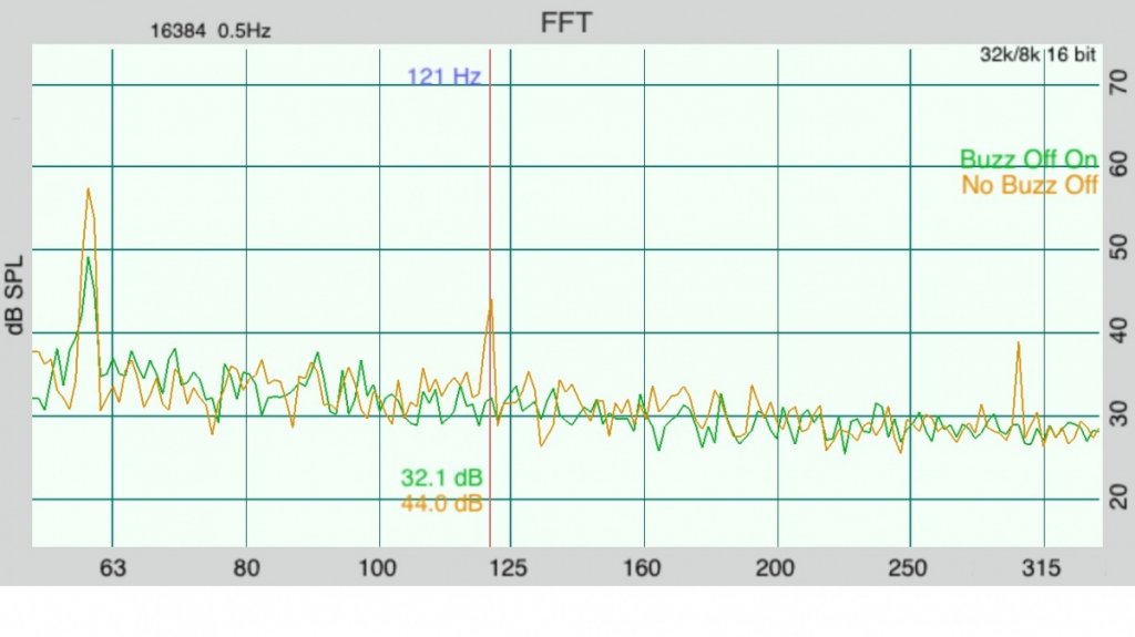

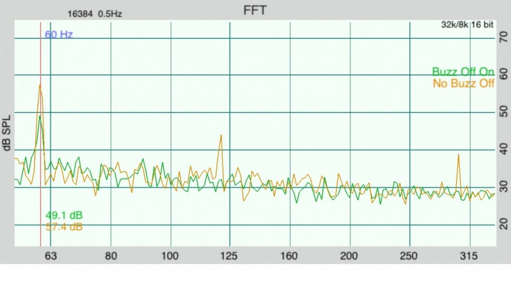

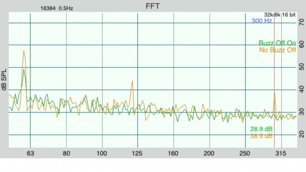

Some measurements with and without the Buzz Off. The 120 Hz and 300 Hz components are what has been really cut down, which are the ones that are audible my my listening chair.
60 Hz -- 57 dB -> 49 dB (8 dB)
120 Hz -- 44 dB -> 32 dB (12 dB)
300 Hz -- 39 dB -> 29 dB (10 dB)
The 120 and 300 are in the background noise and are basically half as loud. The 60 Hz component is still there, but I think that is just coming through the tube amp, not because of the ground potential trough the RCA interconnect.
I can no longer measure an impedance between the ground of the safety ground on the power cord and the ground of the rolls input (which makes sense since there is an isolation transformer in there).
