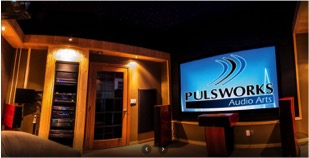

BRYSTON MEMO
May 2017
Hi James
The Bryston Active Speaker Demo Show was fantastic!
The Bryston room was packed all night with many people exclaiming that they had never heard anything like this in their life! With the striking of the bass drum in the Finale of Stravinsky’s Firebird Suite many people were in disbelief at the impact of what they just heard.
So many people dropped their jaw, eyes wide open, some shouting out “Yea!!!” very loudly, and others simply sitting speechless as their pant legs rustled with the sonic impact.
It was an experience and a delight to behold. It was a great evening!
Thank you for helping to make the evening a very memorable one for more than the 150 people that came out. This was the first time that any of those present heard an active system—a whole new experience in itself.
I even have a few clients tell me that they have never heard anything like it. I think that it is likely that at least two people will upgrade their Model T’s to active.
Again, thank you for a great evening of music at Pulsworks.
David Puls
Pulsworks Audio Arts

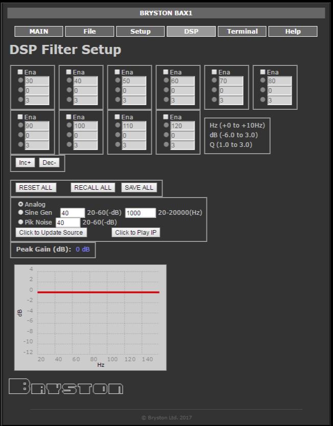

SUBJECT: Bryston BAX-1 Digital Crossover GUI
May, 2017
Hi Folks,
Please see below the GUI that is available with the new Bryston BAX-1 Digital Electronic Crossover.
Most room problems occur below 120Hz due to standing wave issues.
The BAX-1 GUI allows you to modify the factory preset  frequencies from 30Hz to 120Hz in 1Hz steps. You can also enter any frequency you wish and make the same adjustments.
You can ‘increase’ the gain a maximum of  3dB or ‘reduce’ the gain by 6dB in 0.1 increments at the frequency chosen.
You can also adjust the ‘Q Factor’ in 0.1 steps. The factory setting for Q is ‘3’
The Red Line in the graph at the bottom indicates the changes you are making.
After making the appropriate adjustment just hit SAVE.
James,
Is the GUI accessible from an IPAD.
James Tanner
  • Posts: 20959
  • The Demo is Everything!
    • http://www.bryston.com
Re: BRYSTON ACTIVE SPEAKERS
« Reply #24 on: 5 May 2017, 05:36 pm »
James,
Hi Adol,
Yes any handheld or computer - just type in the IP address of the BAX-1
james

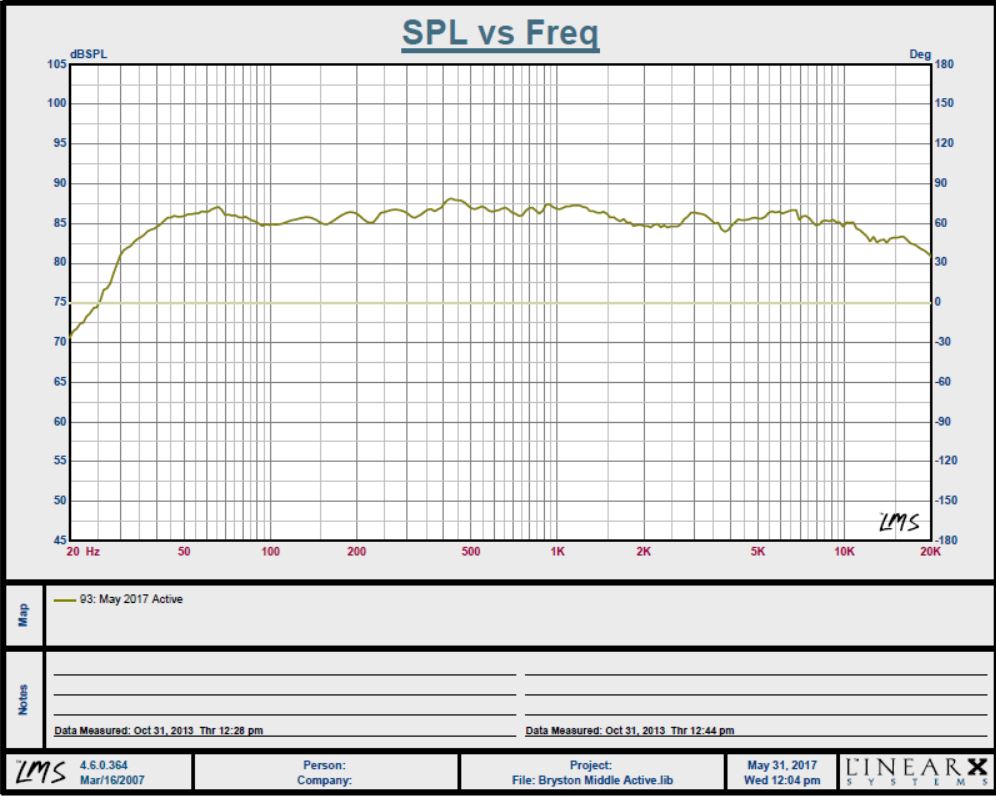

Hi Folks,
Here is a graph of the listening window on the new Middle T Active speakers with the Bryston BAX-1 Digital Crossover.
james

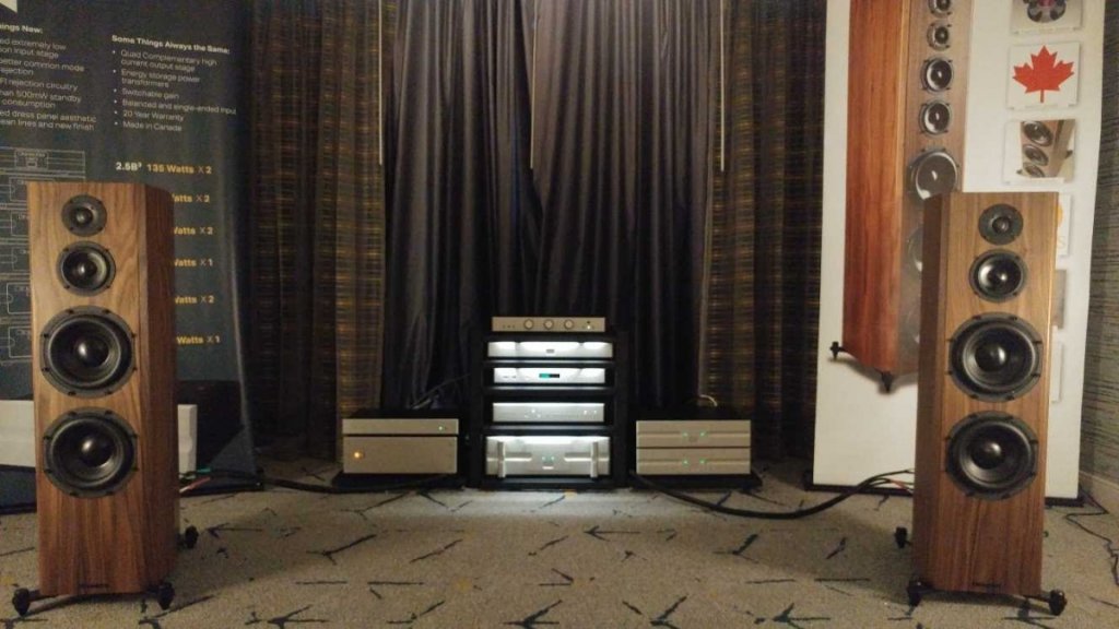

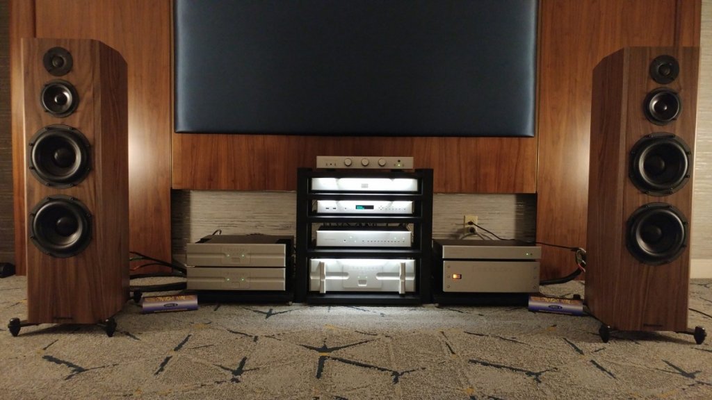

Hi Folks
Our setup at the LA Show - Active Middle T's.
witchdoctor
« Reply #33 on: 2 Jun 2017, 04:02 pm »
Hi Folks
Looks great, did you partner with anyone for your room?

« Reply #34 on: 2 Jun 2017, 06:08 pm »
Hi
I am not sure as Gary Dayton is running the show.
james
