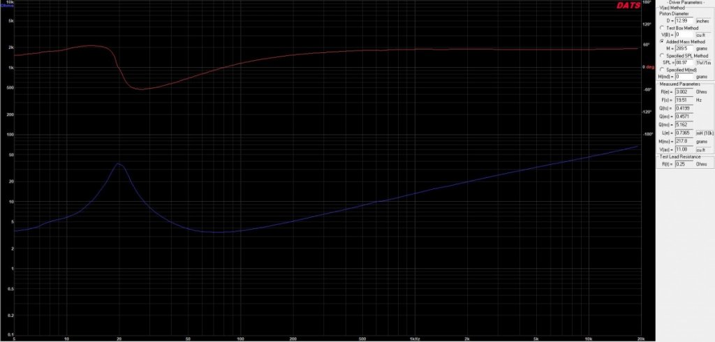

« Reply #19 on: 7 May 2017, 08:14 am »
I got the Dali drivers and measurements looks quite alright, I believe.
