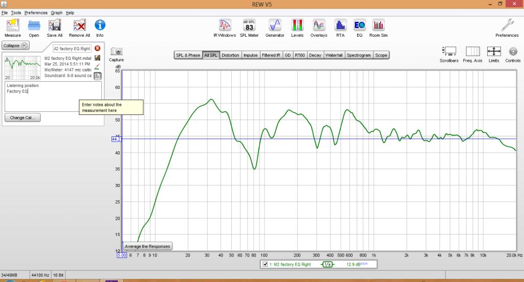

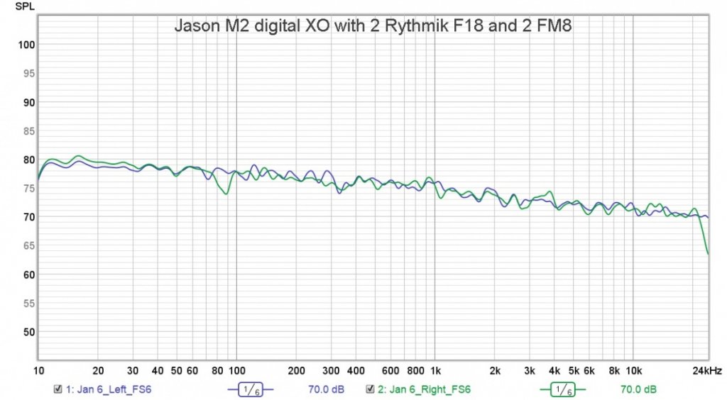

I decided to change the rear subs.  These are the new results which aren't bad.   :green:

« Reply #524 on: 7 Jan 2022, 03:38 pm »
"Looks" good.  :wink:
Reminds me of https://www.audiosciencereview.com/forum/index.php?threads/an-enticing-marketing-story-theory-without-measurement.7127/page-32#post-242115.
Btw, how does it sound to your 2 ears/brain binaural hearing?
cheers,
AJ

« Reply #525 on: 7 Jan 2022, 04:01 pm »
cheers,
AJ
Phenomenal.

Re: My Harman (JBL M2) Trip
« Reply #527 on: 7 Jan 2022, 05:26 pm »
Phenomenal.
Good for you! All that matters.
Subs in mono?
cheers,
AJ

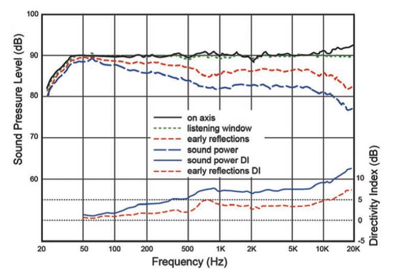

« Reply #528 on: 7 Jan 2022, 06:35 pm »
Wow Jason! What are your room dimensions if I may ask?
Wow is right Marty, never mind the dimensions, it's near perfectly reflective of a non-coincident monopolar box radiator!
Consider, his M2 have near perfect native (anechoic) "direct" response (top Black line), lateral off axis and then a bit of a dip vertical due to non-coincidence (blues and reds):
When placed in a more typical room like yours and mine, with varying degrees of reflectivity and lossiness of surfaces, openings, etc regardless of dimensions, measured with a pressure only sensor (no velocities) like an omni mic, at a single spatial position like the listener seat, M2s may look more like this:
I know, scaaary! To the eyes. And a pressure sensor mic. Luckily, with exception of the peaks <500hz or so, not to 2 ears and a brain. Which very very much unlike the single mic, can separate the "direct" streams from the reflected "sum totals" in the measurement.
To get a near ruler flat slope top to bottom like Jason >500hz or so, one needs a near perfectly reflective room. Or significant distortion of the "direct" native response of the speaker (s). Below 500hz or so, the ears do start to "hear" more like the mic, at least amplitude wise, so cutting those peaks are highly advisable. Filling the voids at that pressure point, where energy is being stored, might be debatable, since elsewhere, spatially, that cannot be. Now of course Jason is using multiple subs, with the EQ, so the averaging has created some smoothing by itself. But most likely by correlating the bass to mono. perfect for pop etc music. For decorrelated bass, like in any acoustic music concert hall, etc, maybe not so much.
Btw, what are your room dimensions?  :wink:
cheers,
AJ

jtwrace
  • Posts: 11431
    • TIPP YouTube Channel
« Reply #531 on: 8 Jan 2022, 12:51 am »
It's an odd shaped sized room.  Say 20' x 20' x 9' with some out-coves etc.

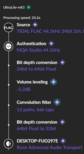

AJ
Feel free to drive 2ish hours north to listen.  Yes, mono.  So Left is 6ch and Right is 6ch and that's why it shows 12 paths.

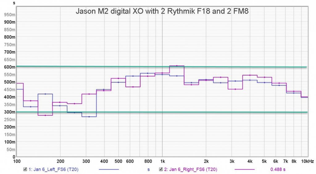

I was asked privately if I had RT60 measurements so thought I'd share it here.
REW Explanation here.

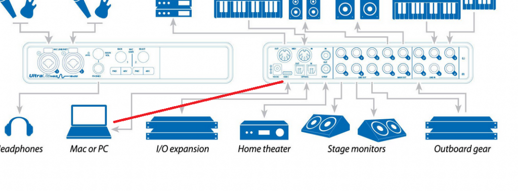

I had to decide on how I wanted to handle the MCH DAC and Roon Core setup. I built a W10 NUCi7 connected directly to a Motu UltraLite Mk5.
W10 i7 NUC > Roon (Audiolense Filter) > Motu UlatraLite mk5 > (2) Hypex NCore NC502MP > JBL M2 Master Reference +4 subs
Hi Jason - can you elaborate on this piece please?
What is the method of connection here from the computer - there are 8 independent channels of digital outputs going into the Motu dac?
What kind of soundcard is doing that for you?

« Reply #537 on: 28 Apr 2024, 11:52 pm »
Oh wait - maybe this is just a usb connection?
Just saw the graphic...
