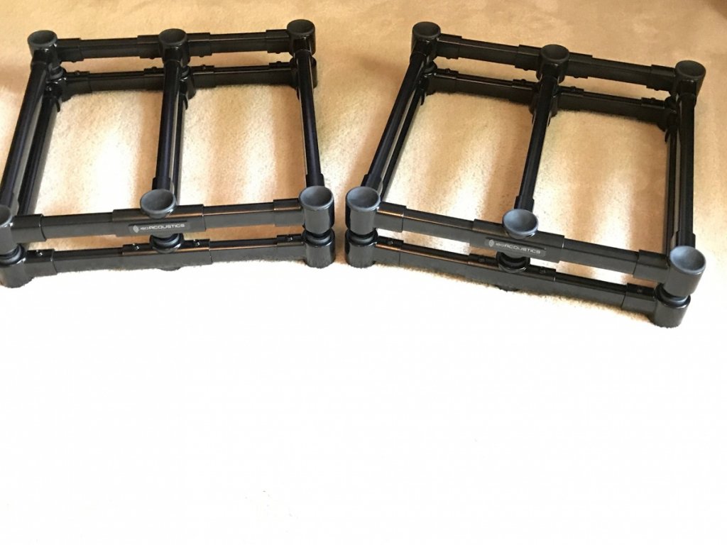

jtwrace
  • Posts: 11432
    • TIPP YouTube Channel
Re: My Harman (JBL M2) Trip
« Reply #151 on: 29 Apr 2017, 03:29 pm »
I did get some more done though.
Got the wire all hooked up to the amp end and labels installed
Finally, sub stands put together too!
