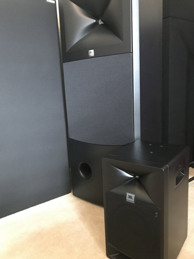

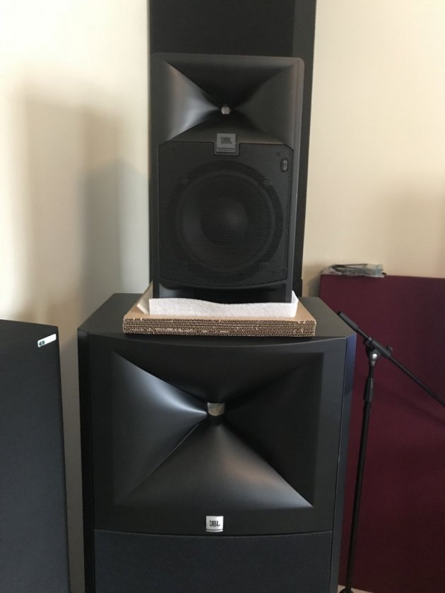

They have arrived!
goskers
  • Posts: 419
Re: My Harman (JBL M2) Trip
« Reply #389 on: 22 Jan 2018, 04:14 pm »
Cute little bastards.

Those are the 708P actually and not for theater at all.  Why not!?!?!

These are currently next to my M2's.  I was blown away with them when I was in Northridge and knew I wanted a pair for a few reasons.
