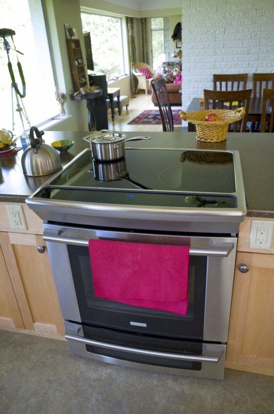

Russell Dawkins
Re: Induction Cooktop
« Reply #7 on: 14 Apr 2017, 11:54 pm »
My Dad has one of these cook tops at his mountain cabin and I hate it. It is similar to electric coils in that it doesn't cool down very fast so you have to move the pot off of the burner to stop the food from cooking.
I don't think this can be an induction cook top.
One of the major benefits of induction is that it does cool down instantly—as fast as gas—because all that is heated is the metal of the pot or pan. The glass beneath is heated only by the metal of the pot above. Most glass-topped stoves are heated by resistance elements below, and these are slow to cool, like most electric stoves. Professional cooks like induction second only to gas, typically. For commercial use, gas wins by being more robust in use and easier to clean. For accurate low temperature cooking, like sauce making for example, a good induction stove is so good you can dispense with the need for double boilers.
When we're boiling a liquid and boiling temperature is reached turning the element off results in instantaneous reaction; bubbling stops instantly.

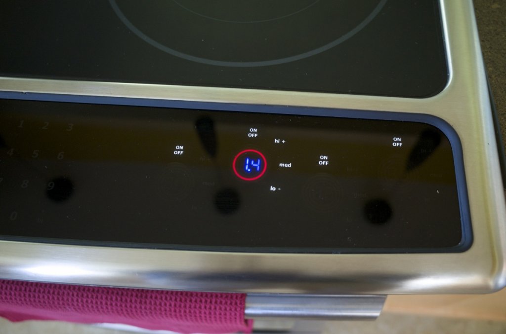

Cooktops vary in fineness of control, of course. Ours (an Electrolux http://www.thebrick.com/product/item/appliances/kitchen/ranges/electrolux/electrolux-30-electric-range-with-induction-cooktop-stainless-steel/1642493) has very small increments of heat control near the bottom of the heat range—1.0, 1.2, 1.4, etc.—increasing in coarseness as you go up in temperature.
I am not recommending this model though due to two factors:
1. after 5 years the touch control circuit board appears to need replacing ($120 part) as it is getting a little quirky, and
2. the oven is puzzlingly slow to come up to temperature

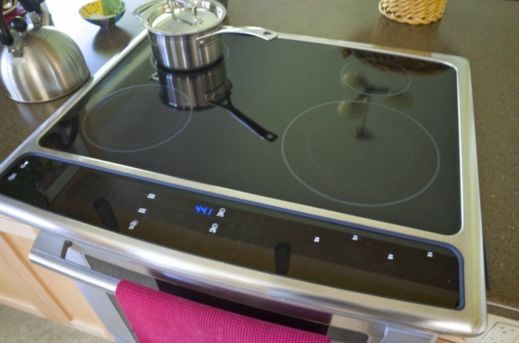

Having said that, we really do enjoy using the unit and it is easy to keep clean—much easier than a conventional glass top stove where the glass gets really hot. On ours, you can boil a pot of water, take the pot off and immediately touch the glass. It's hot because the bottom of the pot was hot, but you won't get burned with a quick touch.
Additionally, we had to have a relatively expensive wiring upgrade to the stove as the installation specs called for a heavier wire than was in place for the conventional electric stove that it replaced. 10 gauge in place of 12 gauge, if I recall, requiring a minimum 40 amp circuit.
I see your stove top is 120 V and 1800 watts max, shared between two elements, that is 1800 watts total at any one time—so if you need one element to run at 1800 watts, the other must be off, or you could run 900 watts on each element simultaneously. At 120 V, 1800 watts is 15 amps which is typical for a household circuit.
Here's the stove top after 6 years of use. No fancy cleaners, just general purpose cleaner, a damp sponge and drying with a microfiber towel.
