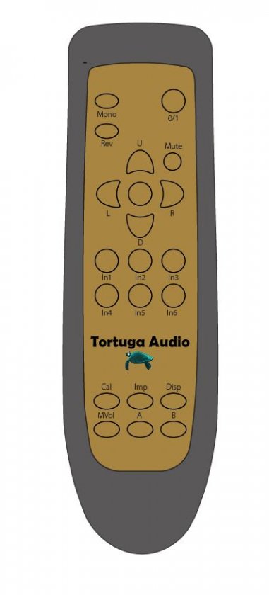

I'm pleased to announce that we are coming out with an updated custom Tortuga Audio remote that will take the place of the Apple Remote!
The simple truth is that the Tortuga Audio preamp controller has outgrown the Apple Remote. As more features were added, navigating the controls with the simple generic Apple remote became more challenging. I'm convinced that the new Tortuga Audio remote will make controlling our preamps easier and more intuitive going forward.
When it's released the new Tortuga remote will work with both the new V25 controller board as well as our existing line of preamps built around the V2 controller (after a to-be-released firmware update to the V2's).
Artwork rendering of the new remote is shown below. What isn't obvious from this artwork is that the brown keyboard inlay is actually cherry wood veneer which lends a warm organic feel to what is otherwise yet another plastic remote.
The control pad/function list is currently as listed below. If you have questions or suggestions for changes/additions based on your experience with our preamps please post your thoughts on this thread.
0/1 - power on/off toggle
mono - mono mode on/off toggle
rev - reverse polarity on/off toggle (for balanced units wired appropriately)
mute - mute on/off toggle
L - left
R - right
U - up (raise)
D - down (lower)
In1 - input #1
In2 - input #2
In3 - input #3
In4 - input #4
In5 - input #5
In6 - input #6
Cal - calibration mode
Imp - impedance mode
Disp - display mode
MVol - max volume on input change
A - options
B - options

Morten, great. I've been waiting for it and thought you might have put it on the back burner indefinitely. My problem with the apple was that I kept losing it, it was so small. I fixed that by taping it to my CDP remote. Looks weird but it worked. The Mono switch is a great idea.

Looks like a nice remote, and while I'm likely to buy one, the little Apple remote works well for me.  I don't change inputs ever, and my settings have long been dialed in.  You did a decent job on the last remote changes.  My only complaint is that I can't seem to shake the want to press the center select button to turn the preamp on.
P.S.  The inlay should be black or faux brushed aluminum...  :wink:

Looks pretty good. From a designer's perspective, I'd remove the "L,R, U, D" letters. They're redundant and only add visual clutter. Anyone buying a sophisticated electronic device should know how to use a directional pad without the use of "L,R,U,D" printed on an otherwise nice remote. I'd also put the power button in the upper left. That's naturally where we're taught to start reading something (in the written sense), so this learned behavior has carry-over to input devices like remotes.
Just giving you some critical feedback. :D
