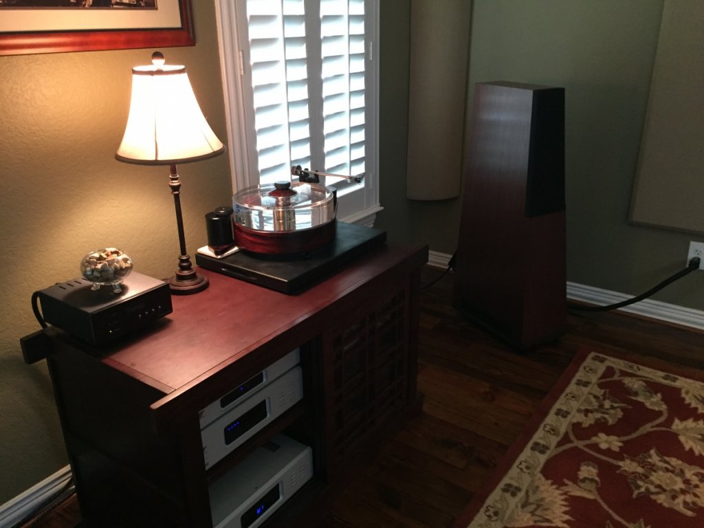

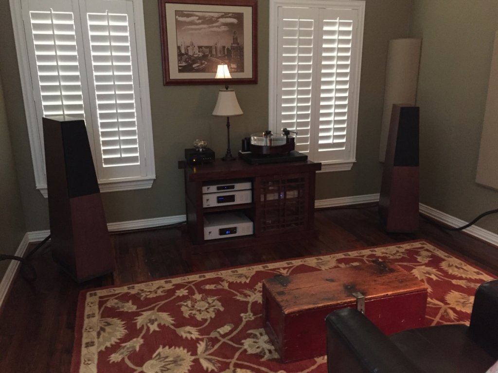

Since we're sharing photos, here's a couple shots of my Quatro CTs (mahogany walnut).

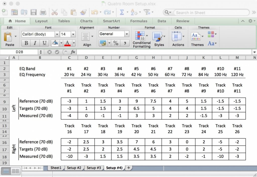

The Vandersteen directions for setup are pretty good. There's a few things that, when explained, makes things much easier.
First, you really need to make yourself a spreadsheet to help keep track of things. Something like this...
Second, don't touch pots #9, #10, and #11. They're too close to the crossover point. Just leave them alone. Don't do it.
Third, it helps to conceptually if you think about the listed pot frequency as the high-point of a bell curve (and changing a pot will impact the frequency response of AT LEAST the pot above it and the pot below it). Start with the pot associated with the frequency of largest deviation, change the frequency response by only about 1/3rd of what you think is necessary, and the remeasure all frequency bands. Repeat. You may go back to the same pot, you may tackle a different pot. Let the measurements guide you.

Thank you nrenter for you detailed information about tuning the bass. I think the dealer had a chart with him similar to your spreadsheet where he recorded measurements but I don't think his tuning process was as comprehensive as yours. Also he didn't leave the measurements with me. Just out of curiosity I think I will try taking the measurements as they are now just to see if I understand how to use the sound meter. I may have more questions.... I am a little disappointed that the dealer didn't take the initiative to show me more of the details...but I should have asked more questions and insisted that I understood the process before they left. I suppose I could get him back out here to do it for a fee or maybe I could go in to the dealer showroom and have them walk me through the process there.
