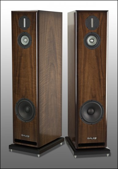

What would be involved in creating a Silk AT Tower?  I am intrigued by that or an AT version of the Song3 (with the RAAL).  In particular, I think the efficiency pickup would be useful, and as a subwoofer user I wouldn't really miss that few hz of bass extension.

We already have a design that is quite close.  It is a Song3 with an AudioTechnology midrange and a beryllium tweeter.  About a year ago, we did a version of the SoundScape 8 with the same beryllium tweeter and compared it to a pair with the RAAL tweeter.  It was very difficult (bordering on impossible) to hear any difference.

 :thumb: I happen to have a pair of these speakers and can attest to how wonderful they are.

Very happy with mine and i see no reason to upgrade for years to come mine is in gorgeous curly walnut BURST.
