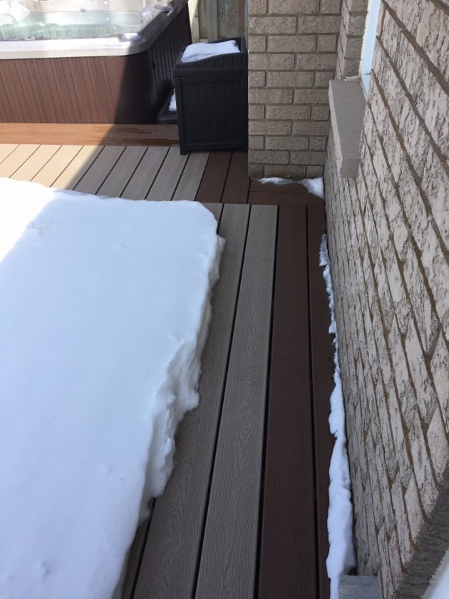

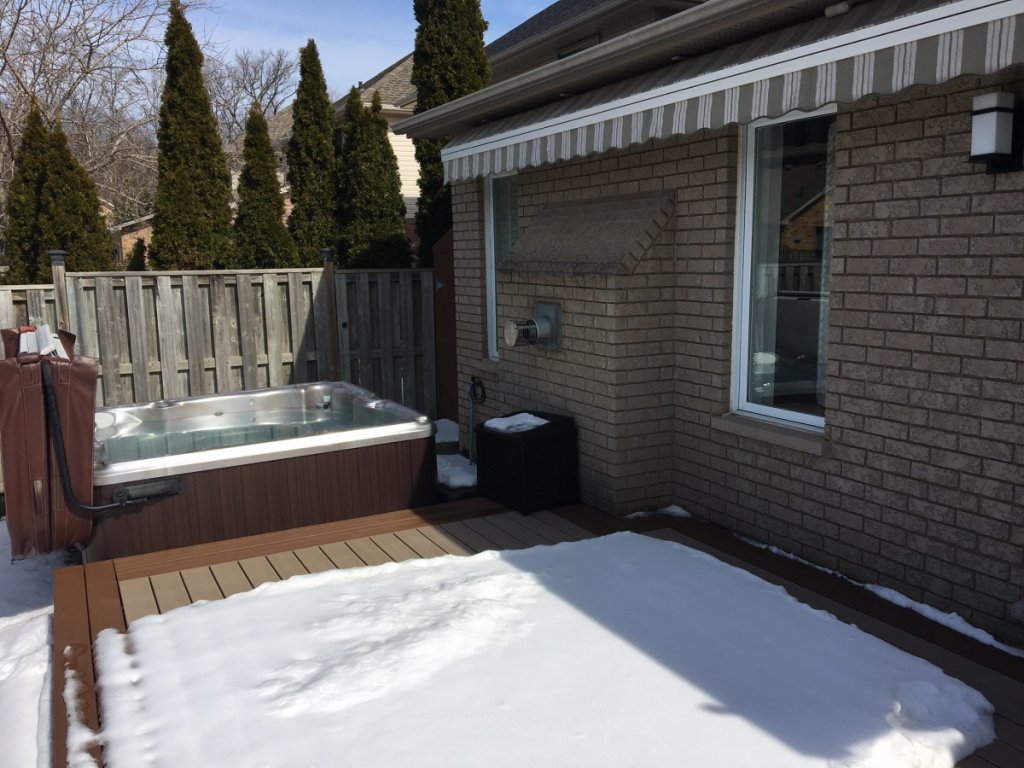

The Trex pictured has been shoveled every time it snows for the past 3 winters.  No damage I can see.  I do use a plastic shovel (vs steel) mind you.
The lighter color is called rope swing, and the darker is saddle.  The saddle can be hot to the touch when in full sun.  The rope swing is great underfoot.  Most of the time I have our awning out if I am on the deck.
Over a winter it can develop a little dirt and sometimes green haze.  In the spring I spray Simple Green on it (full strength) and scrub it with a brush on a broom handle.  Then hose off with standard water pressure from the garden hose and it is looking good for the year.
