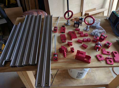

Here is the X-Y Assembly as it looked out of the box before putting it together. Some assembly required indeed. There were NO assembly instructions provided.

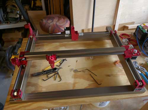

Here is the X-Y Assembly after most of the parts are together. The laser tube is still missing. It gets mounted along the back side.

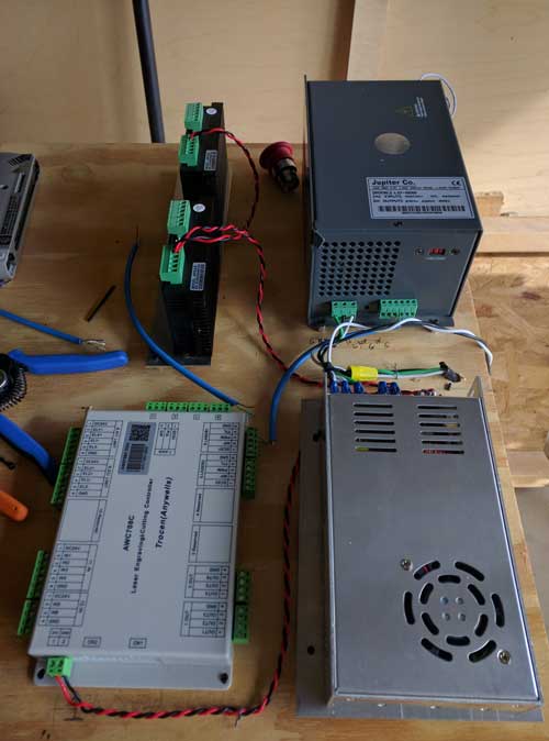

Here are the power supplies, controller, and stepper motor driver boards installed and partially wired.
