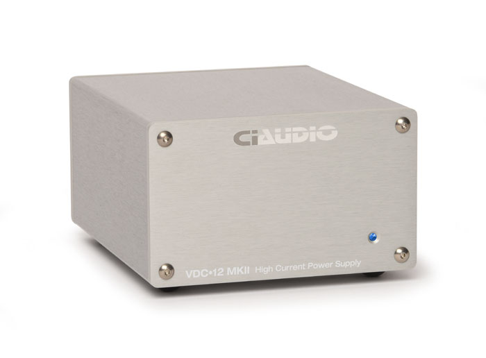

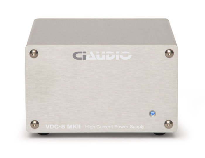

We now offer our VDC•MKII linear regulated DC power supplies in 4 different output voltages (5, 7, 9, & 12V).
These can be used to replace noisy switching supplies that come with many audio products.
Contact us with any compatibility questions.

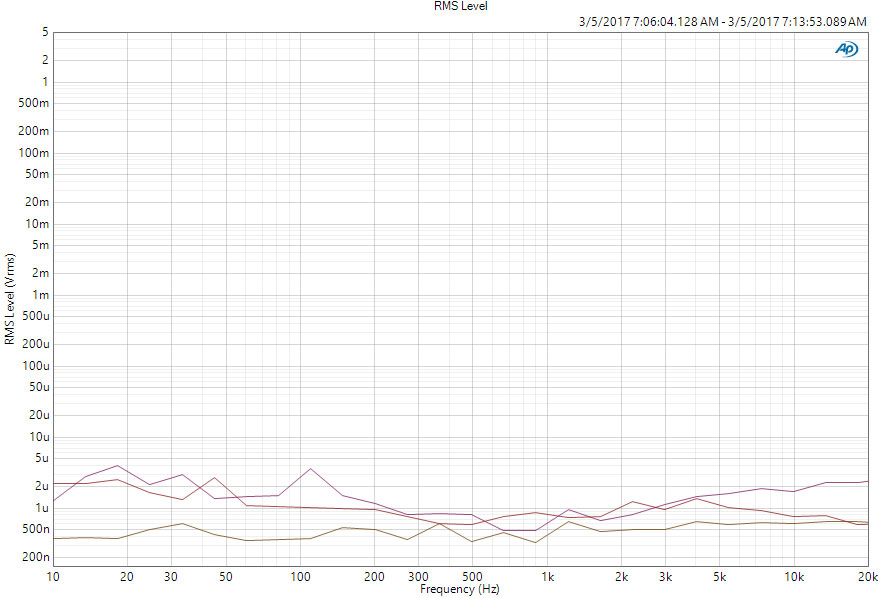

Still haven't finished the website update but here is a graph of VDC•5 MKII noise from 10Hz~20kHz.
Brown line is the Audio Precision measurement threshold.
Red line is the VDC with only AP input as a load.
Violet line is at full load just before regulator drop out.
