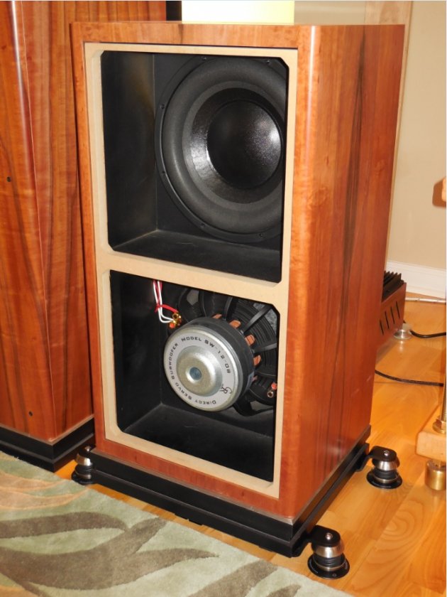

hey  folks, just a quick follow up  on  this topic...
After trying  pretty much everything we could think of,   the customer went ahead and  ordered a set of Townshend Isolation Bars for his subs.   Here's  a copy of  his email:
"I just received my Townshend Isolation Bars and stuck them under my subs. My oscillation issue is 100% cured, even at the sub amps full volume! It doesn’t matter if the rumble filter is on or off or where I set the frequency switch or any of the controls. Highly recommended for all those vinyl guys with subs."
jay

« Reply #19 on: 13 May 2017, 01:48 am »
A set of the Townshend Seismic Pods (the things bolted onto the ends of the bars pictured above---they are available separately) are at the top of my list of "buy as soon as possible" items. They're not cheap, but they are worth their price. There is a new product that may give them some tough competition, the Isoacoustics Iso-Puck.
