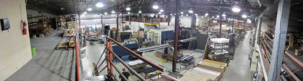

I wonder why Magnepan never went the "printed circuit board" approach, where a layer of material was deposited on the membrane. I had a pair of Carver AL III+ that used that technology for the mid/tweeter and it seemed to work pretty well.
They did build a facility for that purpose up on the second level of the factory -- I didn't get an interior shot but you can see part of the outside wall on the left in this shot of the factory floor, with a red fire extinguisher on it:
The reason they chosen not to do it that way is that they found that it was too difficult to make production changes. It's a good technology for small drivers like the Eminent Tech or the BG Neo 8 which require a lot of traces and/or can run hot enough heat to melt adhesive, but for larger drivers, it's more practical to use adhesive and wire by hand and most manufacturers of large planars seem to use that approach.
