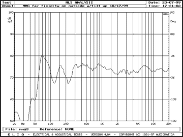

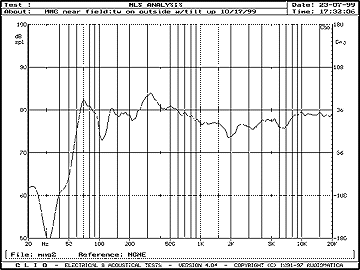

« Reply #36 on: 9 Feb 2017, 03:07 pm »
That's interesting. The curves in Dick Olsher's review also show a dip above 100 Hz, though not at precisely the same frequency.
Near field (1 meter):
Far field:
So maybe it is intrinsic to the speaker after all? You'd really need some outdoor measurements to be sure. But it seems to me it could have something to do with the acoustic equalization. The resonant sections in the left and right speakers are asymmetrical because there isn't enough diaphragm area to do complete acoustical dipole equalization in one speaker. So it may be that the left and the right speakers have dips in different and complementary locations?
