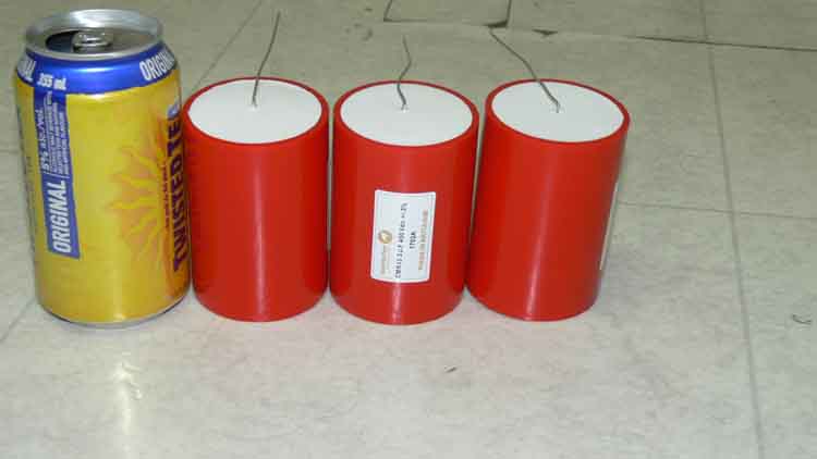

And  not only  are  those   good crossover parts relatively  costly, they are big so  you need some real estate !
Here's roughly a 100uF groupof the new Clarity  CMR series
jay

Those are some impressive Caps. I think I can find some that are still good, but not so voluminous.

Re: OB Sub Placement
« Reply #33 on: 9 Feb 2017, 02:31 am »
The Soniccap G1's offer great value and they are not so   "voluminous"  !
