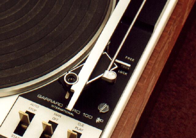

I had a friend with a Zero 100, it was a cool idea but didn't seem to work very well in practice. Probably all the extra friction and the lack of rigidity.
It used a pantograph arrangement I believe it was called.  (sorry to be slightly off topic)

i recently purchased one of these, used:
the idea behind it is that the headshell swivels to always insure zero-degrees tracking error.  well, this one doesn't work at all; it seems to track in whichever angle you first set the stylus down on the record.  taking it apart, it seems the bearings were buggered up; i reserve final judgment until i get replacement bearings installed.  i know art dudley & ian white like this arm...
