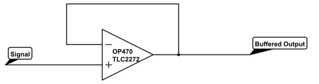

Where we're getting mixed up is in semantics. A buffer consists of an input stage and an output stage. This equals 1 buffer total. The STP-SE doesn't have two buffers. The buffer's input stage and output stage are merely separated (by the attenuator), probably because it is solid state which affords this type of circuit design. Tubes inherently do the impedance conversion / matching (their input stage and output stage are built together in the tube), which is why a tube buffer stage is either entirely before or after the volume control (in a buffered preamp)....but it'd be kinda cool if one could design an "input" tube an "output" tube to make a buffer design like the STP-SE. :thumb:

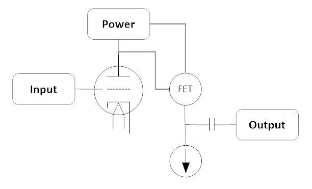

I agree this is partially a semantics issue. The confusion is compounded by the fact that there are buffers and then there are buffers. In circuit design it's very common to put a simple high impedance buffer at the input of say a preamp for isolation. Typical of such a buffer is a simple unity gain op amp as shown below.
A consumer reading a manufacturer's product description reads that the buffer product has a buffer on the input and the output. Wow, a buffer with a buffer at both ends. Technically true but the meat & potatoes high performance end of most audio buffer products is the output stage.
In the case of our 2 stage tube buffer you would be correct in describing the tube itself as an input buffer (with optional gain). The output stage is a solid state buffer. Taken as a whole, it's an audio buffer.

Interesting stuff Morten and thanks for further clarification. What you're doing seems pretty unique. I'm not sure I've seen another buffer that uses a tube as only the input stage....unless most tube buffer's are designed this way? I don't think they are.
tortugaranger
  • Posts: 1780
    • Tortuga Audio
Re: Tube Preamp Buffer - TOUR!
« Reply #36 on: 11 Mar 2017, 07:02 pm »
This is the conceptual design but like most things the devil's in the details. You can call it a 2-stage hybrid buffer or you can call it a 0 to +6 dB  gain preamp without a volume control - both are correct.

It's a gyrator concept.  I used a similar concept to build my preamp that uses DHTs (I have 16-18db of gain though).  Mine was based on the work of Ale of Bartola Valves.  I won't discuss more than that here, because here is not the place, but it is the best sounding design I have ever heard and mates very well with a passive attenuator.   I am sure the Tortuga version is amazing.
