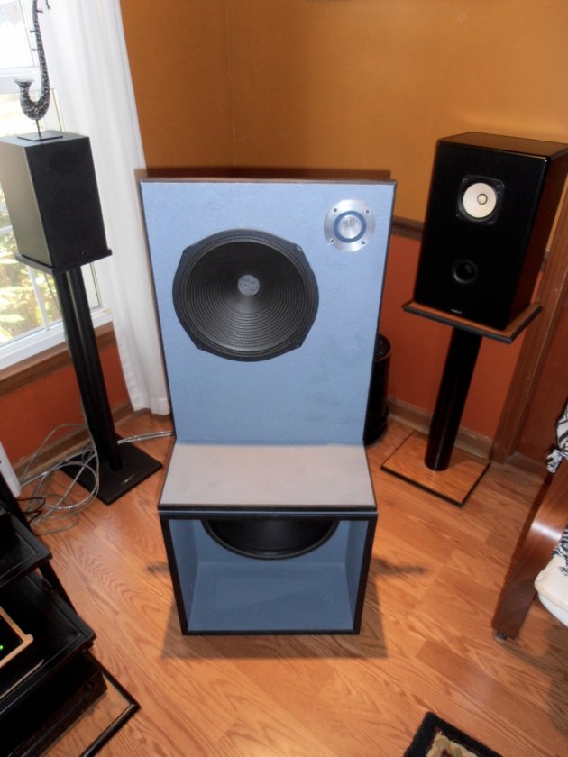

FYI, I have enjoyed your OB posts for quite some time Poultrygeist. I have the AN10s but I have also been playing with a handful of vintage 12-inch drivers from Zenith and Cleveland. These are pretty amazing for the price, they just need a little tweeter help. I think if we (and the GLOW blog) keep raving about these, the prices will skyrocket! I have a set of mule baffles (18 inches wide by 48 inches tall) and I can swap out various 12 inchers to see what I like. What has been most surprising is playing a pair of Zenith 12s in parallel with the AN10s in a psuedo line source array. The sound is stunning. I think it is the large wave launch and combined efficiency. It's all good fun and makes me want to try a 4-12 vintage line array.

12" Zenith alnico drivers ( circa 1958 ) over H-frame Alphas. These have the sweetest tone of any wide bander I've heard.
