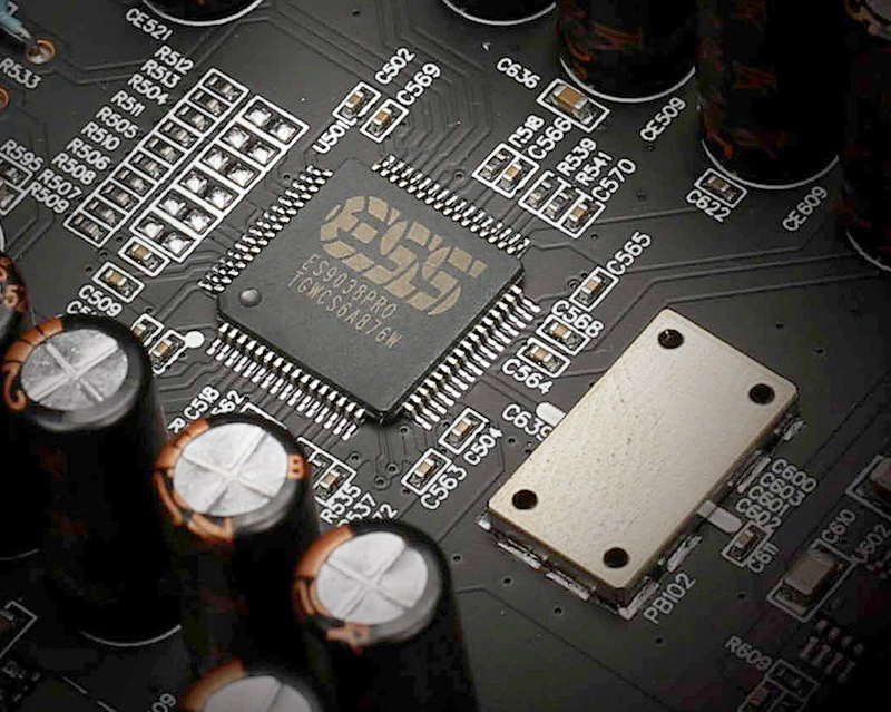

Coris
  • Posts: 7
Re: Oppo UDP-205! The New Truth Mod! The Next Level!
« Reply #28 on: 21 Jan 2017, 11:27 am »
It seems that Sonica DAC does not include the ES9038pro, but the simpler version of this new chip, ES9028pro... Or it may be something wrong with the marking of the ESS DAC chips, Oppo is using....
Coris
  • Posts: 7
« Reply #29 on: 22 Jan 2017, 11:34 am »
I found another more detailed picture of the DAC chip inside Sonica. There is about ES9038Pro...
Now is the question: why we have different marking for the new ESS DAC chips...?
Ric Schultz
« Reply #30 on: 23 Jan 2017, 04:50 am »
The markings on the 9026/9028/9038 that were first shown on the ESS website (and still there), etc. were from pre production samples.  Hence, no normal labeling.  All the ESS DAC chips look like the ones in the Sonica Picture, which include, what I presume to be batch/date codes.  You cannot tell the difference between a 9028 and 9038 unless you can see the writing....which is smaller than the pre production batches.
Coris
  • Posts: 7
« Reply #31 on: 23 Jan 2017, 08:11 am »
Thanks Ric for explanation. It make sense also...
As the pre production batch is known it came out with some issues, it may be advisable avoiding the use of that specific marked chips (which it could be on the market out there)...
