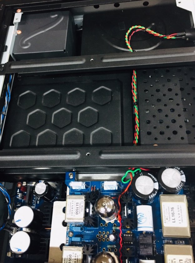

OK, digging into this today, after letting it burn in and getting used to it.
First of all, this thing is BUILT! I spent time yesterday, removing all of the covers and inspecting the transformer, drive, video processor and video supply.
1) The linear supply is powered by an EI core transformer, nicely made! This transformer is completely shielded!
2) The video processor is completely shielded and self contained.
3) The drive is not only completely shielded, but fully insulated against all vibration via soft damping material in apparently every axis! Never seen this before! It IS dead silent for a reason and this also equates to lower jitter and greater overall performance for audio and video!
4) The power supply for the audio circuitry is purely linear and all sourced from the transformer. The ONLY thing that is powered by the SMPS is the video circuitry. Even the DAC and all digital circuitry appears to be powered by the LPS for this unit!
DAC is 9026PRO from ESS (SABRE)
As expected, I-V, gain/buffer, filtering and summing circuitry for XLR-RCA outs are all accomplished by Burr Brown op-amps. Good op-amps, but I am not a fan of them. I don't like op-amps because they are inherently feedback based devices. I prefer Class A tube circuitry with zero feedback, typically aided by inductive reactive devices such as chokes and transformers. To my ears, the purest sound is achieved in this way!
I am next going to look at how best to take the audio signal from the SABRE DAC, without the use of any op-amps. I expect this input circuitry will be similar to how we achieve the same result from the Oppo 205 mod. Why? Because it SIMPLY WORKS and sounds amazing with very low noise floor!
More to come, but I wanted to share my thoughts here.

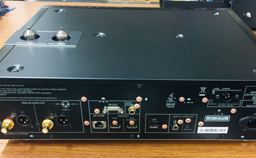

Sorry guys, have been away from the site for a while. I got a unit from the UK.
I have now installed a tube analog stage in the first unit and it sounds fantastic!

This mod is complete and the first will ship Friday!
I ended up using the UDP-205 tube mod because it simply works! The LX-800's use of the SABRE DAC chip and fully balanced outputs proved to be ideal.
Now the frustrating part: It is not and will not be available in N. America at 120V! This has been confirmed!

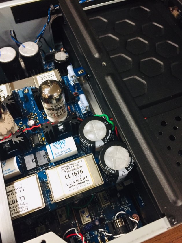

I used the exact same mod circuit as we implement in the Oppo UDP-205 mods. It is fully balanced in to out and features a well regulated, tube rectified external power supply.
Because the Pioneer uses a SABRE DAC chip (different than in the 205), the interface to our mods was the same. I did have to adjust the gain a bit because the DAC in the Pioneer had greater current output levels.

The analog stage PCB is also laid out on a 6-layer PCB, so an excellent job of shielding and noise suppression is obviously done here also!
