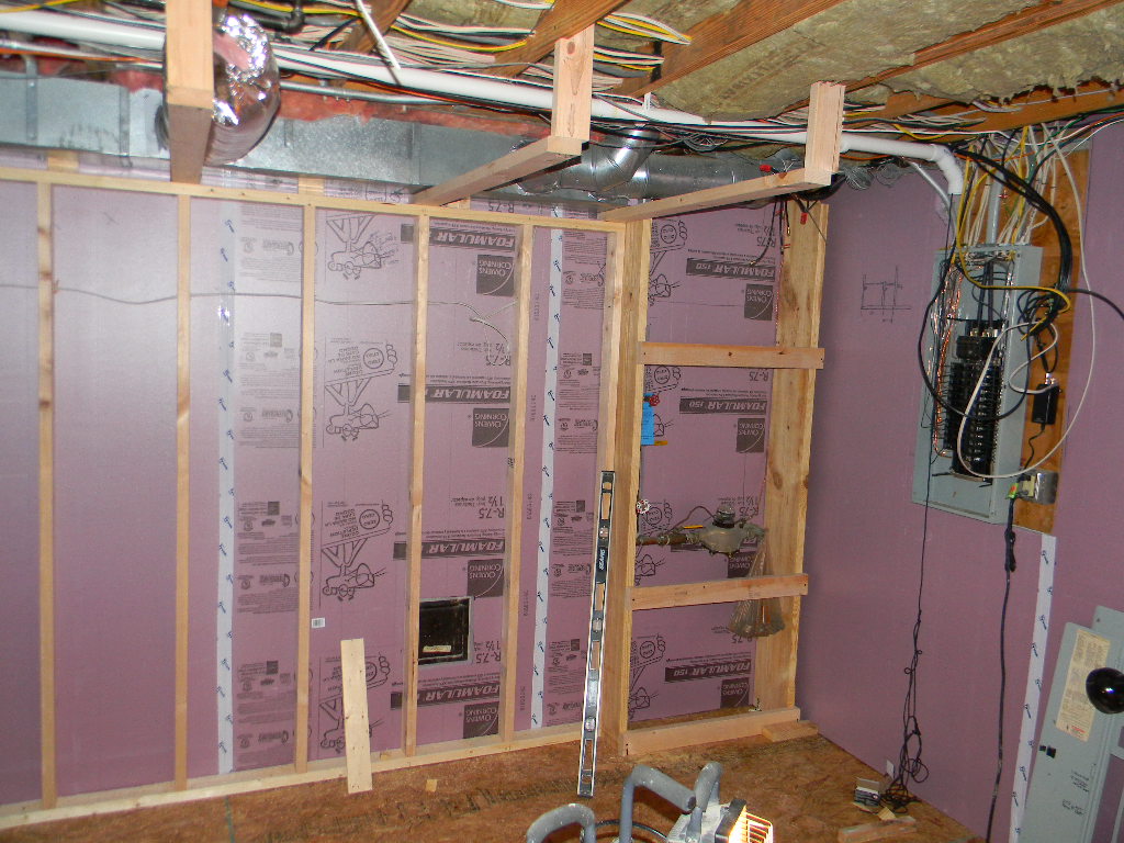

Are you building a bulkhead around the trunks at all?
When we finished our basement, I knew I would have a large bulkhead running the full length of the space.
I put Roxul Safe n Sound in the joist bays of the ceiling.  I used the cheaper pink to completely fill the bulkhead.  Before stuffing the bulkhead, if I snapped a finger against the trunk of HVAC it would BONG.  After stuffing (I think I used 4-5 bags of pink for the 20x5x15 inch bulkhead) it makes a dull "tick".
Much better.
But only useful if you are building a bulkhead.  Otherwise the Dynamat type stuff is likely the best bet for the exposed trunks.
Here is a shot when I was around halfway done.  The 2 conduits were installed to make future PJ easy.
