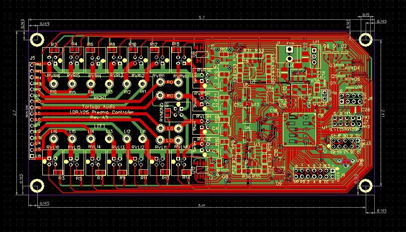

The V25 is now fully cooked and production boards have been ordered.  :thumb:
As I was finalizing the layout I took another look at the OLED 2x16 character display and decided I wasn't totally thrilled with the look of that display compared to the fully graphic OLED display I'd been using for the V3 board. After some late night editing I was able to add an optional 14 pin header that will allow the V25 to use the graphic OLED display. It still retains the potential of using a character based OLED display but I suspect I'll end up focusing on the graphical version. The programming for the graphic display is way more complicated, uses way more memory and requires a fast processor but the V25 has the horsepower and capacity plus most of the really hard graphic infrastructure programming is already done. To make room for the new 14 pin header, I changed the USB port from a simple 5 pin header to a vertical mounted micro USB type B socket which has a much smaller footprint.
Thus, the first production V25 board will now have the option (in terms of hardware) of driving a 7 segment display (our current display modules), a character based OLED display, or a higher resolution graphic OLED display. It also has the option of plugging in a WiFi module.
Final changes included a larger linear regulator to handle the added WiFi and display options. Also added an optional input/output pin header for direct connecting to  I/O jack boards.
The final board size grew 0.2 inches in length to 5.7 inches wide by 2.7 inches tall.
 That's it. Done and done. We'll have V25 boards in house in 2 weeks (or less) at which point we expect to begin shipping.

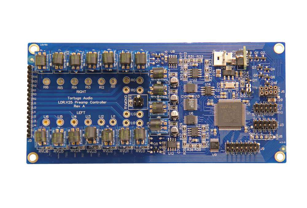

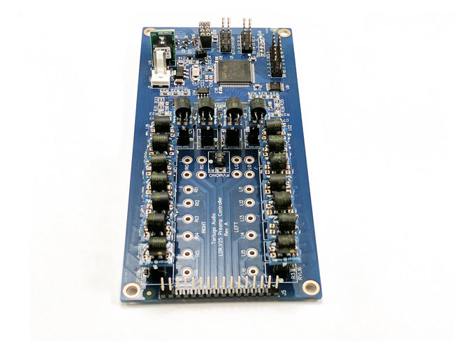

« Reply #56 on: 21 Apr 2017, 09:23 pm »
Here it is at last, the first production board of the new LDR.V25 Preamp Controller.   :thumb:
The board in this pic has a full complement of LDRs installed except for the Mono switch.
