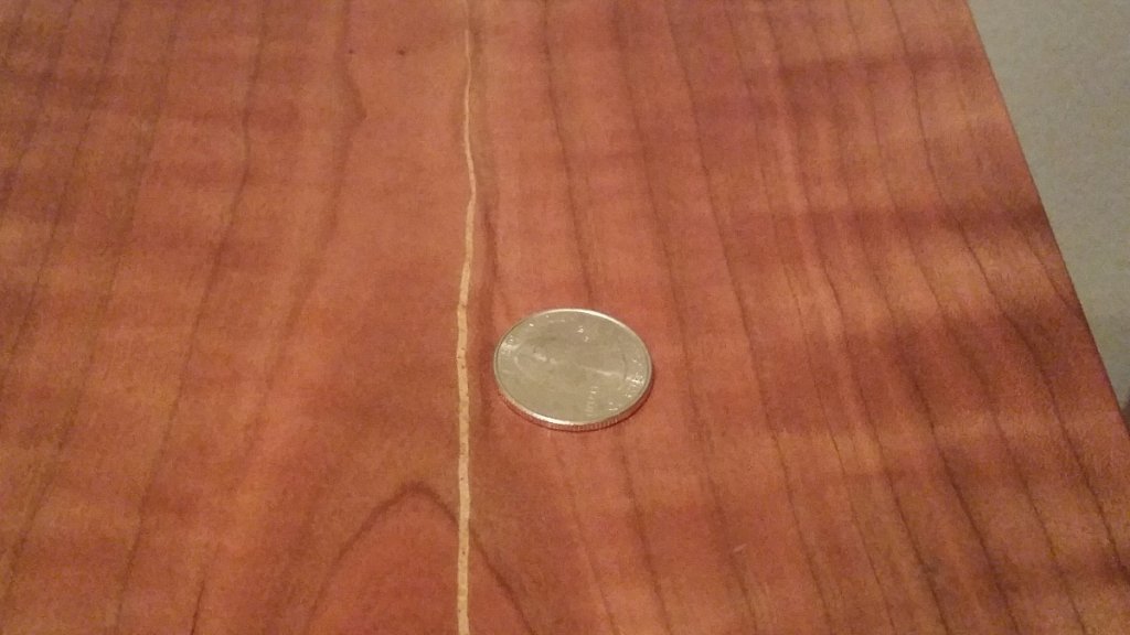

A picture is worth a thousand words...
Here is a piece of raw cherry I used with "Heatlock"...  You can see the LARGE split just to the left of the quarter.  My experience was similar to Mike's... this did not split until the wood was cooling after I ironed it onto the top of my N3 tower speaker.  This was the only veneer panel that split on my N3's, but boy did it split!  Side note...The N3's I made are largely based on the attractive N3's you made five or six years ago.
If you are set on using that very nice burl, I would vote for contact cement.
Pete

Hey Pete, I remember your build, they look great.  That is exactly the type of splitting I had with the maple on my V1s, the Sapele on the same build did not have any splitting.  I thought it might have been that I was using too much heat, but there was more Sapele than maple on that build, so it wasn't the heat.  I could use contact but that stays where it goes down, for some of this build I will need better control than that.  I don't have a reasonable way to use cold press, it appears it would have to be clamped in some way, so heat lock it is!  I am hoping the softener helps prevent the splitting.
Best,
Ed

Ed, I will cross my fingers that your burl comes through without splitting... I used softener with the raw cherry that split.  I certainly don't have enough veneering experience to know which pieces of which species are prone to splitting.   I will anxiously await pictures of your build as it progresses!
