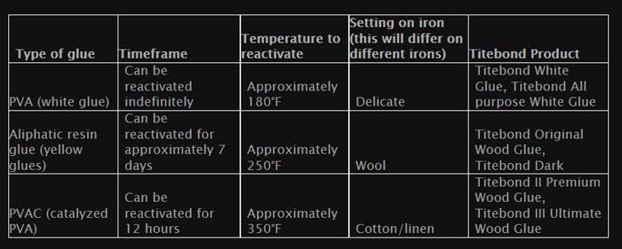

Here's a little table I found online. While it's  related to titebond products, you should be able to cross ref  the type of adhesive you are using I've also been reading than when using raw vener , it can be a good idea to  apply a coat of shellac to te  the backside of the veneer and letting it completely dry before applying  the adhesive, this can help prevent the possibility of bleed through
Looks like your cabinets are coming along nicely Ed :beer:
jay
Thanks for that Jay.  With regard to the shellac, are you recommending putting it on the side getting the adhesive?  If so, I wonder how this would impact the adhesive effect of the glue to the veneer?  Of course I could only apply it to the locations with the occlusions, there aren't too many so I am not too concerned about them.
I'm not Jay, but I did talk to Joe about fillers when I was doing my build.  I was concerned about imperfections in the substrate telegraphing through the veneer, so I asked Joe about suitable fillers.  I was thinking Bondo, but Joe recommended against it saying that it's important that the moisture from the glue and veneer softener be able to diffuse into the substrate.  Given that I'd recommend against shellac on the substrate.  I ended up using sawdust and PVA glue to fill the divots.  Seemed to work well.

Hey guys,  sorry I missed that  reply / question  of Ed's
I've seen posted in a couple different wood cworking forums where guys recommended  the shellac on the back side of raw wood venner (not the substaright) to prevent bleed through of adhesive or possible  later with regards to finish   interacting with   the adhesive.
Just thought it was worth mentioneing as i have seen it come up a few times in fdifferent discussions.
Once again Ed, the   cabinets are really looking good  :beer:
jay

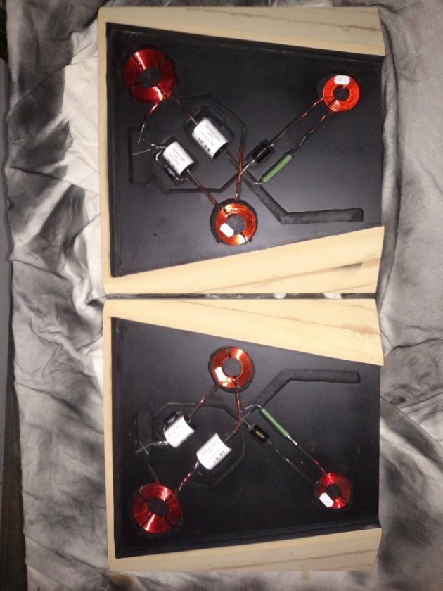

I was thinking about what I was going to do with the crossover, I decided I liked the clean look of the MTM and thought I would hide the crossover in the MTM base.  Because the base is already built I had to do this freehand, not perfect but will get the job done.  Here is a pic for your amusement:
I realize all my inductors are in the same plane, but I didn't have enough height to vertically mount them, so I chose distance.  They are all at least 7" from each other and this actually puts the inductors further apart than if I had added a crossover board in the back of the MTM.
The inner part of the base will be painted black and the components will be hot glued in.
Best,
Ed

That's an interesting way to do it.
Most certainly is. That's what I love about this forum, sharing lots of different ideas and approaches.
I would have never thought about routing space for the network in the base.

I like it I think thats plenty of separation.

That looks real good Ed, and that is plenty of separation.
