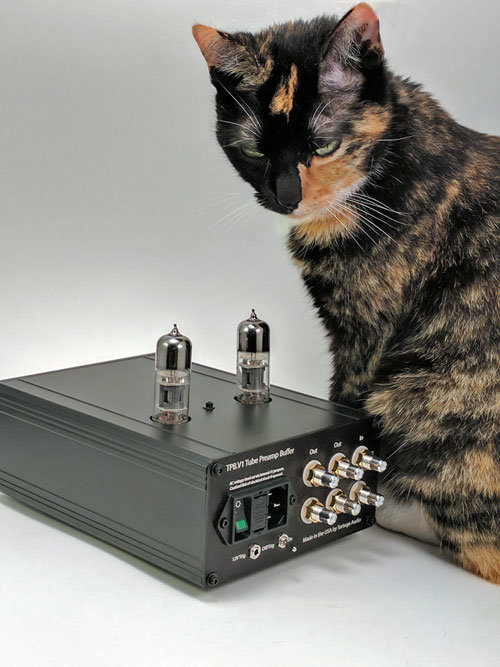

Small preamp buffer.
Amazing sound.
Pretty cat.

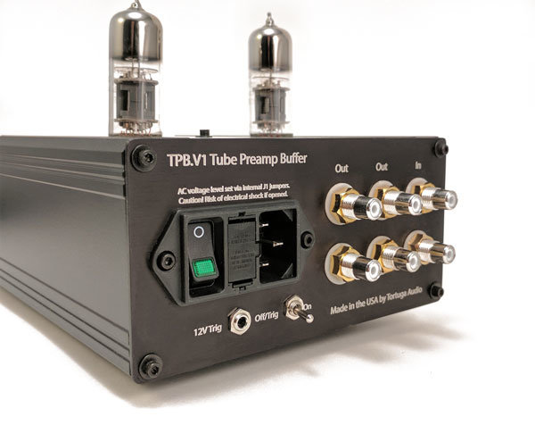

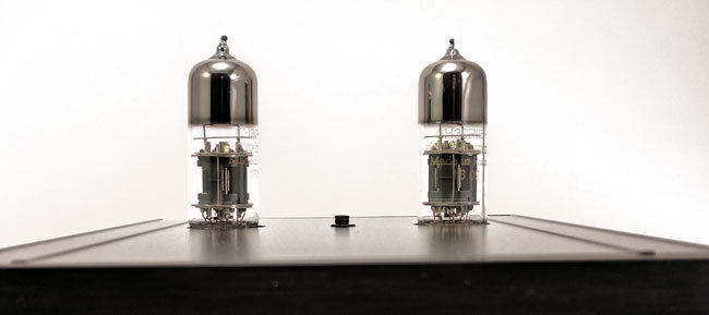

A couple of additional buffer pics.  :thumb:

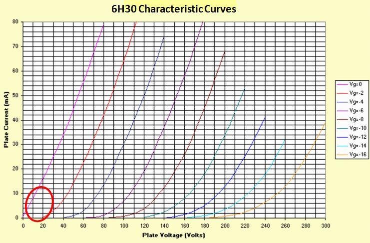

I am interested in how a tube stays linear with such a low plate voltage.
tortugaranger
  • Posts: 1780
    • Tortuga Audio
Re: Hybrid Tube Preamp Buffer
« Reply #74 on: 8 Apr 2018, 04:11 pm »
