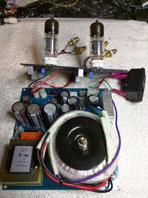

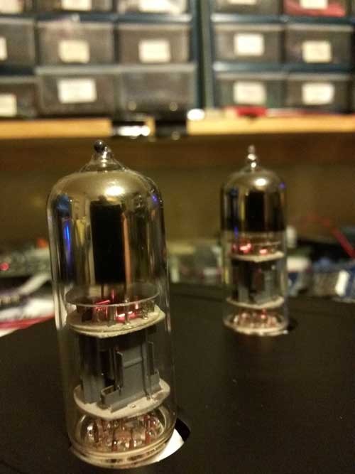

Have the latest prototype boards up and running.  :D Major progress and only a couple of minor setbacks.  :oops: Have to share some the setbacks. This is audio sausage making.
Couldn't help but notice that after initial power up that the plate power transformer was running really hot. Like too hot to touch hot. Very strange give that the current demand is only a handful of milliamps. After chasing numerous dead ends finally realized I'd installed the wrong relay and was completely shorting out the transformer secondary.  We have 2 relays in our parts bins that are same brand, size, color, and pinouts. So of course in my excitement to get the buffer running I managed to pick the wrong one. Space heater - 1 point. Engineer - 0. As a bonus for screwing up the power supply relay the Belleson Superregulator was toast. A quickly assembled LM317 module replaced the Belleson and we were back in business. Now I had hum but only in one channel. Hmmmm. Swapped the tubes and the hum changed channels. Bad tube. Development testing is hard on the hardware.
Despite these setbacks we are 98% done. The last 2% involve some minor rework on the 2 boards to optimize connectors, increase parts clearance between the 2 boards, tighten up the star grounding layout, and just generally dot the i's and cross the t's on the schematics and boards layouts.
Listening to the preamp buffer as I write this. Amazing dynamics. Best audio I've ever heard.
When we're back up and running after the New Year's break, production hardware orders will be placed with the goal of releasing the tube preamp buffer by the end of January. Over the break I'll work on finalizing pricing and set up pre-orders on the website. More on that soon.
The pics below show a close up of the tubes running in a temporary enclosure. The bottom pic is a rough shot of the prototype assembly. Power supply in foreground. Tube board in background laying on its side. Power entry module on the right. Temporary I/O jacks. It's all good!
Morten  :thumb:

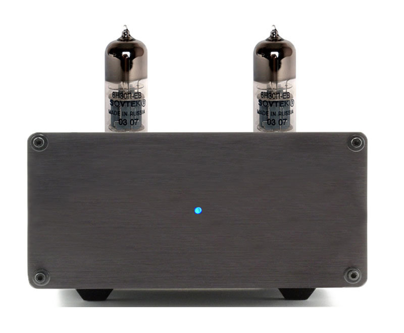

We have officially set the release date for the TPB.V1 Tube Preamp Buffer (the "V1")  for February 15th (this year!!!)
Between now and then we are accepting pre-orders.
More info on the TPB.V1 can be found here: http://www.tortugaaudio.com/products/preamp-buffers/tpb-v1-tube-preamp-buffer/
The linked info is missing a detailed technical specification but that will be available soon and appended.
Good news if you're already a Tortuga Audio customer - 20% discount off the base price during the pre-order period only. Email me ([email protected]) if you're interested and I'll send you a coupon.
I've been listening to the V1 buffer for a few weeks now on two different systems mated with a Tortuga Audio LDR3.V2 passive preamp/attenuator. I couldn't be more pleased with the sound. Full, lush, dynamic and with awesome bottom end. A wall of sound. I'm not a reviewer so I'm running out of clever adjectives and metaphors. It gets my most favorite accolade....it's satisfying!
Last but not least, I want to give a heartfelt shout-out to Trung Tran, Mark Nash and Richard Palmer for their ideas and help with the development of the V1.  You guys are the best!
Morten  :thumb:

No way to keep the tubes inside the box? :cry:
tortugaranger
  • Posts: 1779
    • Tortuga Audio
Re: Hybrid Tube Buffer
« Reply #45 on: 15 Jan 2017, 05:33 pm »
Candidly, it never occurred to me put the tubes inside the enclosure. I could give you all the practical reasons having to do with space constraints, concerns with heat/cooling etc. but those would be secondary to the real reason.
Tubes are one of the few if only audio electronic components that has its own visual aesthetic. Simply put, they're very nice to look at. All those little bits of metal enclosed in a little (or not so little) shiny sealed glass bottle that if you we inside one you'd die from lack of oxygen and your blood would boil like it would in the vacuum of outer space (just before is froze). That's cool stuff that. Then there's "tubes at night" sitting there outside the box all warm and orangey glowly, like a failed attempt at designing a light bulb only to realize your crappy light bulb can reproduce music beautifully - what a great consolation.
Tubes are both anachronistic yet very contemporary. They all but disappeared once transistors showed up but not in guitar amps and not in audio gear. When I was a kid our TV ran entirely on tubes and the father of one of my school mates was the local TV repairman. He'd show up with a large fold-out case filled with all manner of tubes. His job along with typewriter repairmen are long gone. The typewriters also went away. But the tubes didn't.
Most people I know don't care or know squat about audio and are actually quite stunned when I tell them a good deal of audio gear today is made with tubes - on the outside! "Really?", they say. "Oh yeah", I tell them. I'm sure some of them think I'm joking.
The thermionic valve is cool  looking retro kit. They sound great. They make use feel good. Can't have too much of that.
That's why the tubes are on the outside.  :thumb:
