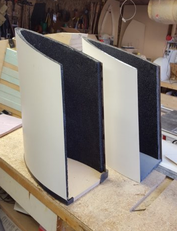

Love the waveguide. Is the woofer transmission line? What frequency range are you looking at? Sensitivity,etc?
Good Luck, looks GREAT so far.
The woofer for this prototype is the new Acoustic Elegance TD8S.  After baffle step compensation, I'd say we're looking at around 86.5dB/2.83V.  Target crossover point with the T-Labs MgO dome will be close to 1000Hz.  The cabinet is large enough to host a 10" woofer, and I've contemplated using the AE TD10S as an option.  That configuration would yield a slightly higher sensitivity of around 88dB/2.83V with sustained SPL well over 112dB, a true studio mastering monitor.  Either version will boast bass into the 30s and highs to just beyond 20KHz.  We could also opt for the 4 Ohm version woofer and gain an additional 3dB of sensitivity.
The inversion layer material has a unique set of properties.  It is incredibly strong but also quite porous.  You can literally pour water through it were it not for the laminate skin.  That porosity creates the ability for the material to swallow up sonic energy far more effectively than a solid wall.  It also makes it very difficult to transmit sound through it via vibration.  The resulting cabinet walls are very inert, for both sonic and environmental concerns.

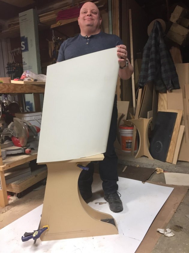

A friend visiting says the pics don't give a sense of size and I need to have an updated pic. So, here it it's guys.

« Reply #67 on: 2 Apr 2017, 01:40 am »
Holy Shnikies!
I must agree with your friend - earlier pics definitely did not give me a realistic sense of size.

Those are Massive!
I remember how amazing the Aurora's were when i heard them at Ryan's. Perfectly balanced, detailed and POWERFUL while at the same time smooth and completely non fatiguing.
Ive got a feeling you've taken the next step with these! Really like the looks.

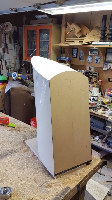

And then there were 2!!! Here's the first pair of prototype together for the first time ever!!!

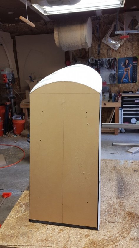

Ok guys... I'm trying to get things done!!! My thumb is "tender", but time waits for no man. Anyway, I don't like how a flat top looks, so I'll try this. Anyone besides me like this?

« Reply #78 on: 16 Jul 2017, 08:46 pm »
That sets it off real good

Ed I liked the flat top but this is even better. Glad you are back at it.
