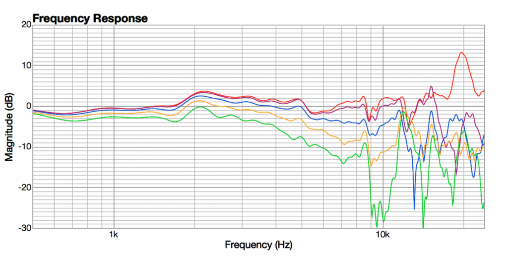

My measurement yesterday of the off-axis was a bit optimistic... not sure if that was the close distance (20cm) or because I hurried too much. Here's a more careful measurement at 50cm, gated at 2.5ms (still some early reflections off the stand), no smoothing - 0, 15, 30, 45, 60 degrees (red, purple, blue, orange, green). (*)
[Edit] I've revise the graphs to only run to 24 kHz.

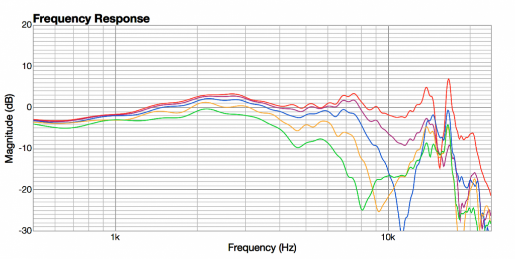

For comparison, a Fountek FR89EX (4 ohm version) in the same box (*):

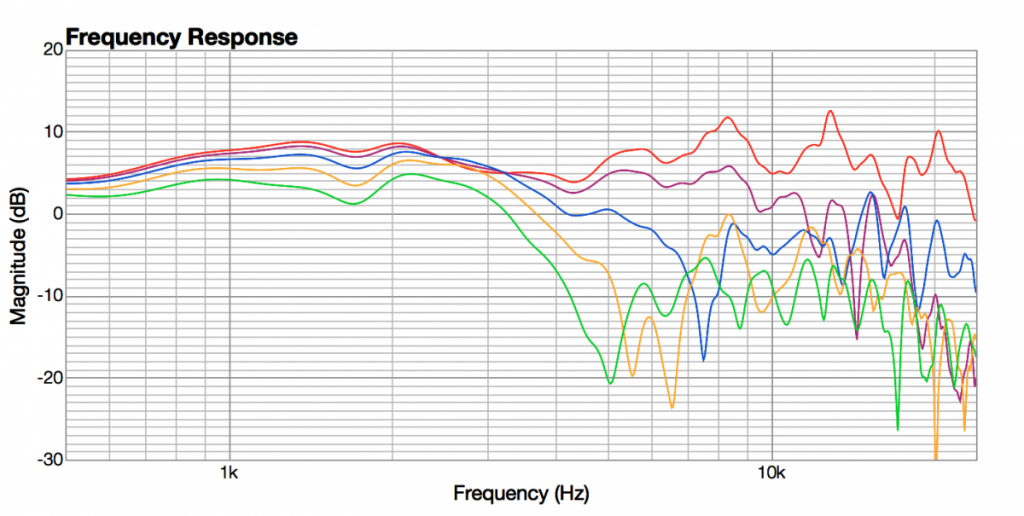

Aurasound NS3 (different box):
For good measure, Jordan JX92s:
(*) It doesn't matter for these measurements but 10F and FR89EX have some BSC (inductor||resistor) in the box.

Fountek EX89 plot certainly illustrates what I am hearing. They, in the Serene Talismans need to be listened to well off axis. Great mid detail and projection on good material however. I think the Scans would be a few orders of magnitude better, and just enough bigger to shift more air.
Really good size driver for mains for a nearfield/midfield FAST set up, in a real world sized room.  Only 14mm greater DIA than the Fountek. 12mm wider cone DIA. Not alot, but still significant, I think.

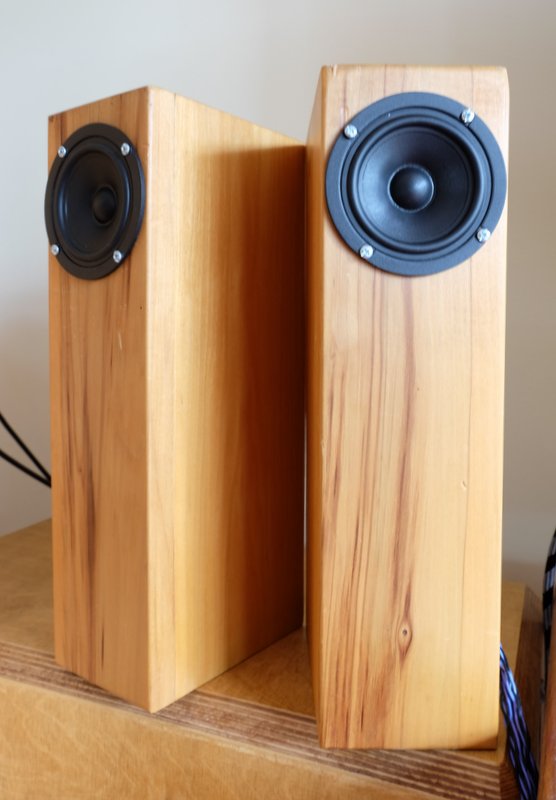

« Reply #14 on: 17 Sep 2016, 04:38 am »
The Popsicles™ live again!
These originally had TB W3-881s in them. I lent them to a friend and she must have used them as party speakers because they came back trashed. Poor little things. The 10Fs fit easily in the hole although the rebate is too small. Good enough for a quick tryout. Good so far!
