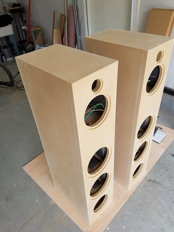

Next I measured the cutouts for the braces and speaker jack plate, and cut these out with a jig saw.  One brace forms a "T" so I glued that together.  All glue joints are done with TiteBond III.
You can also see that I've made the front panel "sandwhiches" ...2 layers of 1/2" to make the 1" front baffle.  The extra thickness plus the glue sandwhich will keep that from resonating or moving...which means that the drivers energy will not be used to vibrate the baffle, just the cones.
Marked off teh location of the braces on the panels, so assembly would be easy.  Assembled the basic box...sides, top and bottom.  Used 18 ga 1 1/4 brads with compressed air nailer along with TiteBond to keep is square and not have it fall apart.

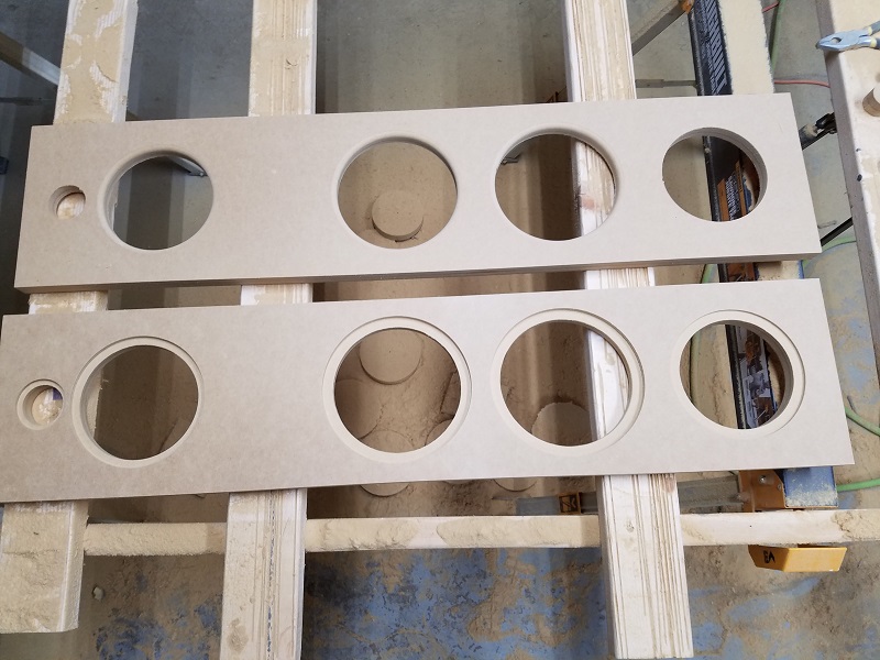

Next is to mark the locations for the drives on the front baffle.  Cool trick here...use a slide square.  The panel is 9" wide, so I set the square for 4 1/2.  Start on one side like in the pic, then the other.  IF both lines are on top of each other, you know you have perfect center...like dividing it with a compass.  I didn't draw a line all the way down, just made a mark where the centers are.
Now we get to routing.  I have a Bosch router with a plunge base.  I got a 1/4" spiral up-cut bit and a Jasper circle jig and got this all set up.  I started on a test piece and did the flange cutout and the hole, and popped the tweeter in to see the fit.  I should have mentioned this before, but I had enough extra MDF that I had a few extra front baffles made, for routing practice and for painting practice.  I clamped the baffles down...you don't want them walking away from you with the router at 15,000 rpm.
The router has depth adjustments by 1/8.  Of course one depth needs to be 3/16, so I used the slide square to check it, and did a good test with that.  My method was for each driver, to rout on the test piece, and if it all was good I would leave the setting on the router and immediately move to the real baffles, so there were no changes made to the router.  I would rout the flanges on both baffles, then route the cutouts, which kept both baffles identical for size/depth.  I figured the more consistent the construction, the more consistent the sound.  You can see the practice baffle behind me, with 3 tweeter holes.
Cleaned up the routes with some 150 grit...
I used a 1/2" roundover bit on the back of the baffle for the midrange and woofers to give them a little more breathing room.  The tweeter and port don't need this.

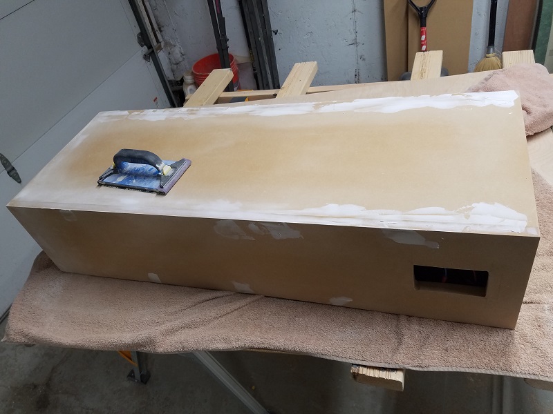

I tried a bunch of methods in terms of sealing the MDF.  First I brushed on a coat of Titebond wood glue thinned with water.  I rubber undiluted glue into the seams and raw edges of the cabinet with a wet rubbver glove to get it to sink in.
I tried some bondo on the edges, but the stuff dried really fast and also was very hard to sand.

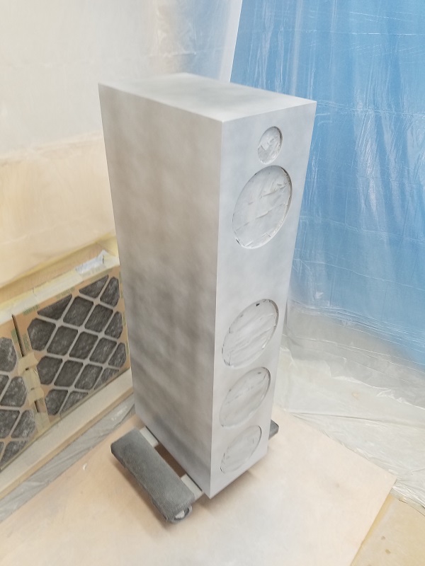

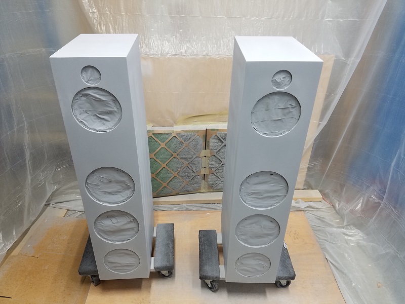

After that and getting them smooth again, I sprayed the primer.  This is a sandable 2k automobile primer.  You can see the portable spray booth.   I screwed on some cheap furniture dollies so I could roll them around without touching them.
Since I haven't build boxes before it's a little trial-and-error in terms of "how smooth is enough?"  for the original seal coats as well as the primer.  As I sanded the boxes down, I used an old trick for filling in low spots...drywall compound.  I've used this on guitars.

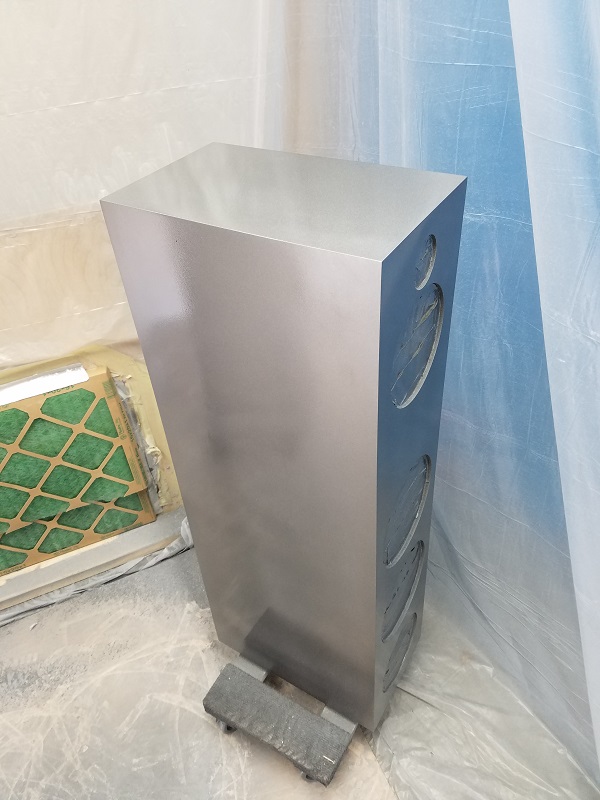

Here is the first coat of metallic silver.  Yes, it looks tiger-striped, which I've never had happen before.  I figured it would level out with the consecutive coats.  I used a Mazda color.
I put on 5 coats of paint, then a whole pile of clear.  Here is the clearing process.
At this point I could tell there were a few seams that telegraphed through, the tiger stripping didn't fully cover, and I also noticed that the paint bounced off the carpet on the furniture dollies and created a rougher texture on the bottom.  I had 2 choices...back to sanding to correct the issues and respray, or wetsand them down and get them up and running.  The overall look we (the boss (my wife) and I) were going for was a metal look to match another piece of furniture in our living room.  We decided to wetsand at this point.  I was running out of good weather to paint - needs to be 65 degrees - and the thought of waiting until spring was too much.

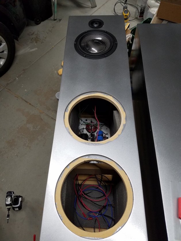

Time for assembly...
This went well, although the tweeters were a little tight and their holes needed some sanding.  Make sure the drivers fit in easily, because if you force them the paint will chip when you pull them out.  Don't ask how I know one of the tweeters was too tight.  You can see in the pic that in this light you can see some striping.  Depending on the angle of the light this is less noticeable.

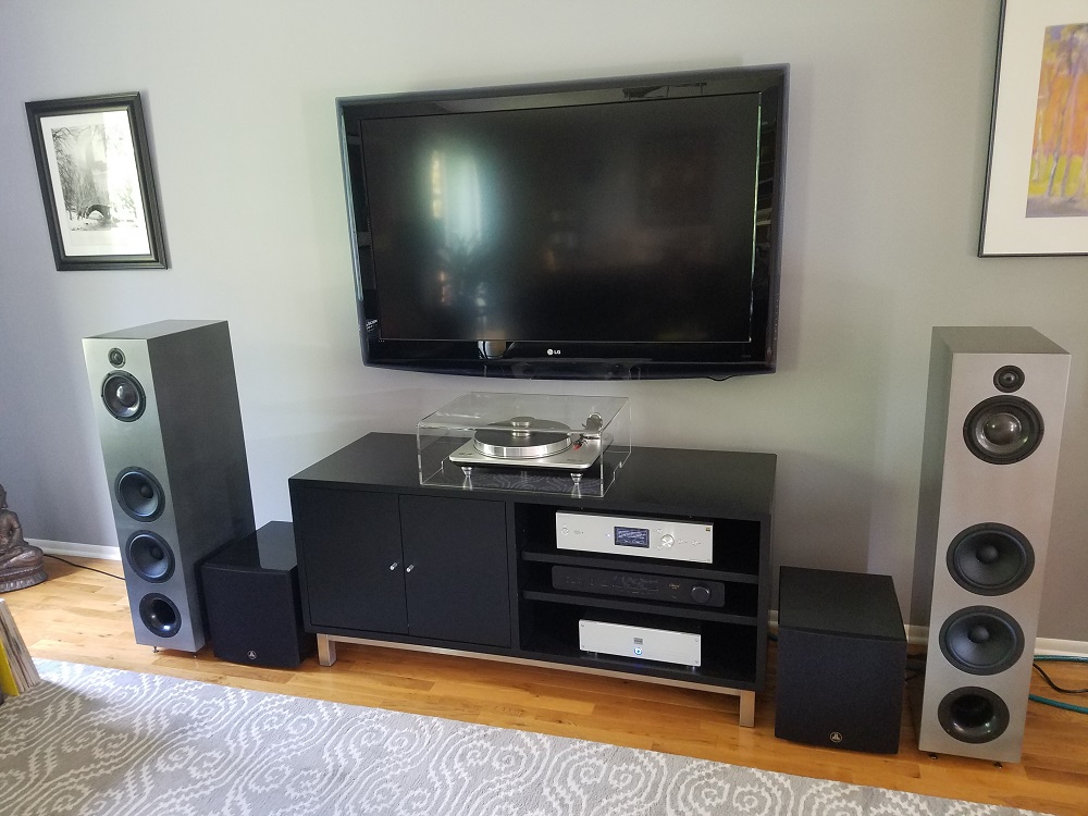

Drumrolll here...we got them upstairs and did one final listen of the Aerial 6s these were going to replace, so we could compare them a little.  Subjective tests aren't the best...but you have to do it.
Overall the finish is such that they match what we wanted them to and they have a slightly industrial look to them.  In the light we have, you don't really notice the issues so much (but I do, being the builder).
The sound....
This project was a risk, and one I (we) were willing to take.  The DIY hope is that if you are willing to do the work, you get four to one or five to one against retail.  That would put these in the $12-$15k neighborhood.
We were not disappointed when we fired them up to say the least. My wife teared up and exclaimed "You did it!".   They sound absolutely amazing.  I had been considering the Aerial 7t, and glad I didn't fork out the $11k for those.  When I spoke to Rick and we discussed what I was looking for, he was quite familiar with both the Aerial house sound and Micheal Kelly, so as we listened and they broke in, we found them to be detailed yet smooth.  The tweeter and midrange combo is fantastic.  I went with the Scan/Morel combo because I'm used to dome tweeters and didn't want to put anything radically new to me in the mix.  They reach lower than our old speakers, so the subs needed to be dialed in.  They aren't really necessary, but after years and years of less punch and kick, this is really fun.  My wife was into the $14k Focals at last years Axpona, and she said she likes these better.  I don't see myself wanting or needing to replace these.
