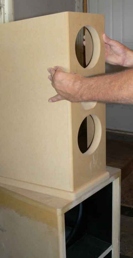

You said the flatpacks are 24-1/2" tall sitting on the 1" base. Where does that put the center of the tweeter?
Mike
Re: New NX-Otica MTM section only
« Reply #30 on: 6 Sep 2016, 02:49 am »
Jay,
Mike

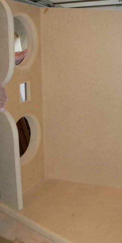

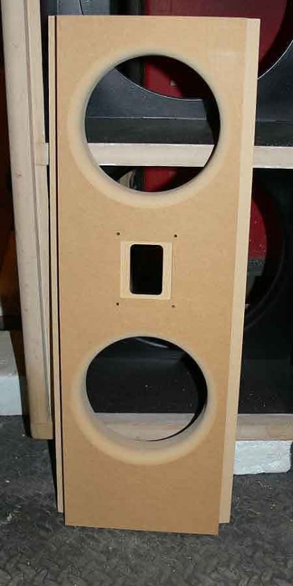

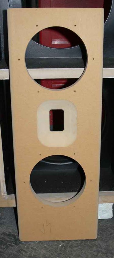

14" from bottom of base, so, if  a person sits these on top of a dual  h-frame, the tweeter will  be very close to the same height as the NX-Ottica.  Remember how good the vertical off  axis performance is ? Witheh NX-Ottica, yo ucan  get up out of achair  and not  notice any  change :thumb:
here's a a couple pics of the cabinet with a trimmed up  top edge on the baffle
A couple of the front and rear sides of the  baffle itself
jay
