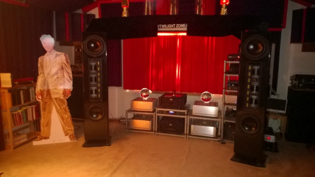

Picture from Avoosl's setup for the install of the dspMusikLCD.

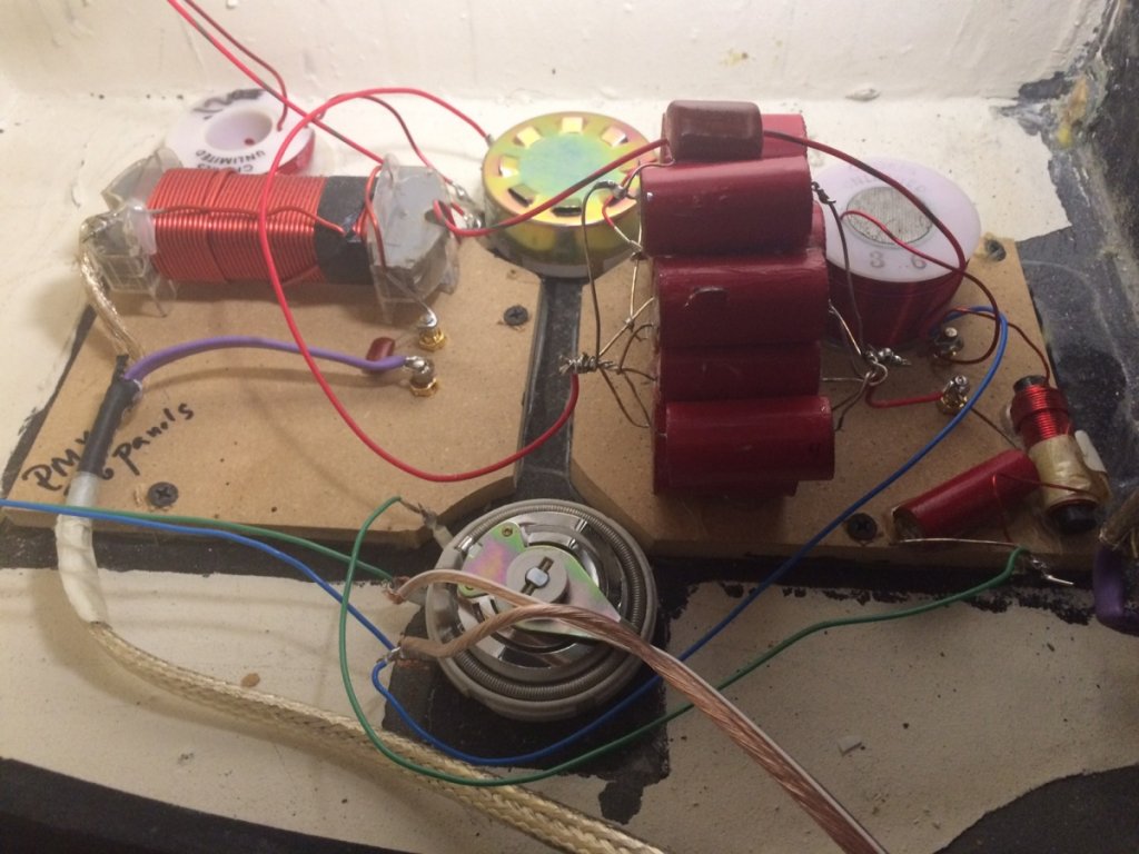

I cannot figure out the problem with the tweeters not working in My VMPS RM/X speakers with passive crossovers. How difficult would it be to convert these to active with  the dspMusik and do you feel I could get an improvement in the sound?

To use the dspMusikLCD with the RM/X, the internal passive crossover would need to be bypassed and driver connections made available on the rear for amp connections.  Since I have not seen the rear setup on the RM/X, not sure how hard that is.  Would most likely need a full triamp setup since it is ribbon tweeter, multiple Neo planar mids and woofers.
If you have a rear picture, that would help to show the existing connections.

They are on their backs but here is a picture of the inside.Ignore the 12 gauge clear jacket copper wire going to the Lpad, that was for testing.
 The green and blue wire go to the tweeter, red wires to the midranges and the big silver wire to the woofers. I would just have to install two additional terminals for amp connections and I am assuming I  would bypass everything including the L pads? Would the order be
Music server>Microrendu>dspMusik>Amps> Speakers. So I would not need my pre-amp or Dac?

Basically that is correct.  However with the ribbon tweeters, they should have a series capacitor for DC and low frequency response protection, unless the amps are DC servo controlled for protection after the digital crossover.
First step would be to measure the existing crossover at the connection of the drivers to the crossover with PocketCLIO that I can send.  After the response data is made, then I can build a digital version of the passive crossover.
The measurements with the PocketCLIO may show why the tweeter system is not working.  Could be a few things going on.  I see a person with RM40's having ribbon problems as well.
The next question is if the microrendu works with ASIO compatible USB DAC's like the dspMusikLCD.  No preamp needed as the dspMusikLCD has a 8 channel DAC volume control with 0.5dB steps over a large adjustement range.  Input selection and volume are all remote controlled.

Have you tested the two L-Pads for correct resistances and operation?  Since both are not working, might be a good place to start.  They are usually a weak point in speaker crossovers.

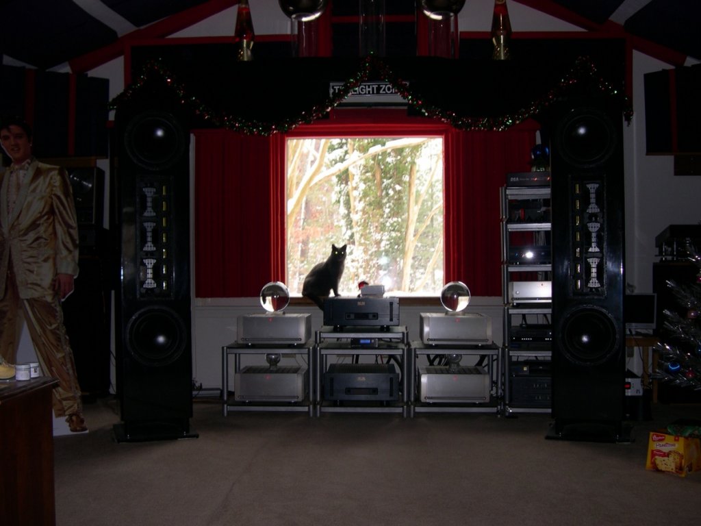

       Hah - here is incidental proof that the delivery by HAL really happened - a picture of the dspMusik box in the
 middle, with the rectangular blue light.  The ligthing is funny because of the bright snow, but I like it.  For you animal
 activists: the cat Yinko is on the inside, not out in the blizzard.
