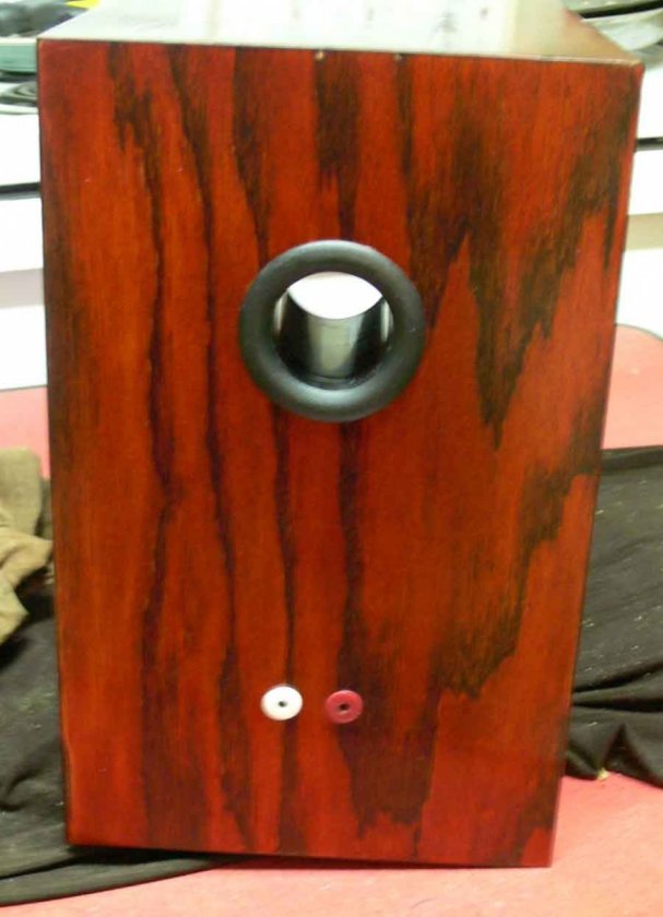

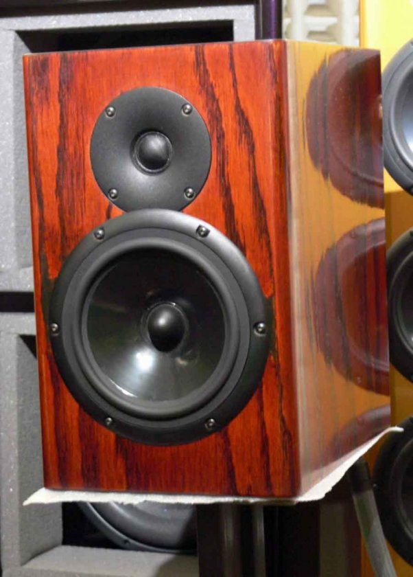

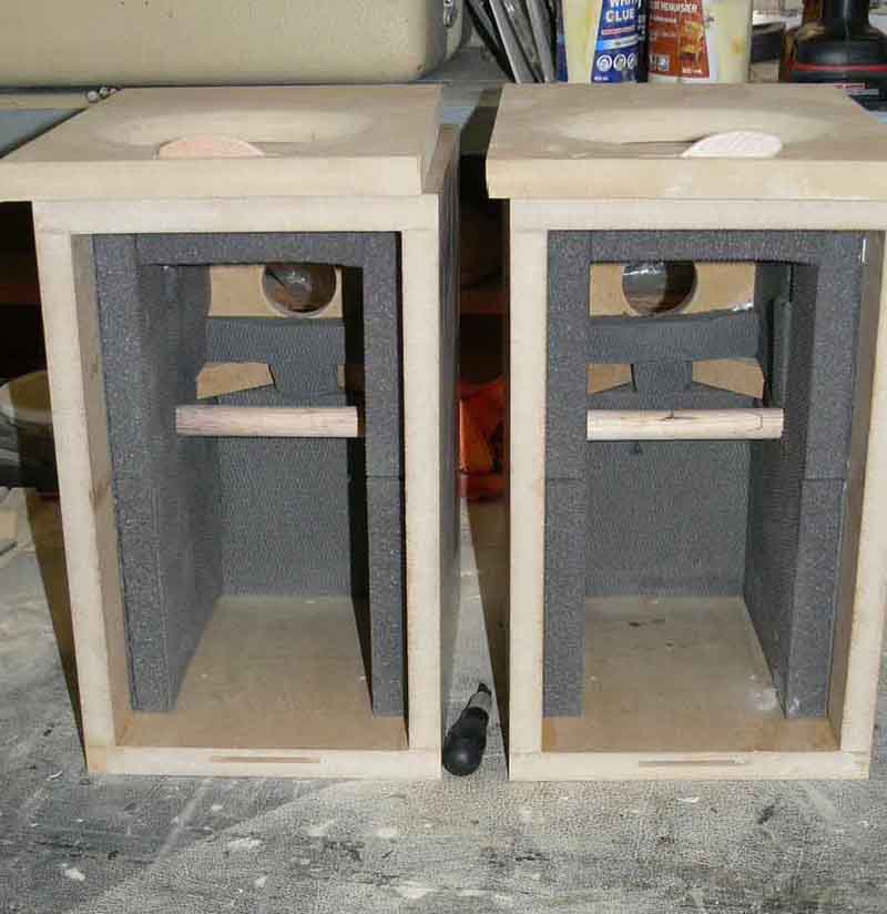

Built this pair of X LS Encores with kind of a dual purpose, 1 they are to be a gift for my nephew and his GF who both just graduated from university and are both music lovers, and 2,  we recently heard a pair of pretty pricey mini monitors in a local audio shop  that I felt compelled to shame with a pair of these so that's what  they'll do before  heading to their  new home :)
Started out as your typical  build, this time I  lined them with no rez before gluing onthe front baffles just to make things a bit easier. I also used a single biscuit  on each panel to  just aid in alignment while clamping  them up.  As you can see in the pic, instead of using the  .75" square cross brace, I  always use a piece of .75" round stock as I've got a bunch lying around, probably no difference but I like to eliminate the sharp edges if possible

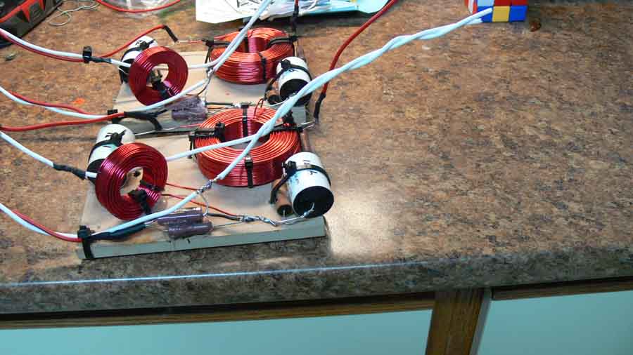

We decided to go ahead and upgrade the networks.  P2P wired, Sonicaps bypssed with a  Jupiter Copper on the high pass, bypassed with a .22uF Sonicap on the  low pass. A Clarity ESA cap was also used on the high pass circut as well.   Mils resistors  and  XO inductors completed the networks. I used a board slightly longer than the PCB , it let me space out the inductors a bit  more

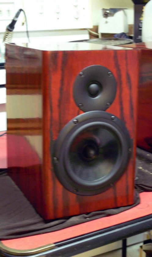

Anyway, after wrapping them  in the veneer, I wanted to do something a bit different. After talking to my nephew and determining that  he and the Mrs  both liked red, I decided to make these  REALLY RED.

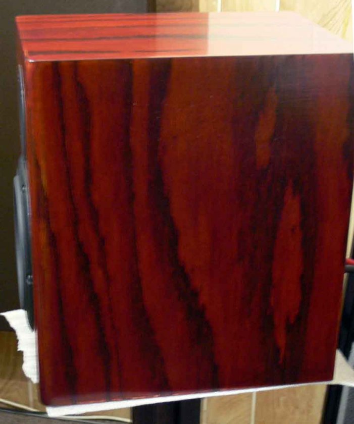

Picked up some dark red Aniline water based dye, mixed it up and  gave the cabinets a sponge bath. Somewhat tricky to try and keep the color uniform on both cabinets and in all areas, kind of a messy process too as the dye tends to get  EVERYWHERE.
After the dye, the cabinets  were kind of dull and had no "pop" so,  out came the Dark Walnut Danish oil,  I used  600 grit paper and  did  4, 1/2 hr soaks lightly sanding with the oil soaked paper and keeping the veneer wet for the duration of each session. Along the way, some problems arose, in a couple places around the woofer cutouts, the light sanding seemed to remove the dye and after it was removed, nothing would  take, seemd the more I tried  , the wore the issue got, I think I was actually into glue coming through from the back side, both speakers were  having the same issue right around the woofer cutouts  :scratch: Mouinted  the drivers  to see how bad things actually were
:cry:
Talked to a woodworker buddy  and he suggested I try using some lacquer based toner to blend the troubled areas into the grain...my artsy niece was the perfect person to tackle this, you'll see the results  in a sec.
After she did her thing, I  proceeded to  apply numerous  coats of wipe on satin poly. After the 4 th coat I started lightly sanding with 800 grit ontinuously doing so after each 2 coats.  As the poly leveled out, I kept moving to finer paper before finally finishing with 2000 grit.
So, in the end, they did come out pretty cool looking imho. If I were doing   the same  finish again, I'd  use more dye and have them end up a bit darker Got lucky with the repairs around the woofer cutouts, my niece did a great job of dealing with those.
Set these up last night to start getting some hours on them and man, they really sound great  :thumb:

Mike,  I actually  considered dooing  just what you have done with the cross brace  on one of my  Encore builds before coming across the  round material which  simplified things considerably.  That round material actually came from some old chairs that were heading for the dump , glad I intercepted them  !

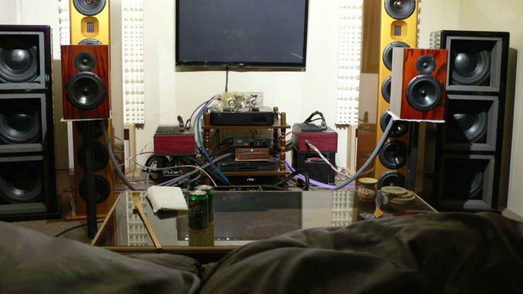

Seeing the picture of your XL-S Encores in front of your main setup reminded me of when I did a temporary test :
As I remarked at the time, I was shocked by how good the 'little' XL-S Encores sound. Mine have no-rez and Electra Tube connectors. Eventually, four of them will be hung from the ceiling to become the .4 of a Dolby Atmos 7.1.4 setup.

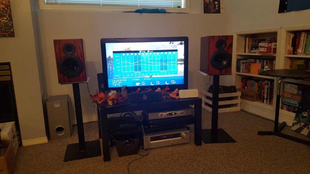

Quick update, got an email from my nephew   this eve
"Attached is a pic of the speakers at my place. Teya and I listened to them for a few hours last night...they sound %ucking amazing."
 8)
